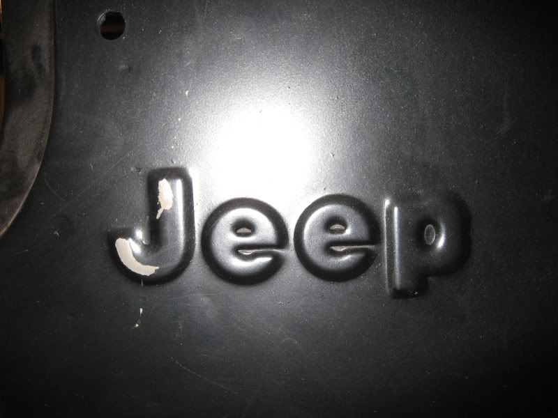

Received my new side panel today. The A pillar is rotted out on mine and some spots along the lower rocker so I decided to replace the whole thing.
I had previously thought that all this stuff were pieces that are ultimately pieced together to form the Repli-Tub from MD Juan in the Phillipines but this is made by the Cobra King company in Taiwan.
One thing I'm not so sure on is the "Jeep" stamping in it. It's in the right place, but the "e's" look a little on the thin side. Not sure how well the replacement decals will fit them. My YJ tub, and the original CJ tub were stamped "Joop" so I can't compare to that.
Here's some pics of it. I'm slightly disappointed there's a little dent in it, but it's not in the creases so I should be able to flatten it back out with hammer and dolly.
I was suprised to see that all the holes are in the B pillar for the seat belt, the edge at the door opening is cut out properly for the striker plate to attach, and all the tabs are welded on to secure the wire loom for the rear harness.
Here's pics of it for anyone who may be questioning buying one or not.

I think it came from the factory that way. It looks like it was tweaked when they welded the pillar to the panel. There's no damage to the outer box or to the cardboard wrap around the panel.
The more I look at the panel though I'm second guessing myself.
Here's a close up picture of the "Jeep" on this new panel
And here's a close up picture of the "Jeep" on Keith460's MD Juan Repli-Tub
It looks to me that the stamping on his tub is correct for the '76-mid '84 CJ-7 tub and matches the mid-84 and older tubs exactly. At that point it was changed to "Joop" but the dimensions remained the same, only the center of the e's and p were stamped flat instead of indented.
I purchased the panel thru 4 Wheel Parts Wholesalers as they offered free shipping. This was drop shipped from Omix.
I'm going to trace out the "Jeep" decals on my tub and see if fits properly over the stamping. If they don't then it's going back. Also if it doesn't then I'm going to try and contact Chrysler as they're the ones that put their stamp of approval on the panel as an "Authentic Restoration Product."

post #7 of 27 Old 06-19-2012, 11:03 AM
sanddrag
1984 CJ7
Location: CA
Posts: 507
Yikes, that looks really dented. I'd request another.

If it weren't dented and the "Jeep" logo were correct I'd keep it and install it. Really, the "Jeep" logo is what upset me most about the panel. This is a licensed restoration product and it's not even the right font!

In reality, it's not the spot welds that hold the seat belt housing. If you notice how it's constructed, as was the OEM panel, the large nut is welded onto an oval plate. That plate is in turn tacked to the B pillar with two small spot welds. None of these welds hold the seat belt to anything. When you put the bolt thru the B pillar it then passes thru the oval washer which is pretty stout stuff, then into the nut. The welds only serve to hold the washer and nut in place for tightening. Once tight the nut is clamping the oval washer to the B pillar which is clamped to the seat belt retractor housing. If the side panel and B pillar are properly attached to the floor boards then it has just as much integrity as the OEM panel.
If anyone intends to replace their entire side panels I would suggest buying the unstamped versions and if you wish then cut out your "Jeep" or "Joop" stampings and weld them into the new panel. Otherwise I feel the construction of the panel is comparable to an OEM panel based on my observations, other than the dent in it that could happen no matter who manufatured it. The only flaws I can find are the dents and the incorrect "Jeep" script. 4wd Hardware has notified Omix of this and also sent my pictures. Unlikely they will do anything about it but it doesn't hurt to try.
