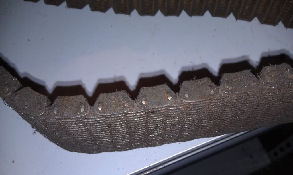

About 6-7 years ago, a fella stopped in front of my house and gave me a Qtrac chain.. said it was brand new and never installed. He said that he drove past my house almost daily and since there were always Jeeps out front, he thought maybe I knew someone who could use it. I told him all my buddies had either D300s or NP231s, but I took the chain and hung it on a hook in the garage.
Fast forward to 3 minutes ago.. the chain is still hanging were I left it. Looks like it was coated in cosmoline or some other "waxy" preservative. It's caked in crud (dust/dirt) from sitting for 6yrs, but doesn't look any worse for wear. I didn't take a really close look (already took a shower), but I can check it better tomorrow..
If you want it, it's yours for the price of shipping. I can probably get it in a Medium Flat Rate Box for $10.. just let me know.
If it has Morse stamped on it, I'll take it. Due to the age, it probably does. They probably were the only ones to make them back then.
It should have 48 links, the 16% OD only has 46 links.
Can I send Beer through the mail????? This just makes my week.

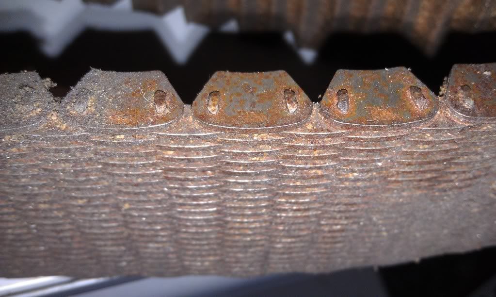

BESRK
GROUND POUNDER
BESRK's Avatar
1980 CJ5
Join Date: Nov 2002
Location: Newport News, VA
Posts: 12,283
Ok... just checked.. it's stamped with MORSE and has 48 Links.
Has some spots of surface rust but I think it'll clean up okay..
