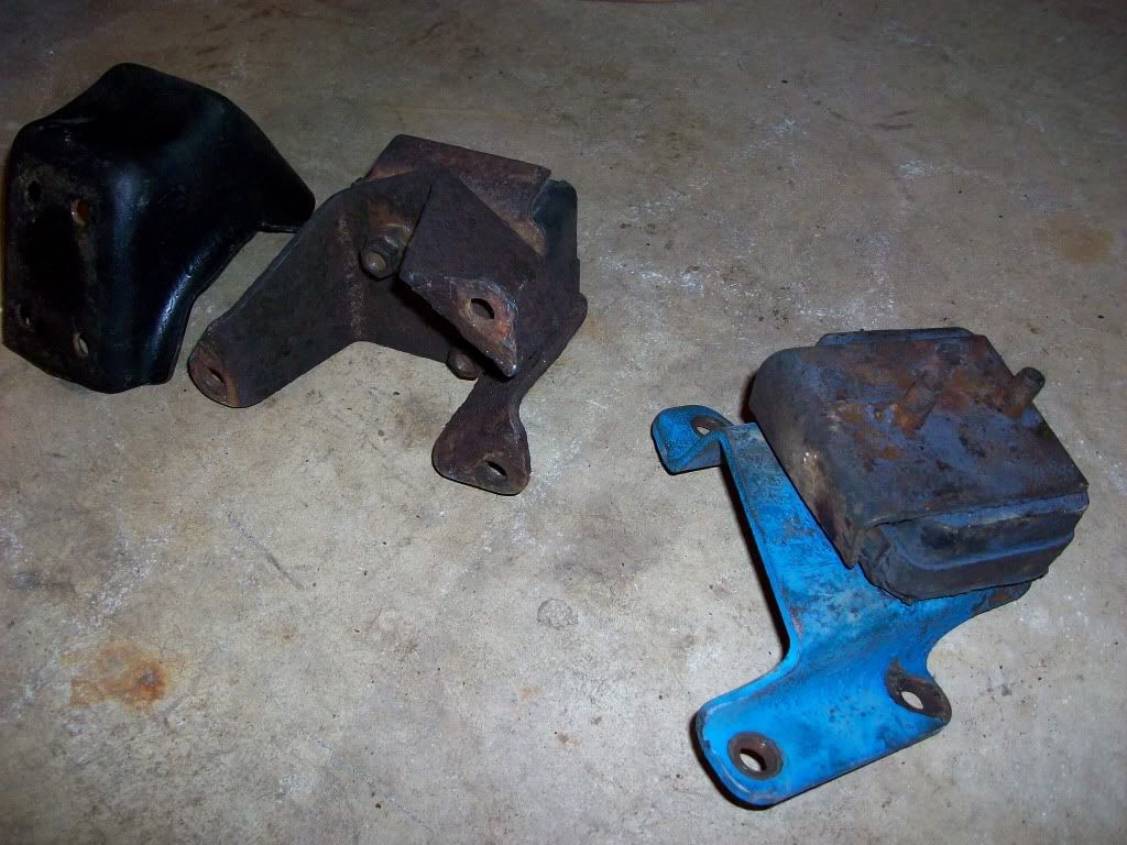

The part that bolts to the motor when used in a CJ looks like this..
These are off a Wagoneer..

Matt was correct. I had the torque arm bolted to the transmission wrong. Now I got another problem.
The skid plate is a fraction of an inch off from the mounting holes.

1/32" or 31/22"? Loosen the bolts that hold the tranny mount to the skid plate, and, the engine mount to frame bolts if needed. Use a large #3 Phillips screwdriver or a spud/punch to move things around.

Yep, as Bill said, use a Philips to pry the skid plate around. Stick it in a bolt hole and pry the skid while starting a bolt in another hole. Once you get one started on each side, the rest should go pretty easily.

It's like an 1/8 of an inch off. I didn't know if forcing the skid plate to mount in there would cause any drive line issues.
