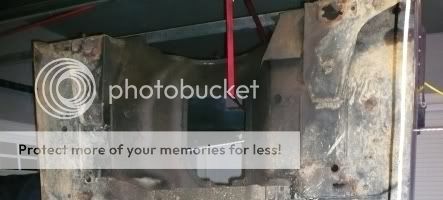

I must not have been clear on what I needed. I already have the replacement poly bushings and a 2" bodylift with all the hardware, thats not the issue. If you look on the underside of my tub, the 2 front holes that usually have a nut welded inside them, look as if someone took a hammer and smashed the mount in. I have attached a picture although its hard to see...look in the upper left hand corner of the tub.
What do I need to do to make these working mounts?

If you look at the upper right hand side of your pic, there is a section of the tub that you can slide you hand into. Its on the underside of the floor. There should be a nut captured in there somehow, but I doubt it on your since that hole where the body bushing would rest is huge. You can make that part where the hole is solid with sheet metal. Drill out for a bolt from the bottom after the body is lined up on the frame. Then in the space between the floor and the mount just use a large washer and a nut and bolt for the body mount.

Ahhh, I see. So I guess I could always just tell my buddy to weld a new piece over the existing hole and not worry about the mount for now and when I go to reasseble everything I could drill the hole in the right location and simply slip a new nut inside since I will be able to access the backside without any problem?

Classic Enterpise has those. They're called front body supports or toe supports. If you patch your existing ones, the panel is stamped with a boss for the body mount to rest on. You'll have to get this area close to the right height.

Here's what it looked like before it was hacked up.
Inside the way the "nut" is mounted. It slides around inside to allow for lining up the bolt.
The part is "A" under the 76 to 95 CJ parts on the Classic site http://www.classicent.com/jeep.php
