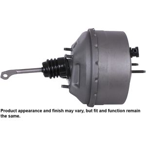

If I use the 1995 then the bracket would not be used and the bolts seen in the pic would go into the fire wall correct. The push rod would not have to be changed since the booster is fitted directly on the fire wall, correct?
No, you'll need the firewall bracket shown in the write-ups that goes between the booster and firewall. The rod would go way past the pedal if the booster went right to the firewall. The bracket is not part of and not included with the booster, which is why that Autozone image does not show it. This presents a problem sometimes, as the YJ power brake setup is kind of useless without the bracket, yet a lot of people who are building nice rigs want to buy the booster and MC new, but can't get a new bracket.

Thanks, Just looking @ the write up the booster does look smaller like a single one. Using the bracket would make one think it would be 1/2 way to the front of the Jeep . I wonder how much Jeep sells'em for if they do, bracket that is.
The two boosters do look different.

looking @ the rod in the last pic it does look like the bracket would be needed to take up the length. Side by side pics helped. Thanks.
