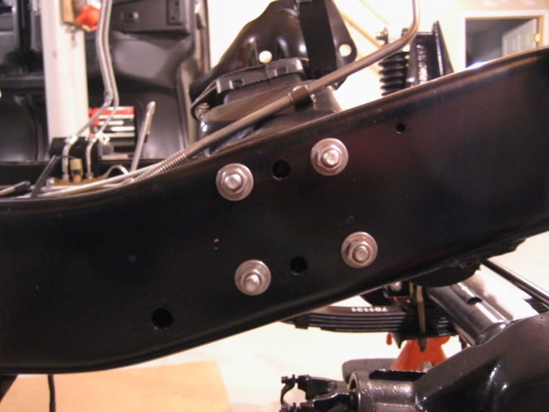

thanks allot gents for the input, does any one know which 4 of the 6 holes the little engine bracket mount goes into I added a picture of the drivers side if it helps, and thanks again

The holes you chose are determined what type of engine, trans combo you have. 1983 factory choice on engines was either 258 six or 150 four cylinder. Trans would be T4, T5, T176 and Automatic.
Here's pic of my CJ's mounting location based on 258 engine and T5 trans.
Drivers side
Passenger side

thanks that really helped, I will get that on tomm and hope to get this thing back on track.
