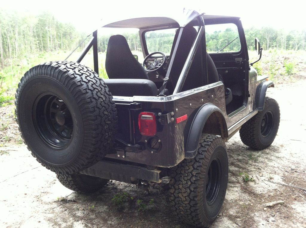

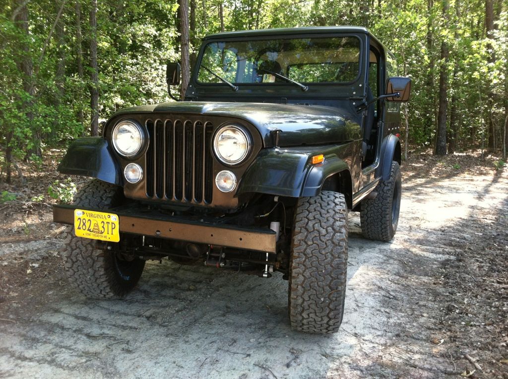

I don't know how much this will help, but I have a 77 with the narrow track axles. It has a 4 inch lift, 1 inch body lift, and my wheels have 2.5 backspacing. The tires are BFG AT 33x12.5. I don't have any issues with rubbing. I went the low backspacing to help with stability on the road. I felt a noticeable difference in the handling immediately.
Here's a pic.

are your rear wheels flush with the flare? or even poke out a tad?
do you have any dead-on front/back shots to show it?

The tread is just under the flare. The side of the tires pokes out just a little. I don't have any pics from directly behind but this will give you an idea what it looks like.
Perfect thanks. have you had the suspension fully compressed yet, how is the clearance out back?
