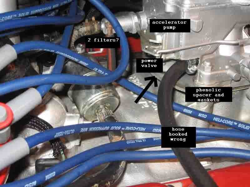

Can someone tell me what the part just below the power valve in this picture is called and/or a part number and possibly a source for it ? I cracked mine and I'd like to find it online so I can order it with my next parts order. It's the plastic spacer between the thin gasket directly on the intake and the really thick gasket under the carb.
Can someone tell me what the part just above the power valve in this picture is called and/or a part number and possibly a source for it ? I cracked mine and I'd like to find it online so I can order it with my next parts order. It's the plastic spacer between the thin gasket directly on the intake and the really thick gasket under the carb.
I think he means the accelerator pump (with the lever attached) because it's above the power valve (under the front where the hose is attached) Sold one yesterday, but since I have a sinus headache, I can't recall the part number. There are square ones and rectangular ones!

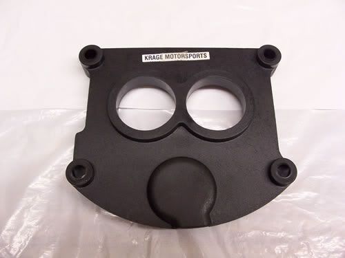

that picture looks familiar,:laugh: yea that hose that is labeled wrong has since been removed and the fuel filter updated. i plugged the tit where the hose was coming out so it should be good. i rebuilt my carb this weekend and got the parts from the kit. all but the gasket that fits against the intake. so here is what i did. thin gasket against intake, then the thick black piece from the kit, then the spacer and then the carb, what piece are you looking for maybe i can get the part number for you.
yea mine was broken where one of the bolts screws down. i actually put it back on that way cause where it was broken was about where the bolt went thru. i still used it for the spacer i hope it holds together.:thumbsup:
Thanks JayHawk, I've been looking for a good source!
