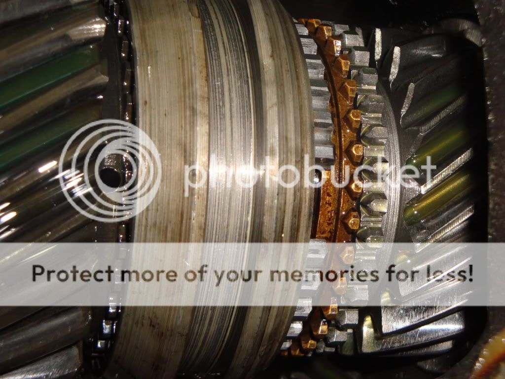

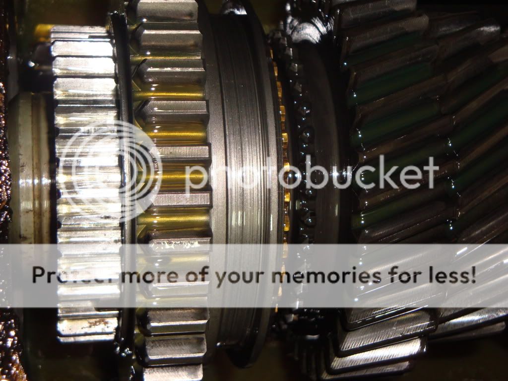

I was having trouble in First gear the clutch would just continue to slip. It wouldn't lock in. Throw it into second and no problems. I thought first gear must have been bad so I pulled the cover plate to check it out. Does anyone see anything, in these pics, that looks wrong or that needs attention? Thanks.

I'm no expert, it looks good.

It looks fine, but what about the shift forks? Are they worn?
