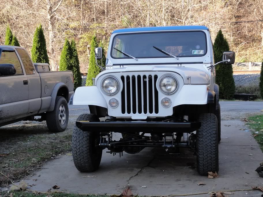

Here is a picture of how the jeep sits right now. 235 tires.
Scratching my head over that picture. Definitely looks taller in person.

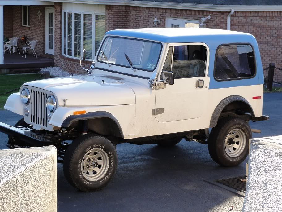

I ended up following though with everything I stated except for running 35s now and degree shims. I could run them (I remeasured and checked my cad drawings and I was dead on the top of tire to fender flare measurement ), but my neighbor gave me a killer deal on 2 new 235s. So I decided I'd just replace my over worn, no tread tires on the rear with those. I do think that those tires are a little small for the size lift I have, but I don't think it looks too ridiculous. I can deal with it till Spring.

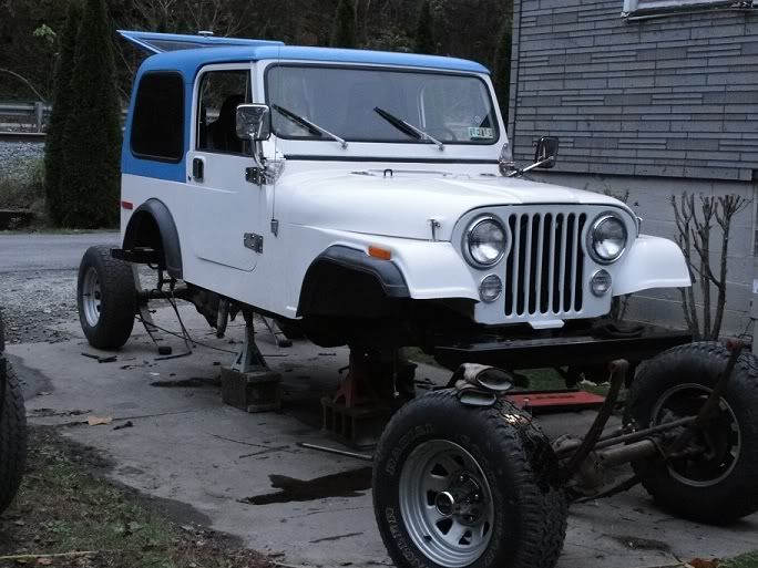

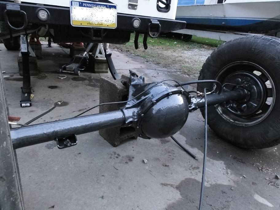

Pulled both axles. Why? Because I thought it would be easier to get them painted off the jeep than on. I'm pretty darn sure I was wrong considering I brushed on the paint. Just wanted to pretty things up.
Didn't go too crazy on prep work. Pressure washed 3000psi, hit the loose stuff with a wire wheel, and degreased it. Coating system is one coat of rustoleum rusty metal primer and a thick layer of hammered black. I did three stitch welds tube to housing with the arc welder.

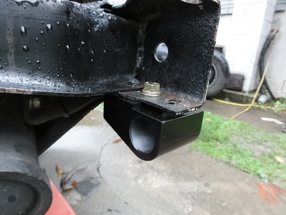

Thumbs up to Jim on the shackle hangers! Only downside is I now can't tie my bumper into the bottom side of the frame. (yes I know I didn't get the inside too well with the rattle can.)

Looks like things went well for you so far. You're gonna have plenty of room for bigger tires from the looks of it. Good job and getting it back on the road.
You know Woody you could weld a tab on the inside of your bumper and use the new hanger bolt to attach the bottom of the bumper. It would just be on the opposite side of the frame and bumper as it was before. Let me know if you want some tabs made up and I'll make a couple for you and send them your way.
(Crabtree Shackle Hangers)
