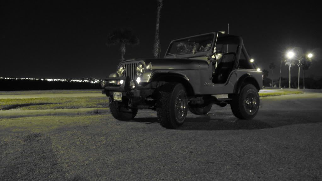

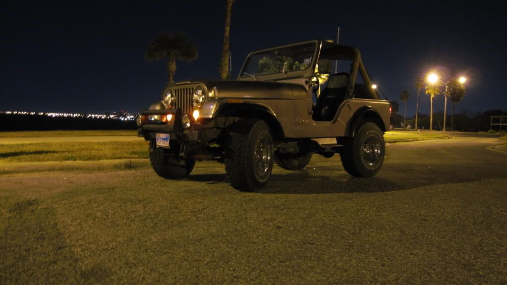

Took a couple cool pics last night (at least I think so)!
