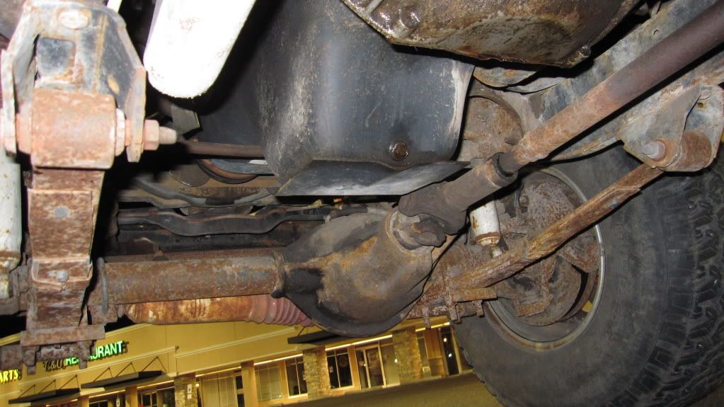

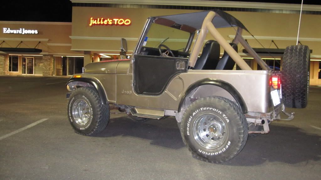

Wow thats one nice 5 you got there. The only thing I really see in the pics are the home made lift shackles. Does it run down the road strait? If it seems a little wobbley maybe change em. Really nice jeep man.

I like it, get rid of those long shackles though. Really nice 5 though.

I say if it runs and you are happy with the deal you got, then way to go. Not a bad looking Jeep at all.

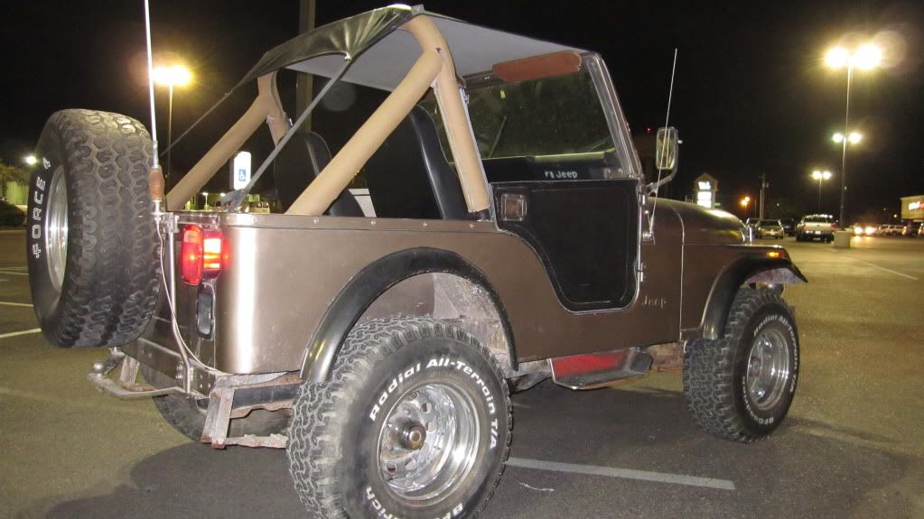

Is that color some sort of gunmetal? I'd love to see a pic of it in the sunlight....looks great at night!!

Here's a couple daytime pics of the ol girl. The PO is calling the color pewter, I'm not sure what its called but I like it (still need to rattle can under the hood).

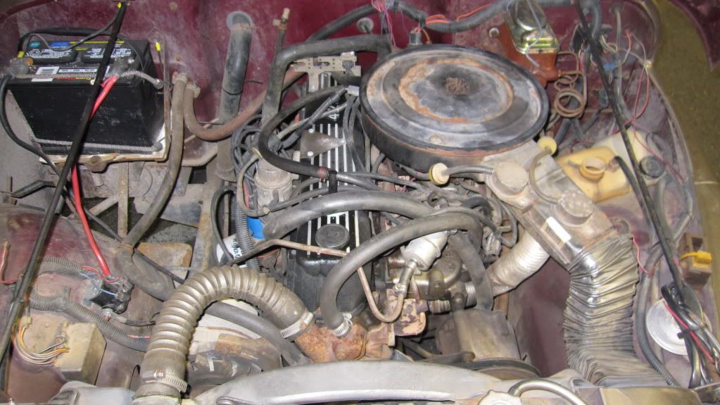

Wow, looks a lot like my 82! I had to go take a peek in the garage to make sure mine was still there! Welcome to the family!
Your transmission should be a t-176 and your transfer case should be a Dana 300. Take your VIN # and go to CJOffroad.com - For CJ Owners by CJ Owners! and use their handy VIN Decoder, that will atleast let you know what your CJ had when she left Toledo.
Some upgrades I have done to mine that were a night and date difference - Research here at JeepForum the TeamRush Upgrade. Using off the shelf tuneup parts in the upgrade you can really wake up the 258. 100s of debates on here regarding the stock carb (Carter BBD), whether to rebuild or replace. There are lots of good articles on how to clean the BBD to get it running right, but ultimately I pulled an old MC2100 from the junkyard and ran with that. If i had it to do all over again, I would have done both of those right off the bat, and my Carter was in great shape. MC2100 also removes a few miles of vacuum hoses, just make sure you dont need to stay stock to pass local emissions. Then there is all that smog crap they saddled on our CJs.....
Also to a search on engine grounds. Guy on here named JeepHammer has written a really good write up on how to properly ground you engine.
Power Steering upgrade is easy as well, and really nice!
