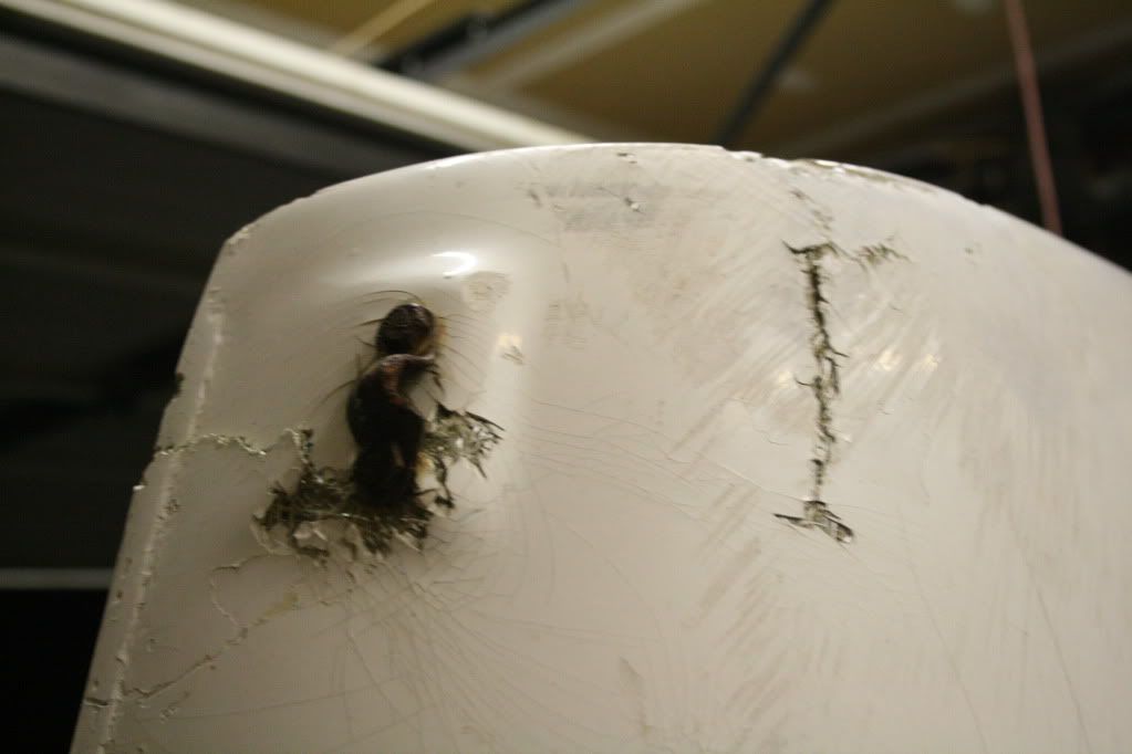

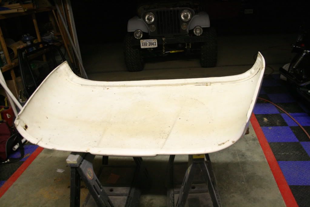

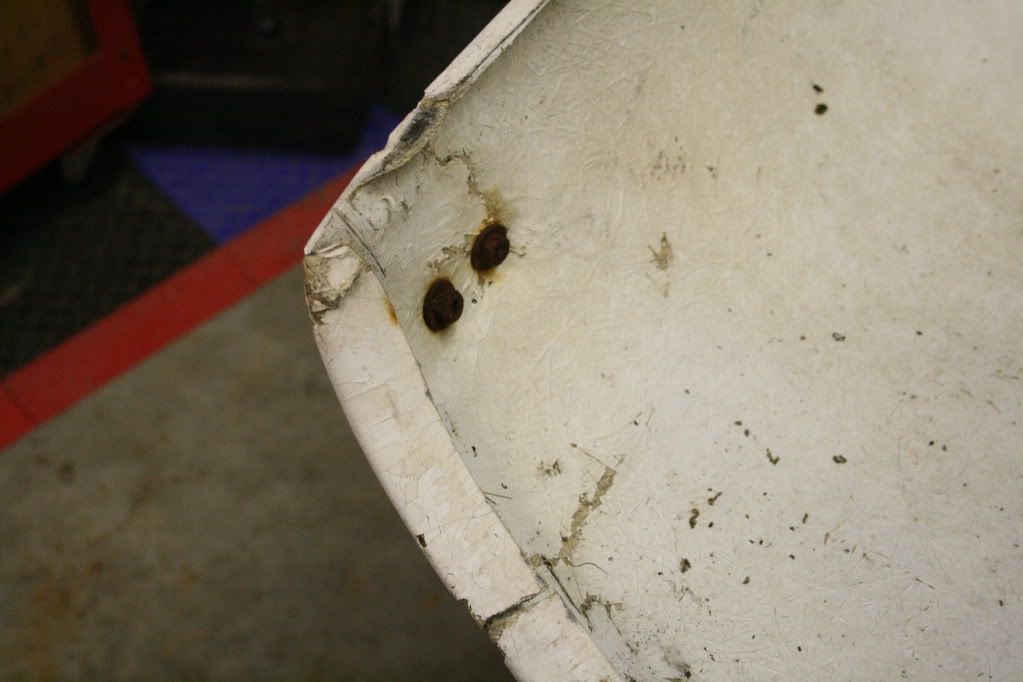

here is the hood I startted with. The cracking is just the gelcoat.

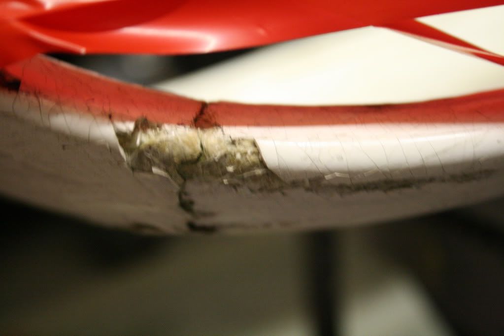

Here is a closeup of the crack. Its in 2 places
here it is from the top

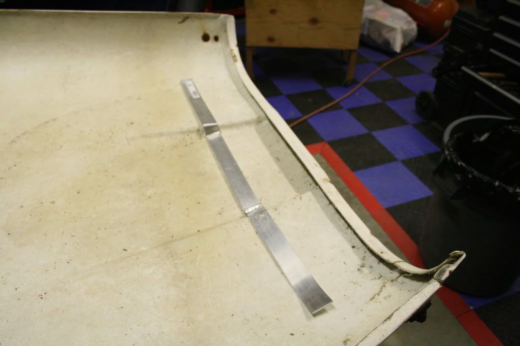

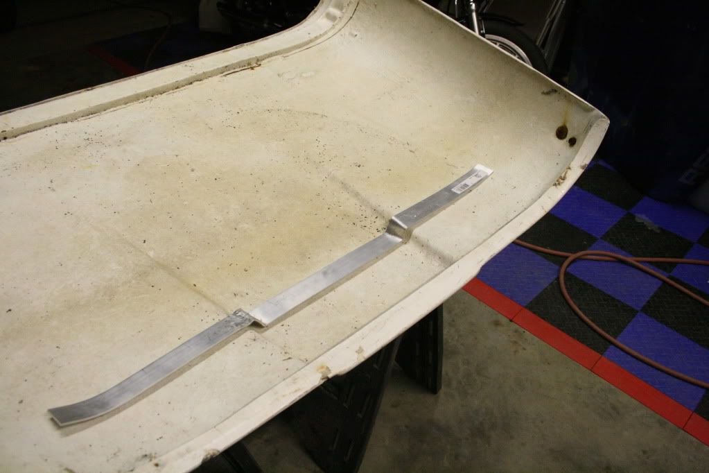

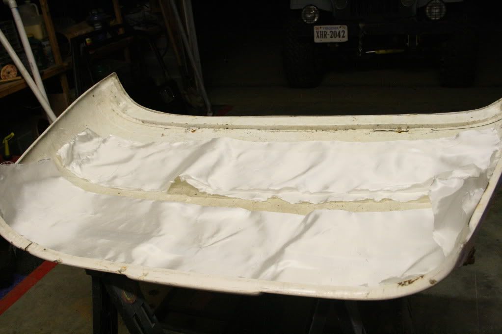

One thing I notice right off the bat from handling the fiberglass hood is its light, pro, and flimsy, con. I wanted to preserve the nicer light weight but I wanted to strengthen it. So I looked around the shop with my thinking cap on. I came across a 1.25" wide piece of 36" long aluminum .125" thick. I then bent it in the bench vise to follow the contours of the hood, it fits fairly good.

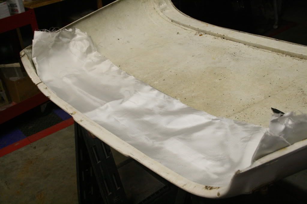

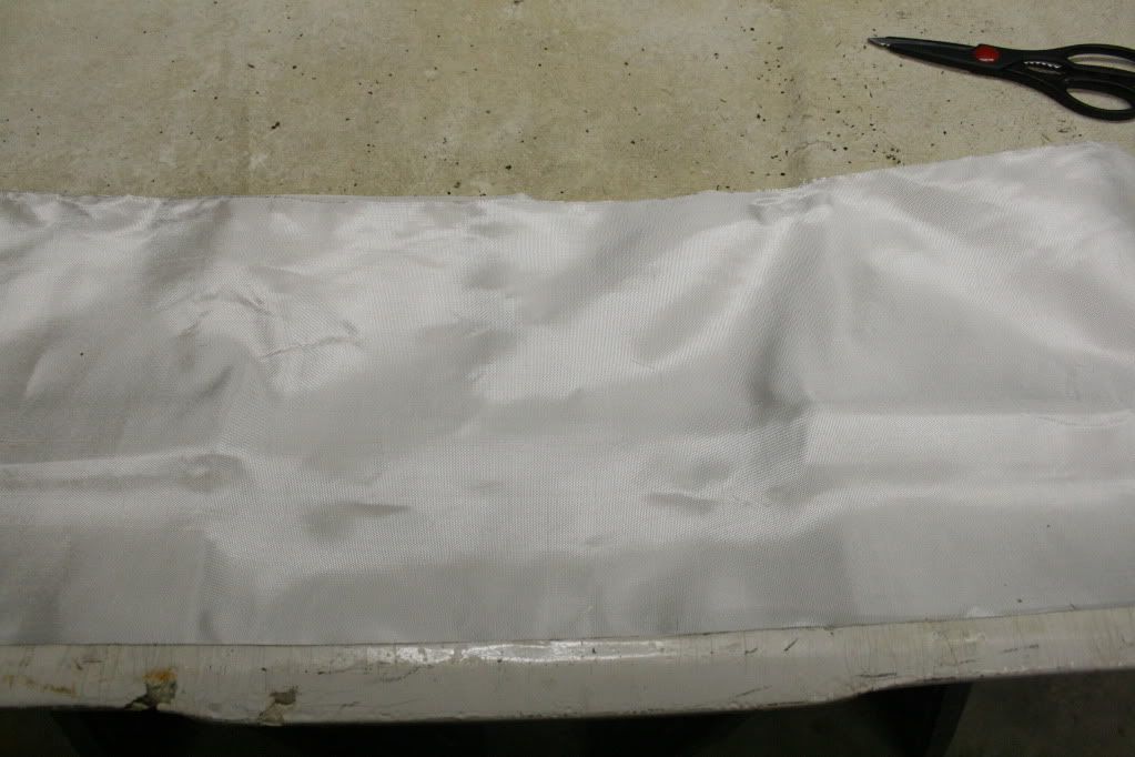

I then grabbed some of our 6oz glass and measured it. I put down 3 layers of glass to make sure and strengthen that area.
the support bar barely shows through
The glass is liad out and ready to start.
here is the crack at the corner. I took duct tape and pulled the corner taught to bring the 2 halves together. It worked quite well.

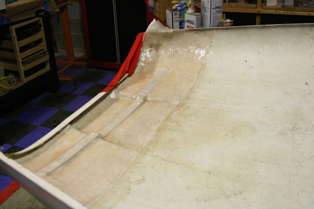

After 3 layers of glass here is what it looked like. Its got a few bubbles but not to bad. Im going to go back with some epoxy and filler and I want to blend it into the hood and make it just as smooth as that top.
:laugh: I used to (still do) build large high powered rockets with fiberglass. I knew these tecniques would come in handy. Imstill not very good at it but I try. Mynext big challenge it to get a latch on here and light. I still want the hood latch along with the sring loaded holders and I think a light will come in handy.

Good idea on the aluminum strip to reinforce the hood! For filler I would look at Evercoats Everglass, or Duraglass which can be bought locally. Basically just short strand fiberglass reinforced filler. Works very good and is very strong! I keep telling Scott (Skerr) about it but I don't think he has tried it out yet.
im not sure what I want to do. I thought about ordering some fiberglass strand mat that can be used with epoxy resin instead of polyester. Put a whole sheet on the underside of the hood to thicken it/reinforce and to have something to smooth out. we shall see. I just dont like the look of the strand mat underside of the hood. I need to atleast get it semi-smooth and painted.
