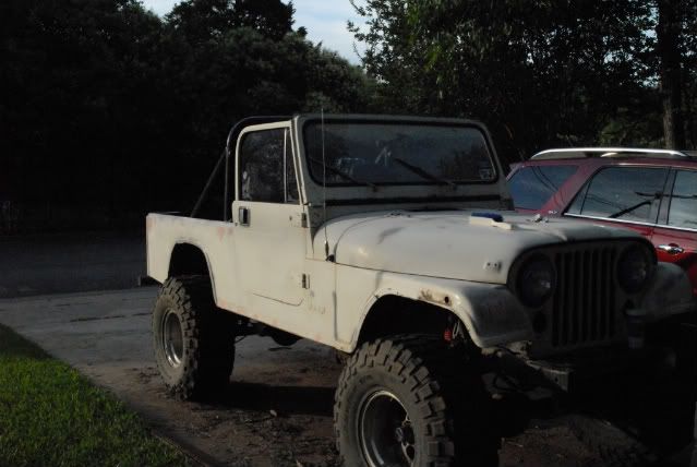

I went with the Rustolum “rust top” product. I cut the first coat 1:1 with spirits, I will do pant to spirits ratio of 2:1, first blend was a torch thin, and hard to work with (as is any red paint if you did not know) my first coat used 10 oz of paint, assume it will be 16 OZ going forward

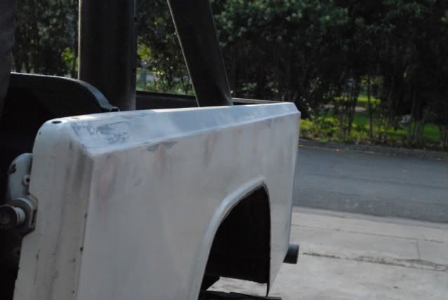

Sanded down with 200 dry paper, as I had a lot of work to do,
Filled all the holes from accessories not used ( soft top, OEM slider, OEM tier carrier ect). In all I filled 77 holes. It was my first bondo work, and I am not unhappy.
Applied paint with little 4” foam roller.

You bondo-ed the holes? Not welded? I guess since you're doing this on the cheap that will get you by for a while, but the bondo WILL crack and fall out sooner or later.
yep, keeping it cheap. I also had 77 of them... most were pea sized. i figure i'll do a fram off and fix all that in 5-7 years.

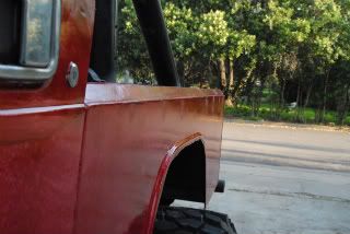

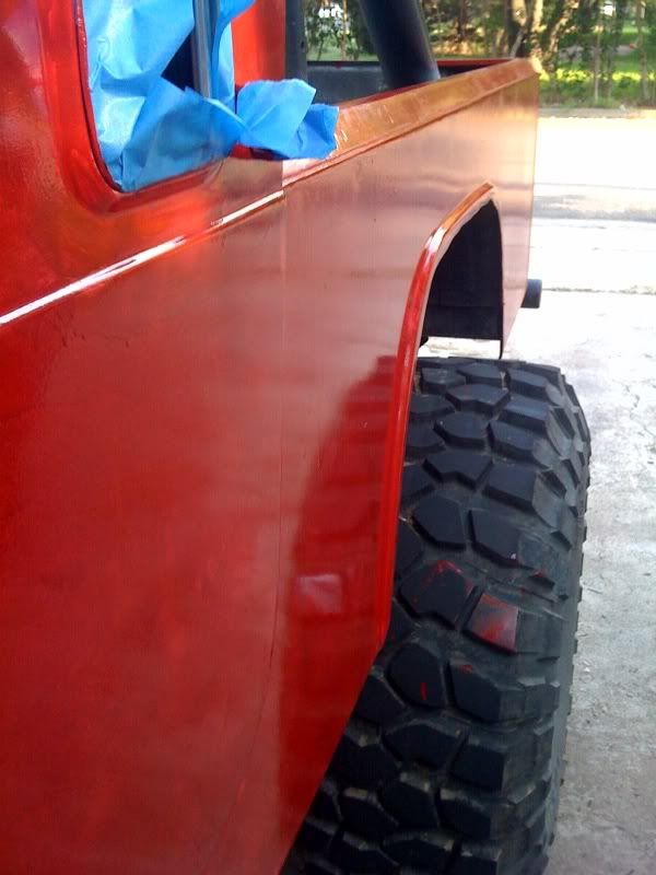

after second coat. I won't post every pic, but I wanted to compare the difference with the before and after wet sand. I'll do that tonight.
second coat: (not yet sanded)
can you can see where my 3 yr old was "helping"
