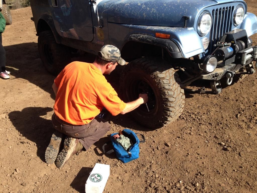

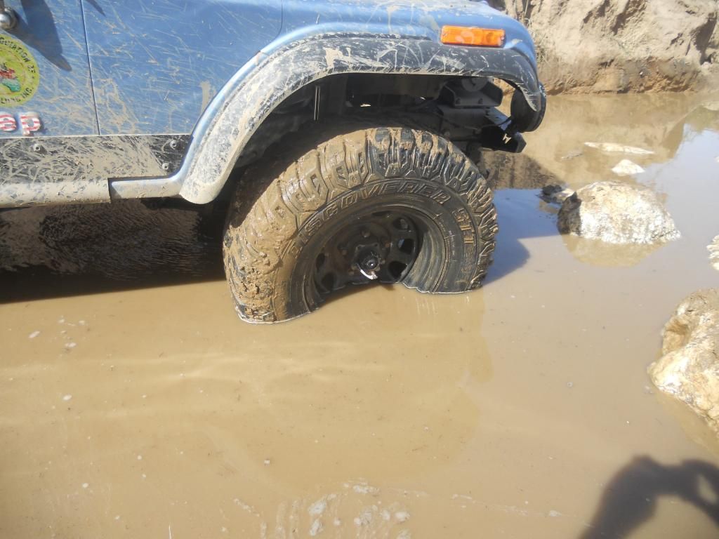

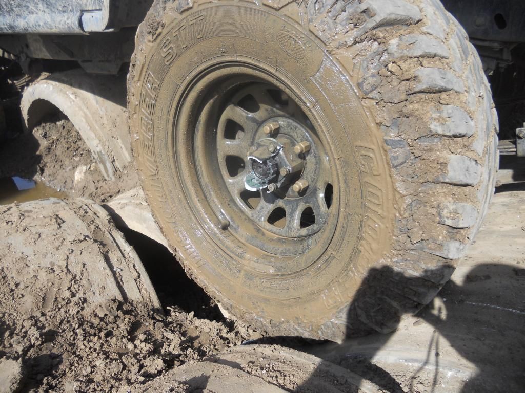

Back to topic CJ, got out today with SonicR1 to Hollister Hills. I took a friend's son (he has a '07 JK) and met Sonic out there. As Sonic mentioned, it didn't take long to grenade a brand new Warn lock out. No big deal, I had 2 spares with me just in case. Took the 10 minutes to replace it and back at it, having fun. Well, 2 hours later I blew both of my spares up too!!!
Is it me? I thought I was fairly easy on the throttle. I had sheared 2 grade 8 bolts off in the hub, severely bent 2 more bolts with only 1 really still useful. The passenger side hub is shot, 2-3 of the 5 bolt holes are all wallowed out. I am now back in the camp where it is time to upgrade to the 6 bolt hub/lock outs. I need new hubs anyway. I have always liked the idea of the fuse being at the lock out vs. U joint or axle but 3 lock outs on the same side in 2 hours just doesn't seem right. Stay tuned, I will let you know where I go with this...if you have suggestions, I am all ears...
this is what 3 shot lock outs look like
