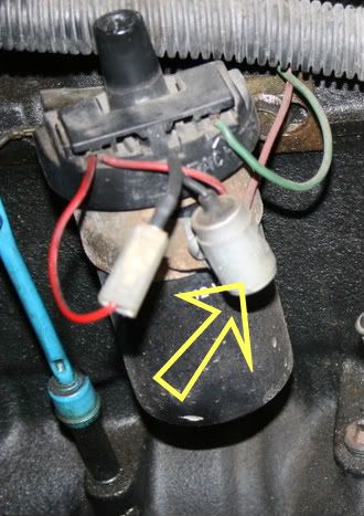

OK, yours has a lot more wires than mine, and I don't have those things. Too bad summit won't take this thing back now that I've opened it. More complicated than my brain can understand.

What is the second red wire going into the left side of yours? I had 1 wire on the left, and 2 green ones on the tach side. Is the other red wire part of the ballaster? The picture of the one MSD sells looks nothing like that.

Let me see if I can get a better shot of the coil once I get off of work. I thought I had read somewhere that the ballast is basically there to keep the ignition noise out of your radio.... There was a thread I started on the TeamRush install that JeepHammer had some good information in. It was his recommendation on the 2F coil for easy plug and play.

No, your not on a points style ignition. The Blaster 2f was a direct plug in for my upgrade on my 258, but I do think I had a small ballast on my connector. I just disconnected the old one and hooked up the new.
Nope, that round thing in the picture is a Capacitor.
Old timers called it a 'Condenser'.
In points ignitions, it's often located in the distributor next to the points.
It's function there is to absorb some electrons so the breaker points can open cleanly and not arc across the gap.
In modern ignitions, it's often located at the coil, and it's there to 'Buffer' the current fluctuations as the coil is switched 'ON' & 'OFF' for each firing cycle...
It's there to help remove coil switching 'noise' from the electrical system...
Most commonly heard in the radio when you have the radio turned up between stations and when you have a tape or CD in and you will heat the switching noise in between songs.
If you hear the ignition in the radio only, but not when the tape or CD is on, then that's not switch noise, it's RFI, or Radio Frequency Interference.
You probably have a bad plug wire, distributor cap terminal, something like that...
