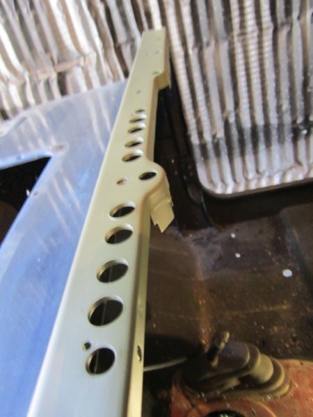

Today, I made my defrost modification. After watching all the other solutions and realizing I am in the south where defrost is not critical I decided to work with what I had on the YJ tub since I don't have a welder.

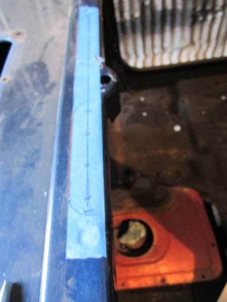

First, Layout a series of 7/8" holes:

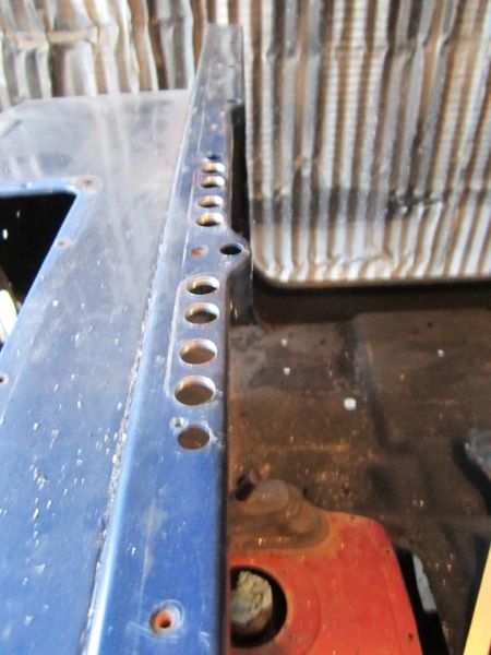

Drill said holes:
Modify duct to fit:
Paint:

Scooter, why did you not connect the holes to make slots?
Kerrdog
Go Fish! <*////><
Skerr is offline
post #33 of 53 Old 09-23-2012, 03:13 PM Thread Starter
scooter71954
2016 JK Wrangler
Join Date: Mar 2012
Location: Seabrook
Posts: 297
left it as holes for strength. Also thinking the airflow thru the holes will increase the pressure of the system and help with the defrost flow. We shall see.

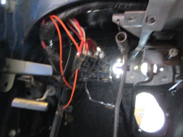

E-brake pedal; pedal assembly and wiring harness

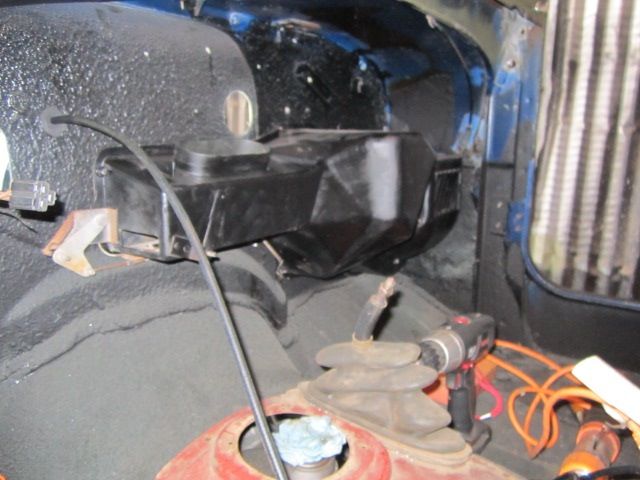

Heater box
