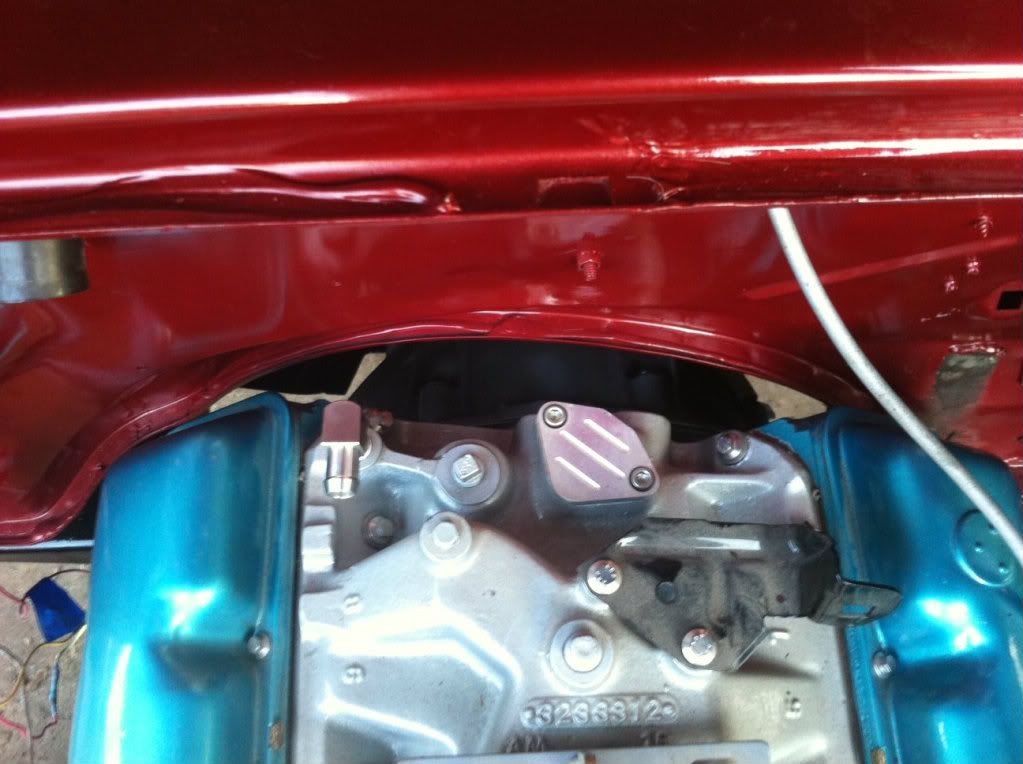

Originally Posted by lucdog
The passenger side will sit closer to the firewall, because of the offset of the cylinder bank.
My drivers side is the one that's closest, the passenger side has more room. The heat shield is on the body side.

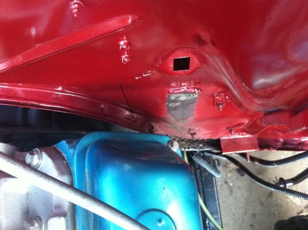

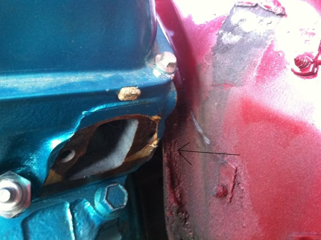

The firewall is a little offset on the pass side so I guess that why I have more clearance on that side.
I have a little over a finger with between the engine and actual firewall, the parts that close is the distance between the engine and the lip / seam on the tub where two sections meet.

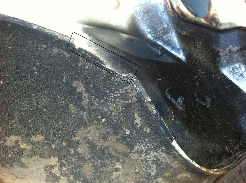

I did notice on the 80 tub I have, that does not have a heat shield, there is a small notch in the seam that looks factory.
Checked the 81 Laredo tub and there is a notch as well. Maybe they notched it from the factory for the V8 years. ??
I think I am going to try to notch the seam with the engine in to get a little more clearance. Looks like I can get a recip saw back their.
Any other thoughts guys?

Was chatting with Bill and he reminded my about my 1" body lift. Thinking it is playing in to it as well. With out the lift the seam would be below the head and not a issue.

MoC, don't you have a 1" body lift? I've been studying our pictures, and trying to figure why your engine sat lower than mine, when compared to my stock one. And I just remembered when you said the fuel line was easier to run with the lift.
Anyway, I think you'll be good, anything over a 5/8" clearance between the tub and engine won't cause problems. Also, it's probably why you have more clearance on the passenger side. My passenger side fire wall has a heat shield, remember its a 1978, and there's less than a 3/4" clearance between it and the enginebill

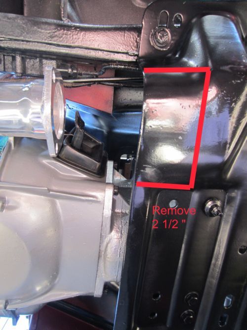

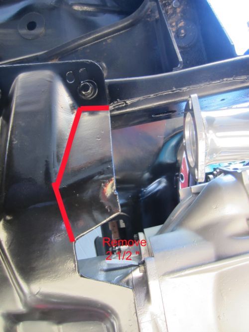

I though about a tcase drop to lower the skid down then fabing something to keep the tcase and tranny at the original level.
I am going to pay a shop to run the pipes. So once its all in I will bring it there and find out exactly what they think will have to be removed from the skid to make it work and kind of go from there.
I can remove up to 2 1/2 inches from the skid and get a total of 6 inches clearance between the pipes and the skid. If I do that then I would likely weld something on the front to come up at a angle below the headers.
