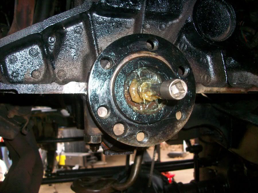

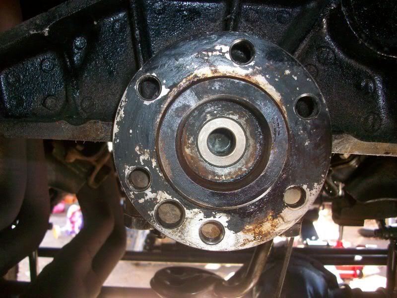

Played for a few minutes today and removed the old pilot bearing by using the grease method. Packed it full of grease first.
Found a socket that fit perfectly and filled it with grease as well. Inserted it into the pilot bearing.
A few good whacks with a mallet and it started coming. Repacked it again and a few more whacks and it came right out.

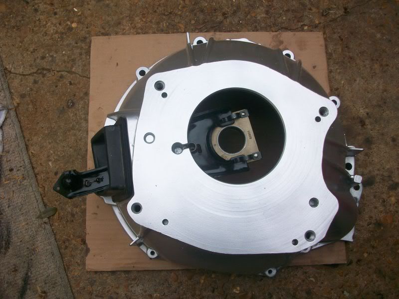

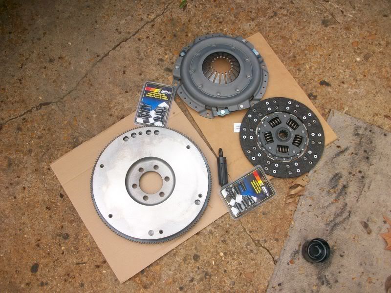

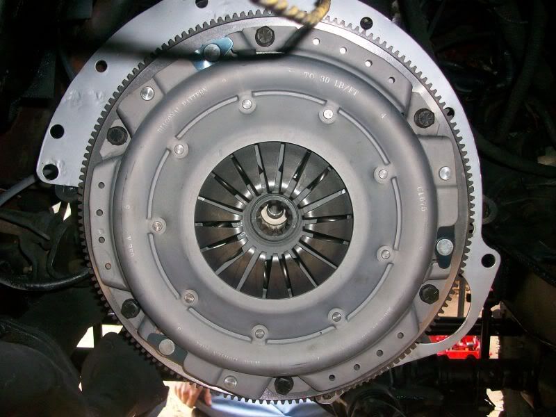

Well LSUtiger an I put in 2 1/2 hours of work yesterday and made a little progress.
Pulled out some of my new shiny parts.
New pilot bearing installed.
Spacer and flywheel installed. Ended up using my old flywheel bolts the Mr. Gasket replacements were to long for my comfort. They stuck out the flywheel and were a millimeter or two away from the engine.
Next clutch disk and pressure plate.

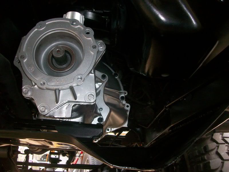

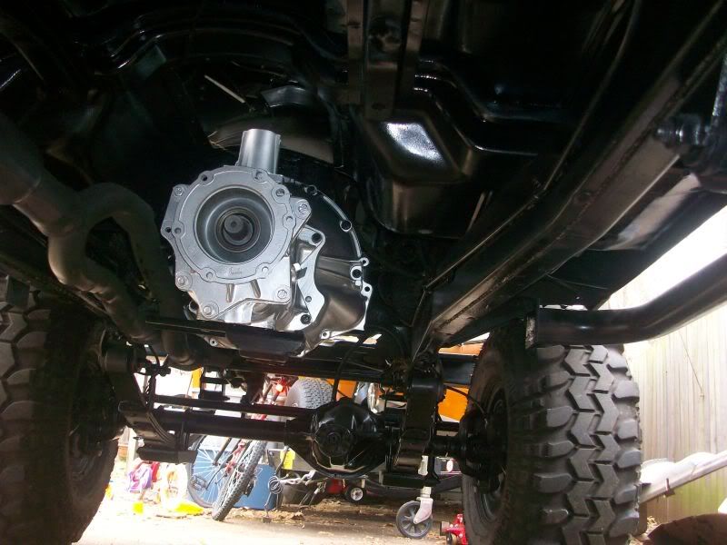

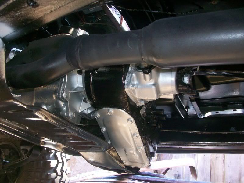

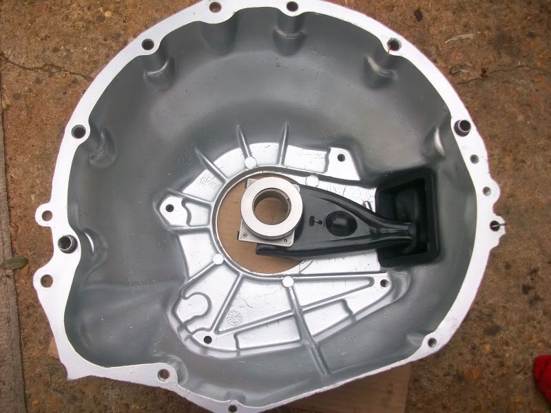

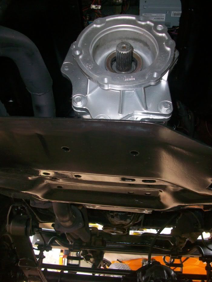

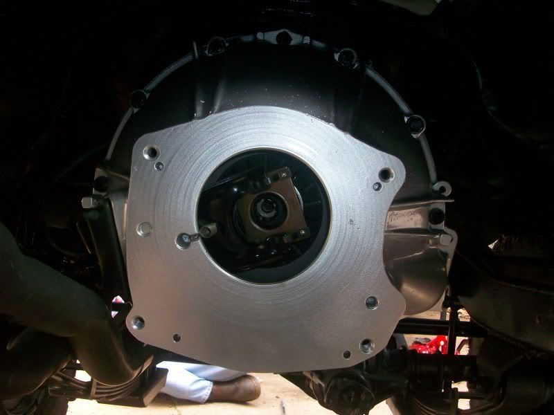

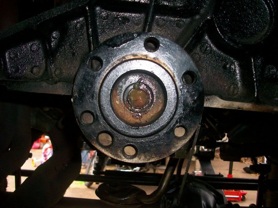

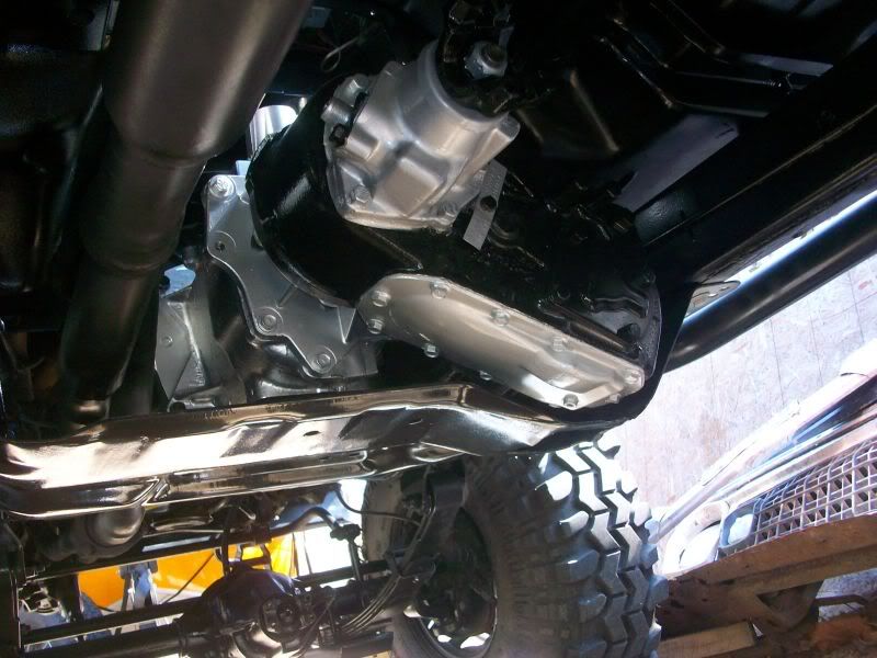

Assembled the bell housing fork, throw out bearing, and springs and installed it.
Tranny stabbed.
Cross member installed
Then lastly Tcase installed.
Only going to be able to get a hours or so in today and I am hoping to get both motor mounts replaced and the oil pan installed.
