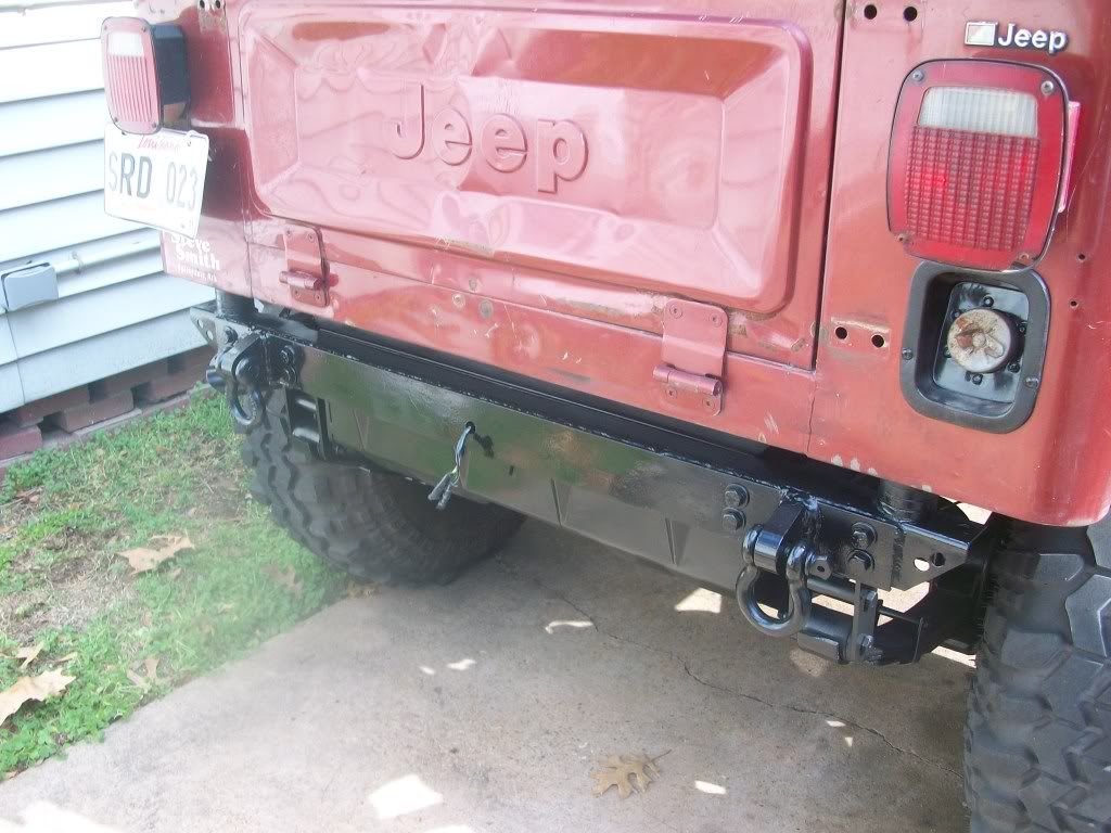

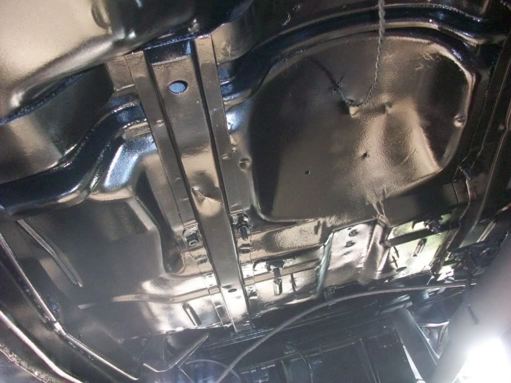

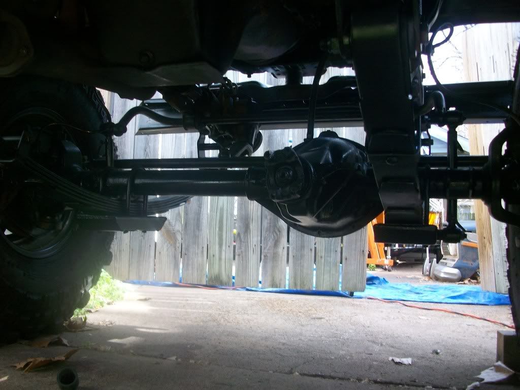

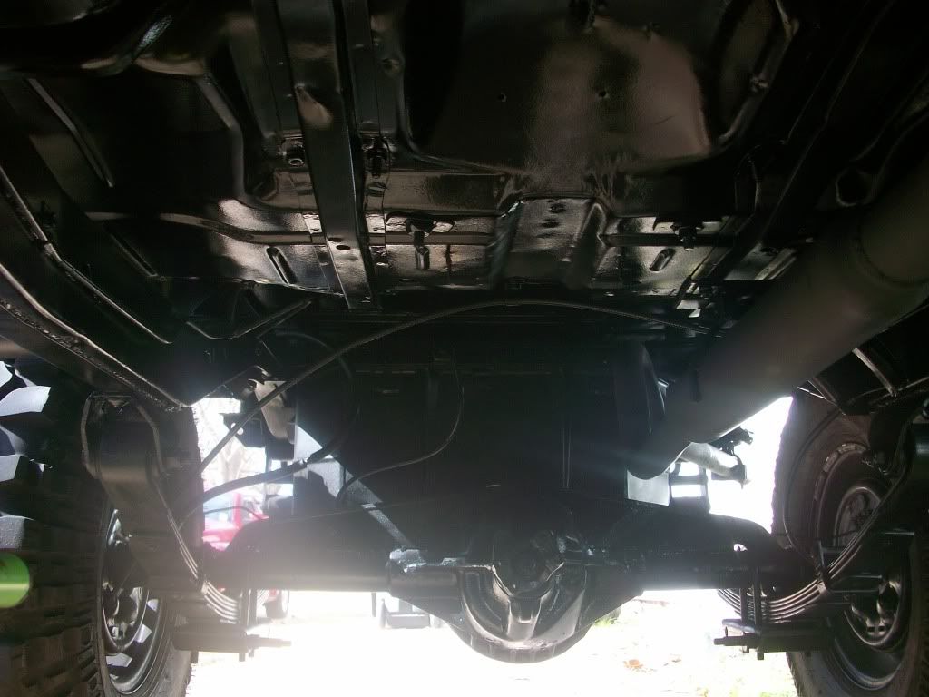

Well some more progress was made today! We were sunny and got up to 74, a good change from the rain and cold we have had for the last month or so.

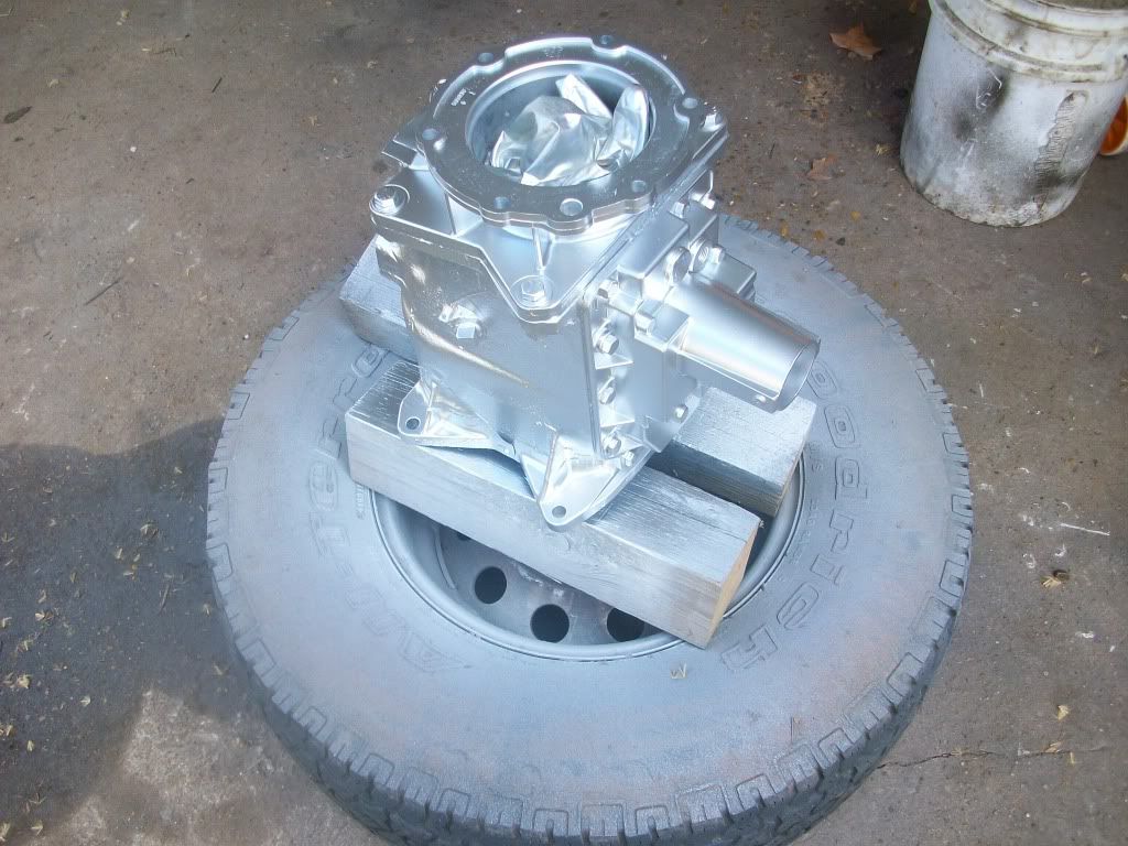

Last night I primed the tranny and the tranny shifter. Got two coats of aluminum on the tranny today and two coats of black on the shifter. Tranny came out nice!

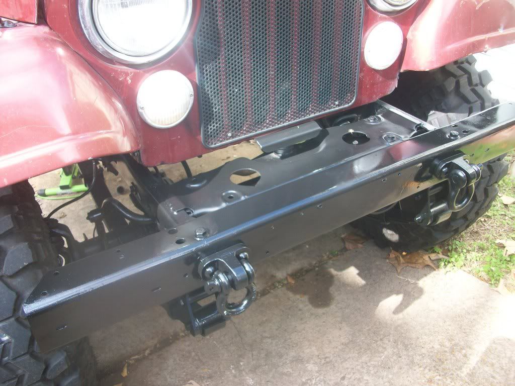

Next set off to finish the last of the under the jeep painting. Already had 2 coats of primer, 1.5 coats of rubberized under coating, and one coat of gloss black on the frame, bottom of the tub, and wheel wells. Put the finial coat of gloss black one everything and also went ahead and out 2 coats on my bumpers, axles, and nerf bars.

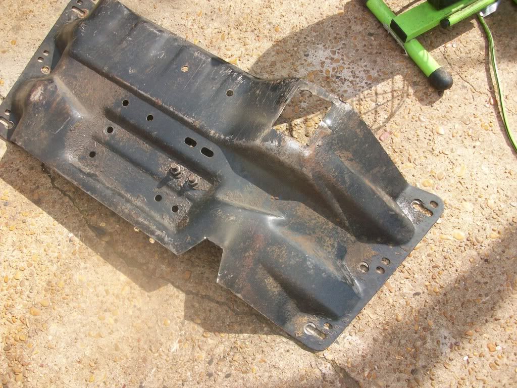

After that I did a little cutting on my cross member. I cut two places out a little. The first area I cut was where the front drive shaft passes over the edge of the cross member. After my lift and camber adjustment there was almost no room between the two and it made me a little nervous that they might be able to touch so I clearanced it out. Also cut a square out of the area that originally had the two holes under the tcase. The two times I have drained my tcase the oil mostly fell on the skid and dripped down ever where so the idea of the square hole is to allow all the tcase gear oil to flow out and not make a mess.

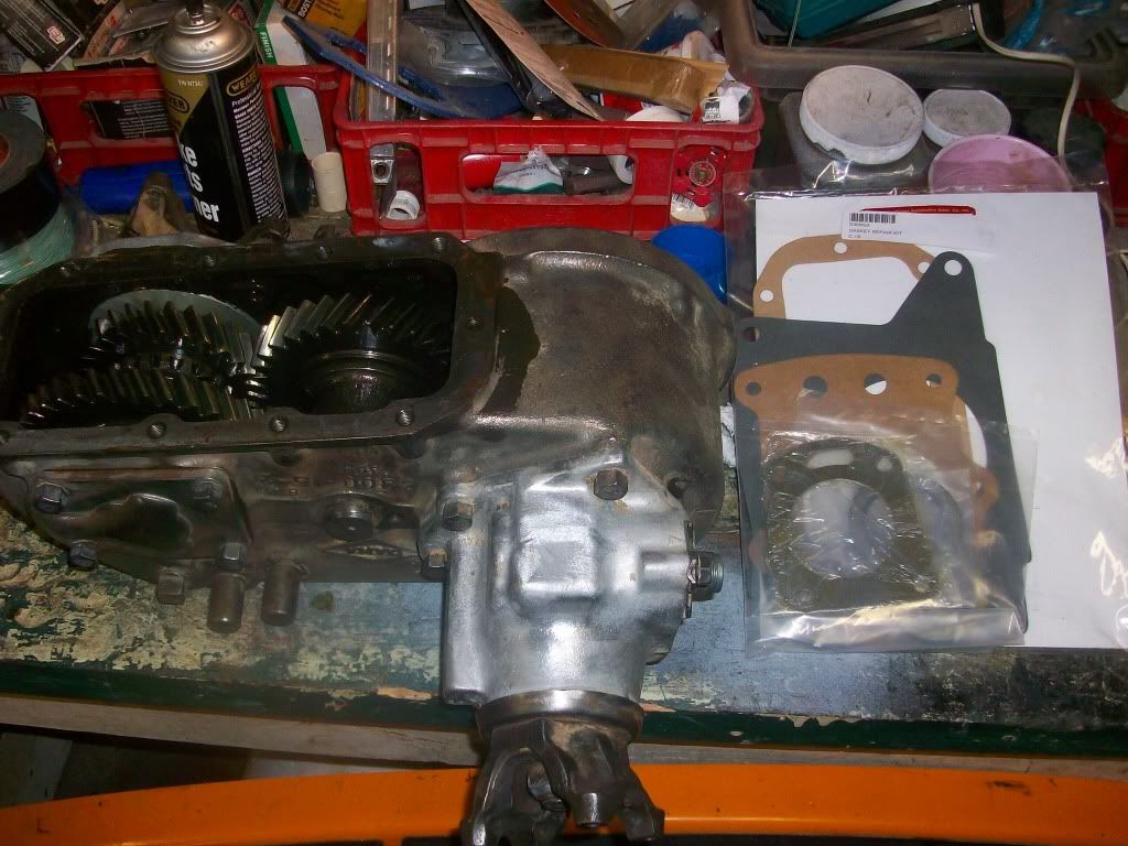

Next started my tcase debacle. I bought a oil seal and gasket kit and set out with reckless abandon to change it all. What I did not realize was that in order to change the paper gaskets I pretty much had to break down the whole tcase. If I would have known that starting out I think I would have just done the oil seals. Whats that about hind sight???

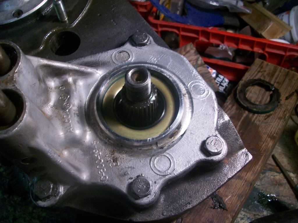

So started out by pulling the bottom cover off.

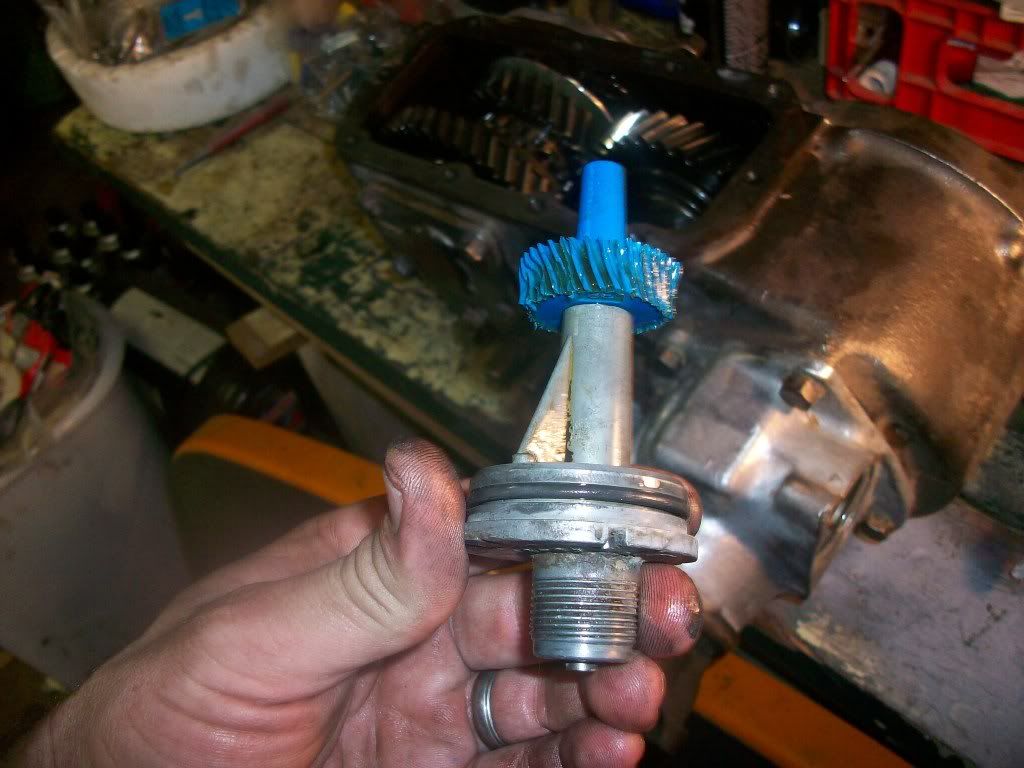

Next I pulled the speedo gear and found the my 7 month old gear was toasted. Just I did not seat it in correctly, funny thing is that it has worked this whole time like this.

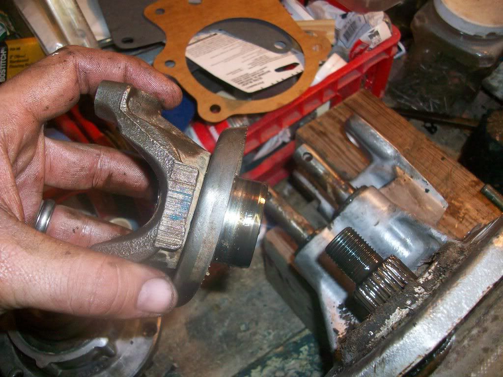

Next pulled the yokes off.

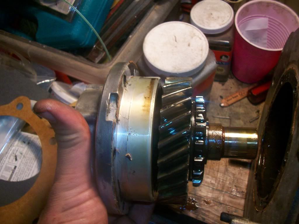

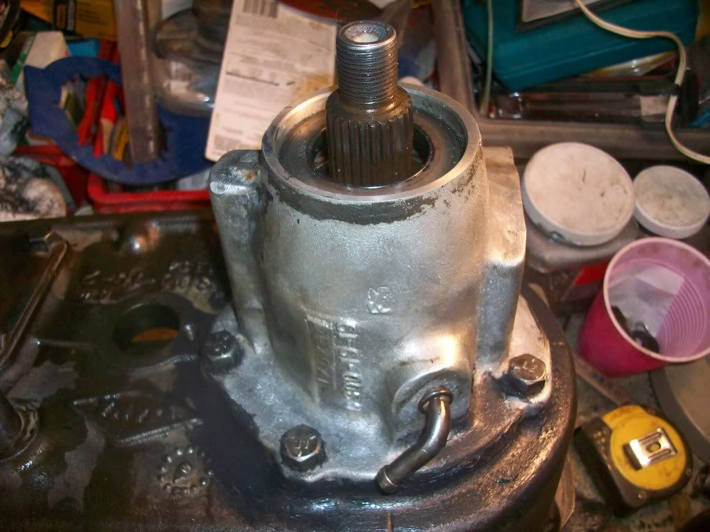

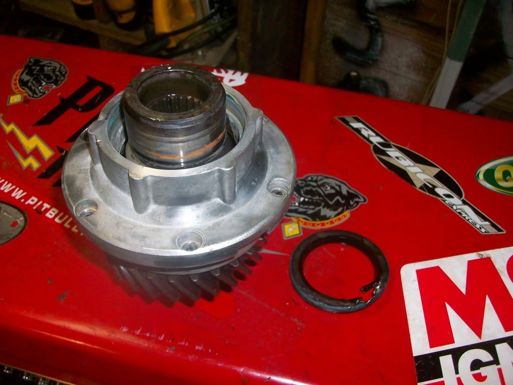

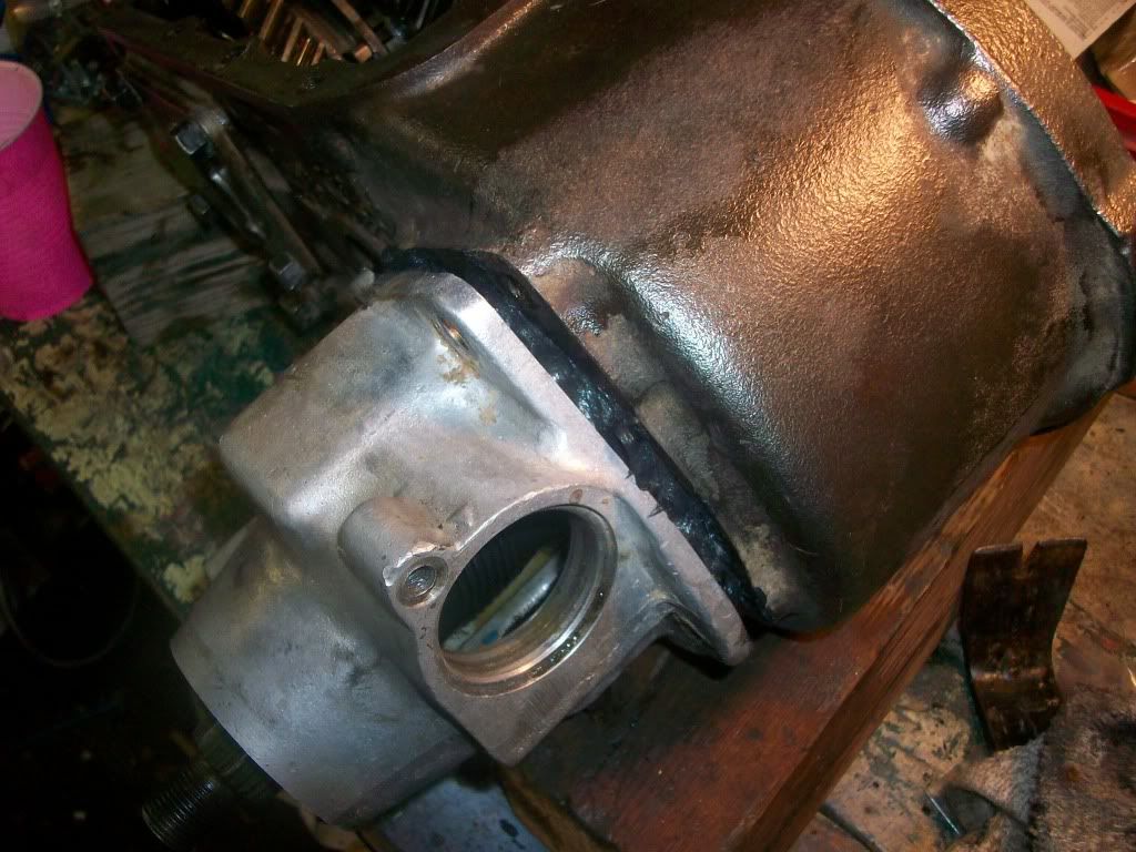

I then pulled the input shaft support housing out the back.

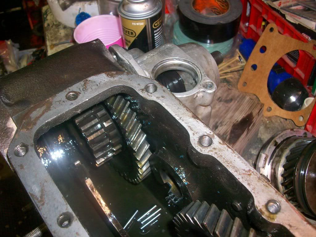

Then I removed the bolts out of the front and rear bearing cap. It was around this point that I realized that they were not coming out without pretty much breaking it down. I pulled the intermediate gear shaft next.

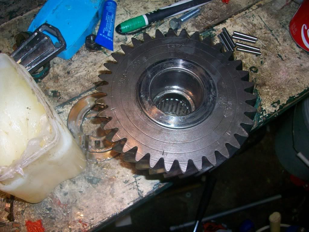

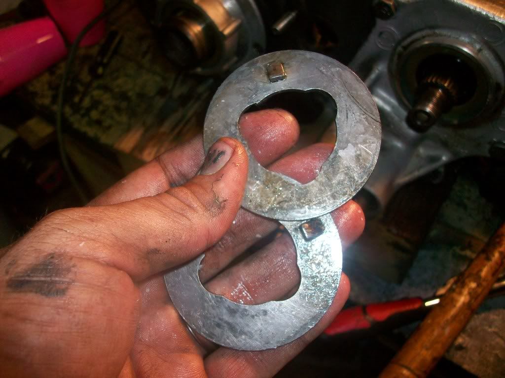

After that pulled the intermediate gear, needle bearings, bearing spacers, and thrust washers. At this point I decided to put on the brakes and stop. My plan originally was not to rebuilt since everything was in good shape just seals and gaskets. All the bearings looked good.
The thrust washers looked good to.

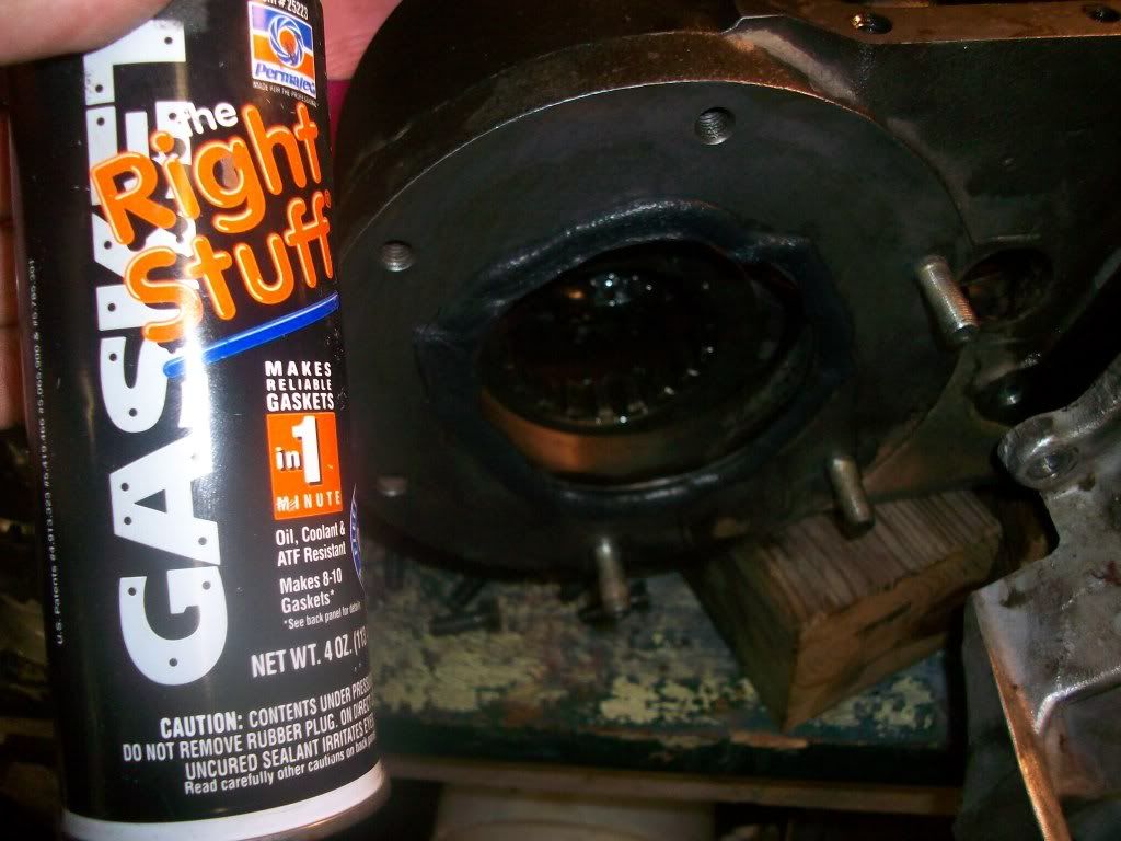

Plus I only had the seal and gasket kit and not the rebuilt kit so I decided to put it all back together without using the paper gaskets and just using some sealant.

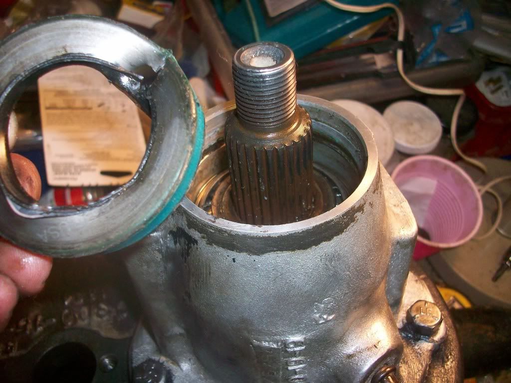

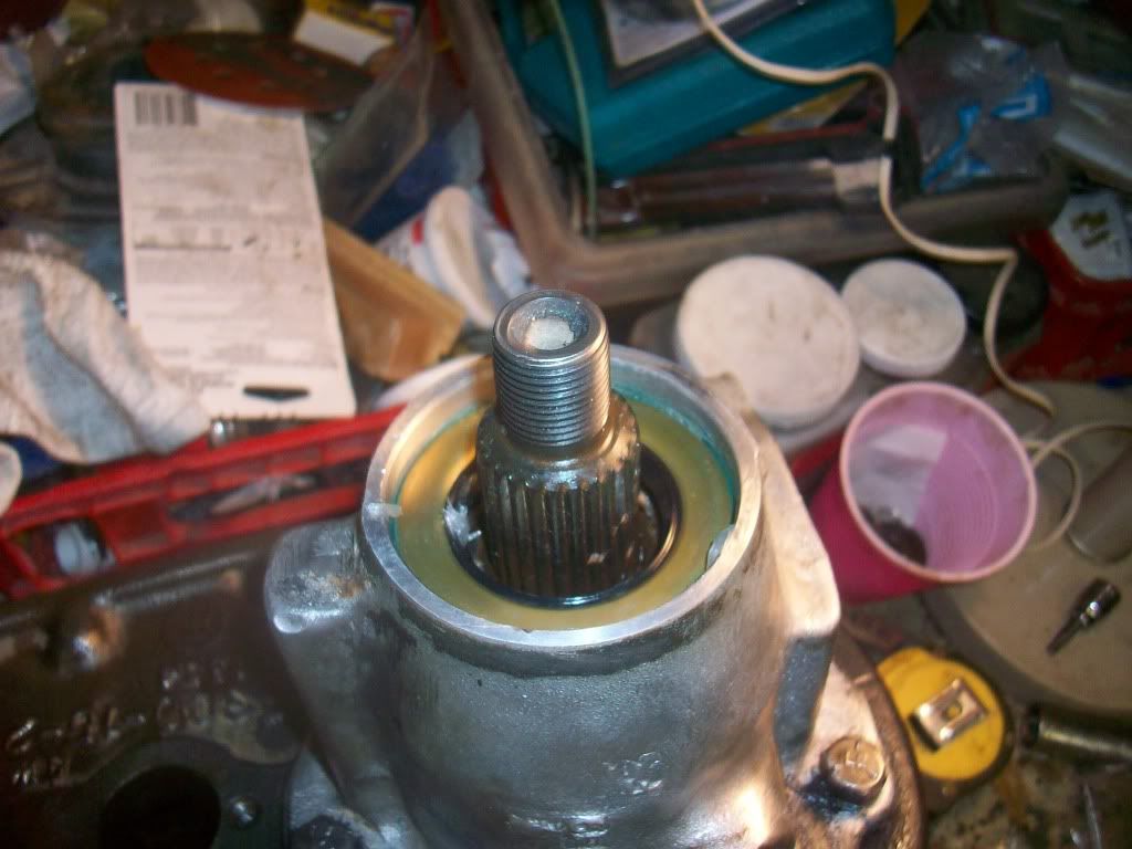

Cleaned up the input shaft support housing, removed the old oil seal, installed the new one, put on some goop, and sealed it back up.

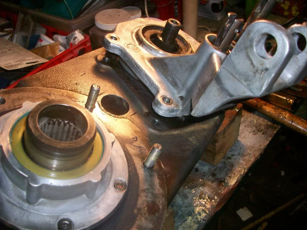

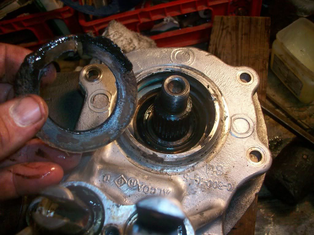

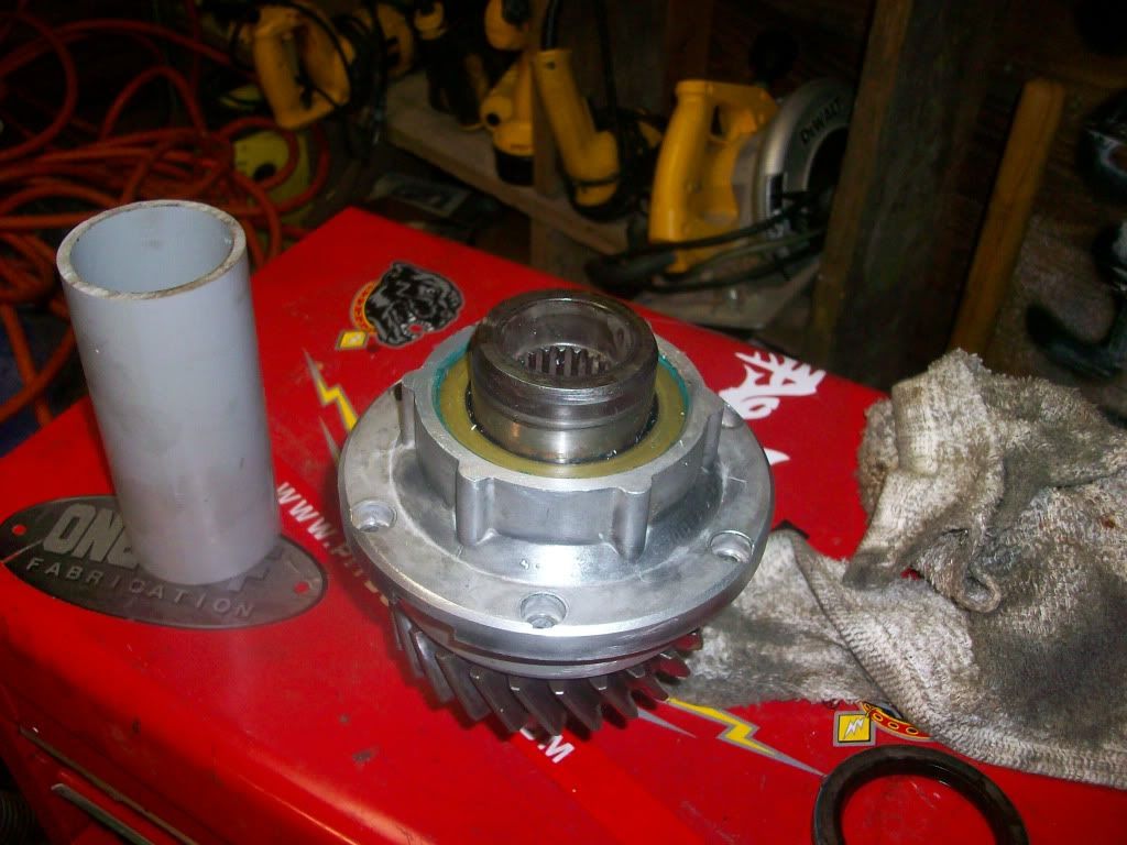

Next on to the rear bearing cap. Pulled it as far off of the tcase as it would come. Cleaned the surfaces really good and wiped down with brake cleaner. Applied the goop, tightened it down, removed the old oil seal, and installed the new one.

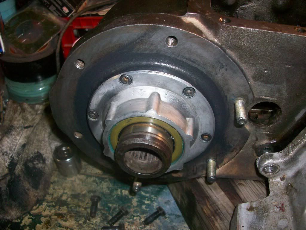

Next on to the front bearing cap, same as the rear. Pulled it as far off of the tcase as it would come. Cleaned the surfaces really good and wiped down with brake cleaner. Applied the goop, tightened it down, removed the old oil seal, and installed the new one.

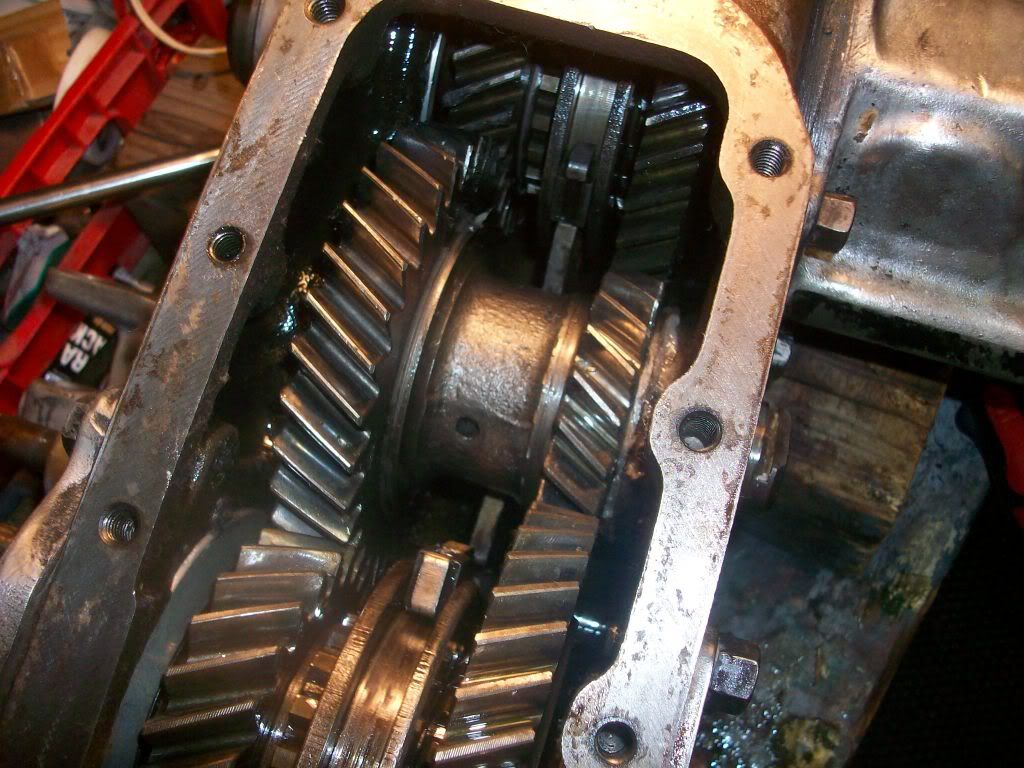

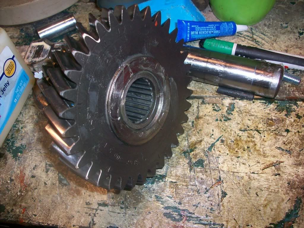

After all that reinstalled the needle bearings and spacers in the intermediate gear.
Put the thrust washers in the case, dropped in the intermediate gear, and installed the intermediate gear shaft.
The tcase was a lot of work that I put my self through, only if I have done a little reading and discovered no way to change the paper seals without taking do much apart....
So after my goop dries I am going to spray out the inside of the tcase really good and install the bottom cover and gasket and shifter oil seal. After that the tcase its off to paint and the final reassembly.
