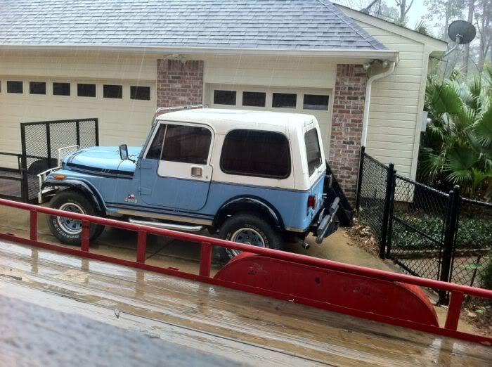

Saw this nice looking guy in the yard next door to a house I was working at today, in the rain. Its funny, I see more nice CJ's over the fence while working than I do on the road here. Had a chrome grill. Other than the ugly bumper and blue rims was a clean CJ.
