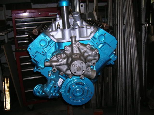

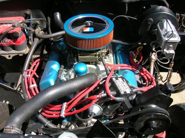

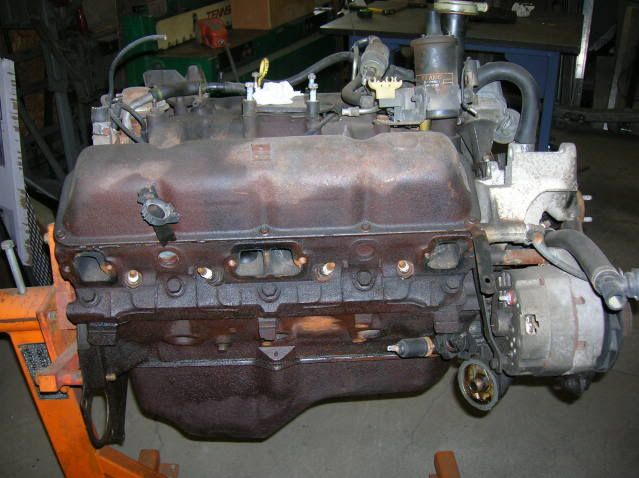

MoC...there is a seller on ebay that sells a lot of 360s. His descriptions are pretty good. I bought one from him ($399.00), before I even owned my jeep. At the time, I HAD to trust him, as I didn't get to hear it run.
I drove down to PA (although he will ship...) to buy it. I put new gaskets and seals in it, and painted it. When my 401 crapped out, I decided to install the 360, hoping for the best.
The thing runs better than I could have ever imagined! I have an Edelbrock intake, and a DUI HEI distributor, a Holley 600, and headers, which help, but I can't believe how nice this thing runs.
Point is, they're out there.
Here it is, as bought...
Here it is, after a little effort...
Rich
