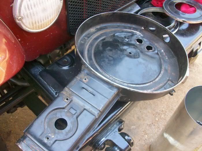

Well for lack of anything better to do today I started another little jeep project. A while ago Paul posted a picture of a fab job he had someone do on his factory air cleaner to fit on to the 2100 and I decided "I can do that" so off to thinking I went.

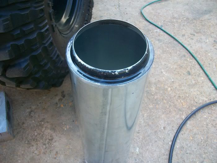

Bought some 30g ducting from lowes.
My plans are to cut it down to about 3 inches tall and then weld it to the base of the 2100 filter plate I have been using.

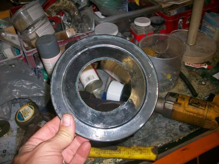

Then I am going to cut a hole in the top of the 2100 filter plate I have been using for the original air cleaner horn to fit in to.
Then weld it to the factory air cleaner and then to the lower piece.
No problem!

Well got everything fabed up.
Cut a 3 inch hole in the top of my 2100 air cleaner top for the horn on the stock cleaner to fit in to.
Cut 1 inch off the horn on the stock cleaner. Removed all the emissions stuff off the stock air cleaner.
Attached the bottom of the 2100 cleaner to my ducting.
Then cut the duct down and put the rest of the pieces together.
Still got some work to do to it to finish up and will not get a chance to do it till this weekend. I need to fill the holes in the air cleaner where I removed the emissions stuff, finish up sealing the adapter I made, and modify the bracket the sits on the valve cover that holds the air cleaner in place. The 2100 sits a little taller than the carter did and I need to raise the air cleaner about a inch higher off the top of the valve cover to make it level. Once all that is done prime and paint! Will post up the finished product pictures this weekend some time once I get done.

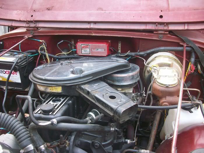

Looks great!!! Since the MC2100 is taller than the BBD I also had to raise the mount on the valve cover. Unfortunately I lost the original bracket but you have it and could just add spacers and longer screws. I have to fab one out of some scrap metal, carriage bolt, washers, spacers and a few nuts.
