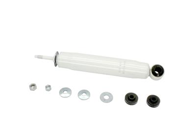

Current project is to put the stock stabilizer back on.
I have found three choices in the correct configuration and think I will go with the Monroe as it has the name recognition, I dislike the quality of Crown and Omix, and have never heard of KYB (shocks, not the jelly)
MONROE SC2940 Steering Damper/Steering Stabilizer
At 31.77
18040.01 Omix-ADA Steering Stabilizer JEEP CJ5 CJ6 CJ7 CJ8 55-86
39.25
KYB SS10316 Steering Damper/Steering Stabilizer
38.54
KYB is sold through Summit and I get a driver discount through them so Monroe and KYB are the same price to me.
Recommendations?

Go to RockAuto. That Monroe is $23 there, KYB is $26.
5% discount code.....96788357969687
Never heard of KYB. I know Monroe Makes Rancho.

All shocks are made at Monroe or Gabriel and built for the particular vendor.
gmakra is offline
post #1821 of 2044 Old 06-05-2013, 06:49 AM
Matt1981CJ7
Matt1981CJ7's Avatar
1981 CJ7
Location: Elbert
Posts: 18,002
And most all steering stabilizers have a 50/50 valving, so there's very little difference between any of them.
