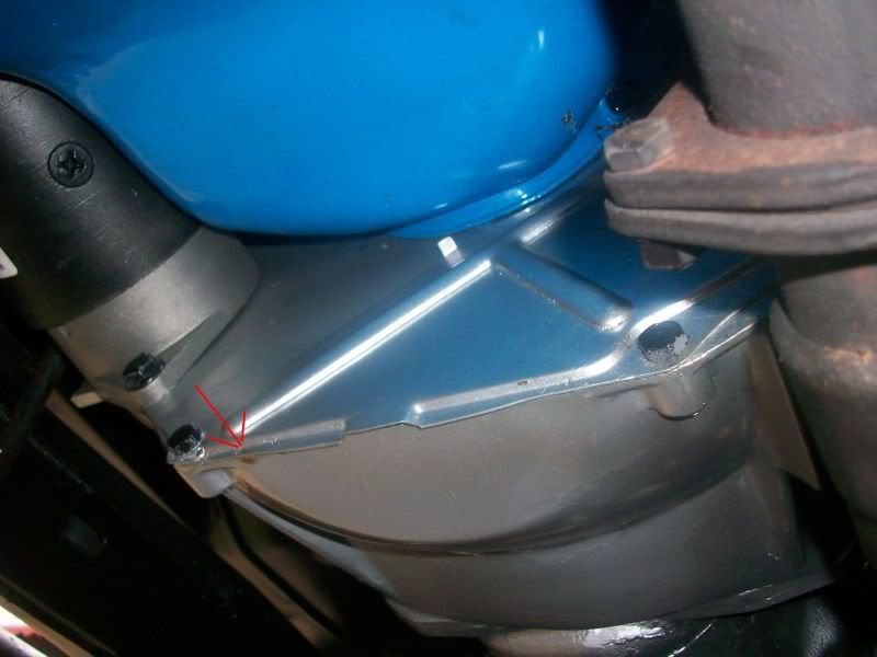

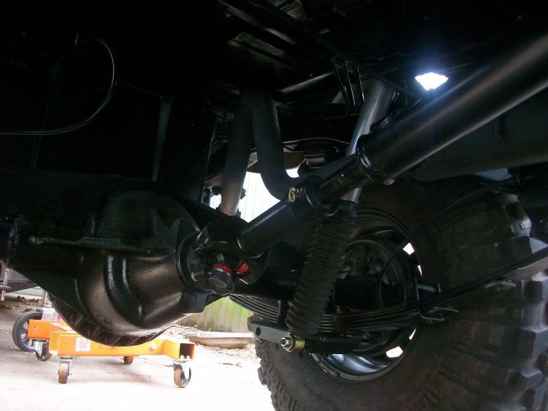

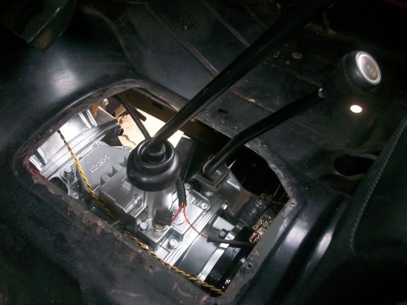

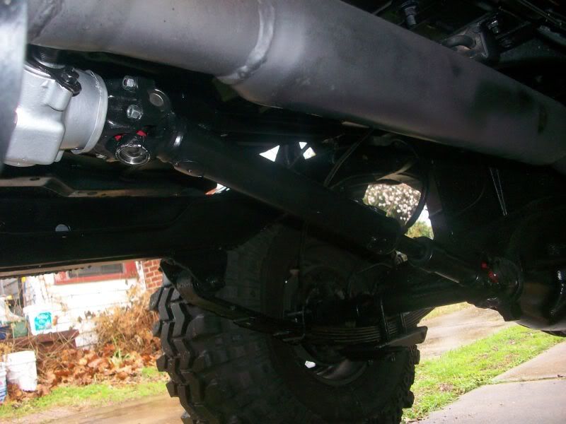

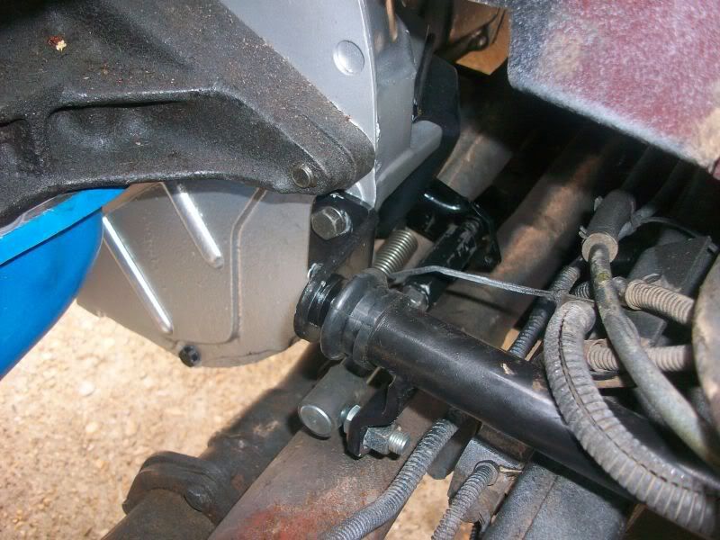

So this is all from last weekend. Inspection cover, shifters, starter, clutch linkage, and rear drive shaft installed. Spent some time getting the clutch free play dialed in as well.
Did not work today as long as I was planing ended up doing some driving instead. This morning installed the shocks, greased the rear drive shaft and bellcrank. Also checked and tightened bolts on valve cover, intake exhaust manifold, ubolts, ujoints, tranny, tcase, bellhouse, header to pipe conenctions, and starter.

So a little more about the oil leak I was talking about after my first drive. It has not gotten worse and does not actually drip on the ground. After my 30 drive this was all that was present. Part of the reason I wanted to hit 70 was to see it if would get worst and it did not.
Planing on pulling the inspection cover and looking inside but with it not dripping and only leaving this much I am almost thinking about letting it ride. Cant see pulling the oil pan again for this little amount. Based on what you see would you guys pull the pan or roll with it?

No worries, it can only get worse.
Seriously though, I'd take the inspection cover off and figure out where it's coming from before it gets too dirty. That way when It does get worse, you know where it started.

Well it has to be either the RMS or the oil pan, both were replaced. I feel real good about the RMS job but when the 1 pc oil pan gasket and pan went up I had a feeling the gasket did not seat properly in the groove. If it is pooling in the bellhouse I am going to attach it fun sure.

Thant should be a relatively easy fix

I'm hoping it isn't the RMS
My CJ is spewing it out from there lol. Be ashame to dirty up all that clean work you've done Moc!!
