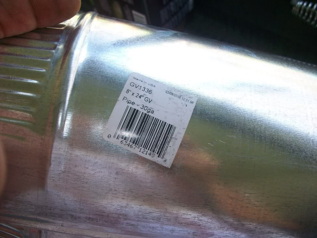

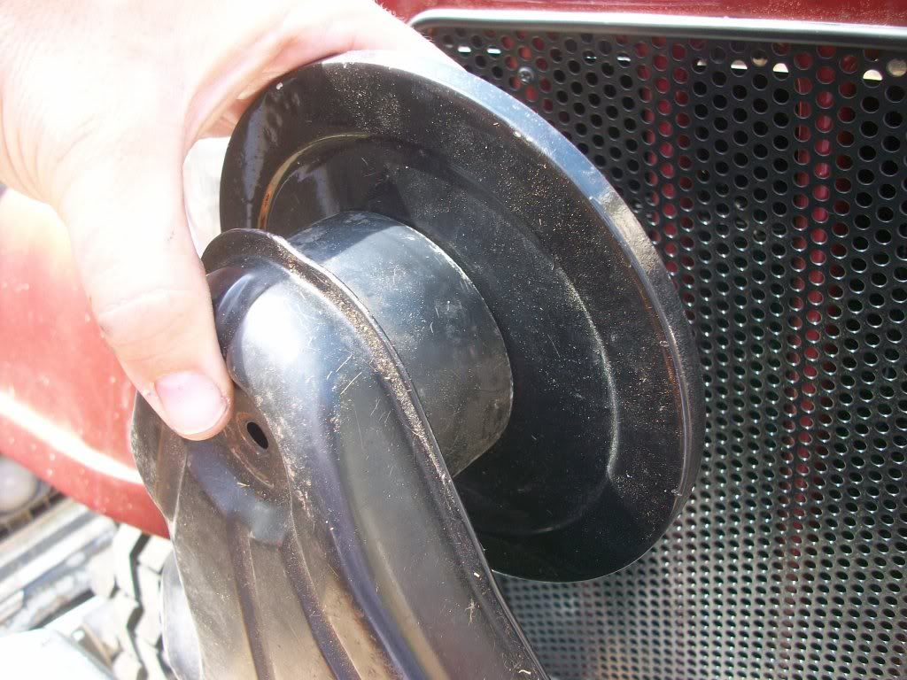

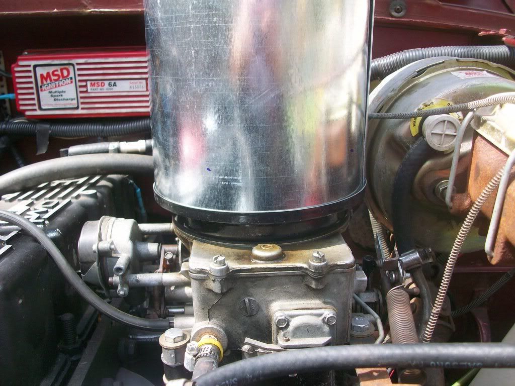

Well for lack of anything better to do today I started another little jeep project. A while ago Paul posted a picture of a fab job he had someone do on his factory air cleaner to fit on to the 2100 and I decided "I can do that" so off to thinking I went.
Bought some 30g ducting from lowes.
My plans are to cut it down to about 3 inches tall and then weld it to the base of the 2100 filter plate I have been using.
Then I am going to cut a hole in the top of the 2100 filter plate I have been using for the original air cleaner horn to fit in to.
Then weld it to the factory air cleaner and then to the lower piece.
No problem!

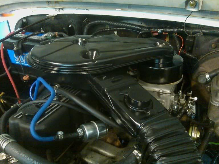

Thanks for the detailed writeup! Do you have a link to Paul's modification? I want to do this and the more info I get, the better..
