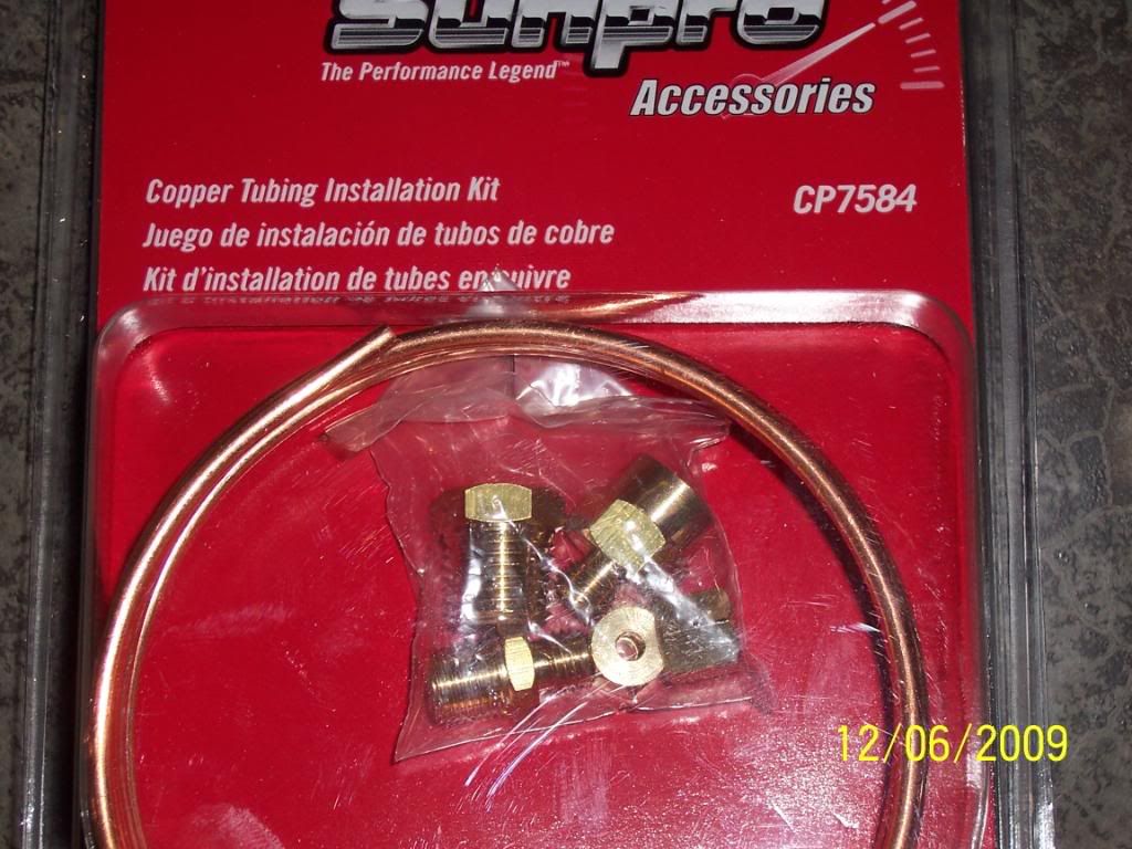

I have the same set up you do. I had to replace the guage too but it started as a leak as well. I got a new sunpro for $16 and a copper line kit that made all the difference and was EASY to install.
