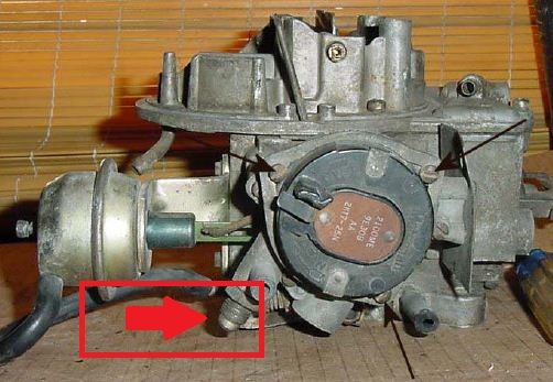

Where connects to this nipple? I've got the fuel inlet on the front of the carb, and the PCV in the middle of the rear, along with the ported vacuum to distributor underneath the choke.
Thanks in advance for helping me out!

I didn't know what that was either and since the old carb had nothing like it I just capped it.

On my 78 that attaches to the hot end of a small heat exchanger (not sure what AMC or MC called it) that fishes down into the intake. It provides hot air to the choke to open it up as the engine warms. The other (cold) end of the heat exchanger attaches to the 45* elbow hanging from the bottom of the filter base (shown in your pic)

I believe it sucks hot air up and into the choke to help regulate how fast it opens.
It needs capped off if not used.

It is the connection to the piping to the choke stove. The choke stove should be just below the choke in the manifold, or at least the hole for it should.

OK, thanks again to y'all. I'll cap it.

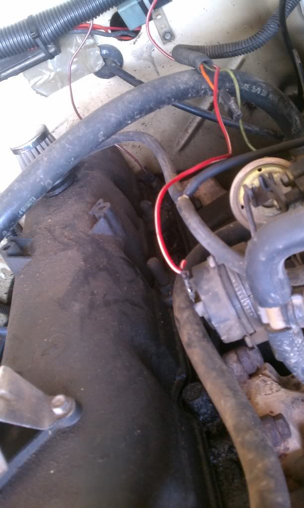

What is the red wire for that is attached to the underside of the intake manifold? The ECU is sitting in a drawer in my garage. Can I just leave this unplugged?
same question for the green wire - it sits on what I'm assuming is a sensor on the top of the intake manifold towards the rear?
My choke has two wires sticking out of the connector, but one is clipped... Is this bad?
Thanks

Originally Posted by adrose211 View Post
Well, the questions just keep on comin'...
Thanks
The first pic is your manifold heater, which should be hooked to an oil pressure switch on the passenger side of the engine.(kind of behind the distributor).
Not sure about the green wire, but your choke should be fine.
