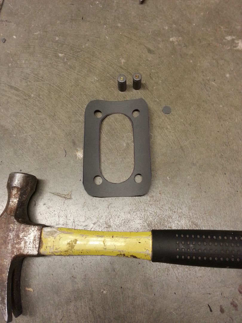

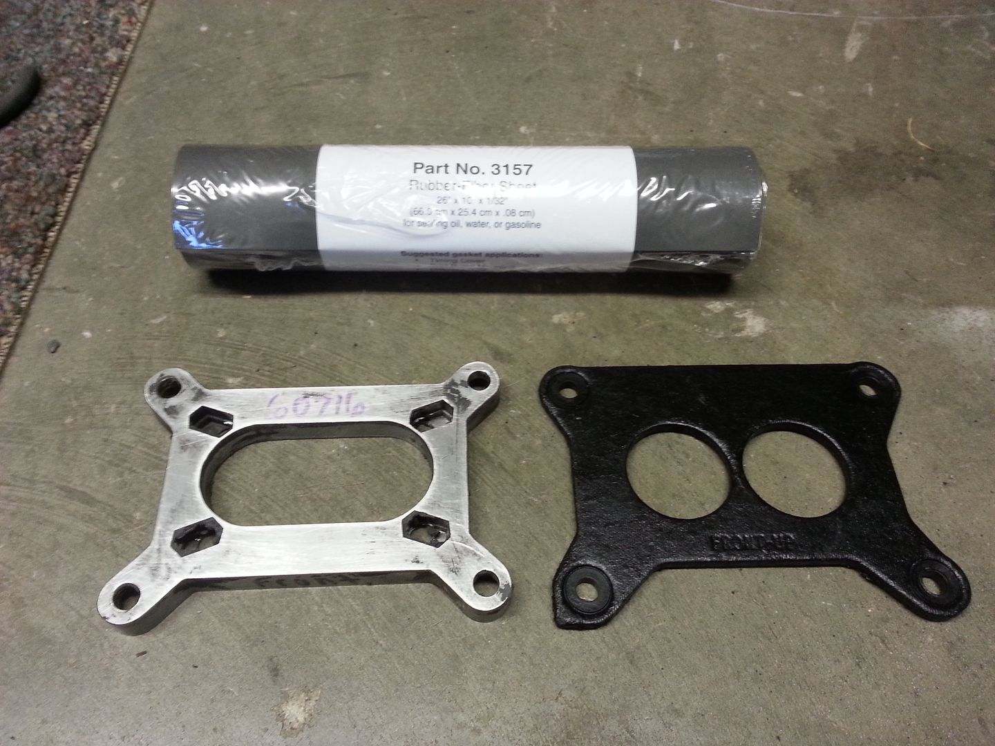

Since the shenanigans with the carb gasket I figured I should post up some pics to keep it interesting. I started with some gasket making material and a fel pro 60716 gasket. By the way Thanks scrapman.

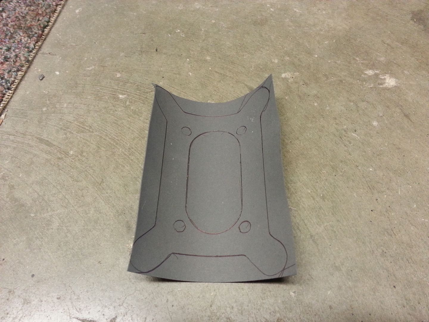

I traced out the carb spacer onto the gasket.
Then I cut it out with some scissors and razor knife. Then I used some .40 cal spent shell casings to cut out the bolt holes. Just line up the casing and smack it with a hammer. Like butta!

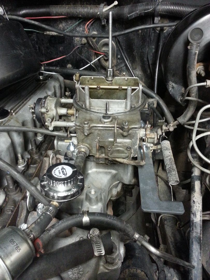

Then I bolted up the carb
somewhere inbetween bolting it all together my camera battery took a crap so I dont have many more pics but you get the idea. She fired right up and idled beautifully so I took it for a late night ride into town. Then I came home and swept out the garage.

SWEET! Great idea on cutting the holes in the gasket. I'll have to remember that one. Now drive it like you stole it!
BTW: Before someone else tells you, I will. You need to turn your fuel filter so the return line is at 12 O'clock, or you may get your gas siphoned out of the carb.
