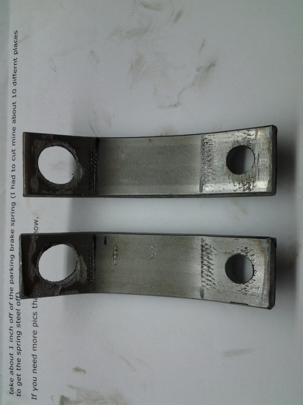

As Promised I took my brackets off last night and made a detailed (traced) diagram to assist in thoes who want to make these themselfs. this is the "best" of the 2 sides I made.
Sorry im not a CAD guy and my artwork is not "ideal" but should be good enough
Parking Brake PDF with Rulers for dimmesions
http://sherlocktk.com/84%20300zx%20t...20Template.pdf

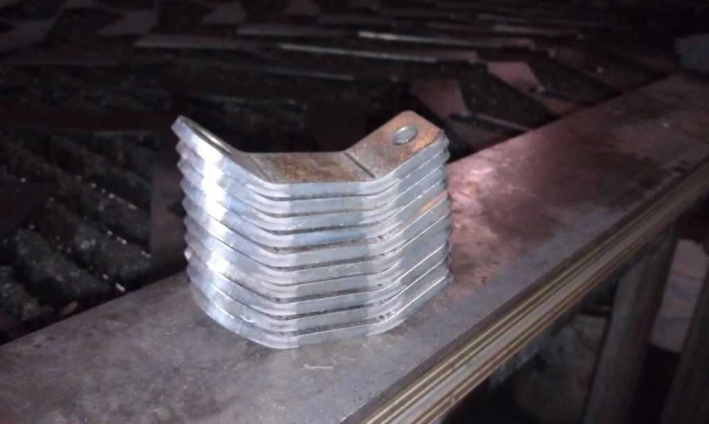

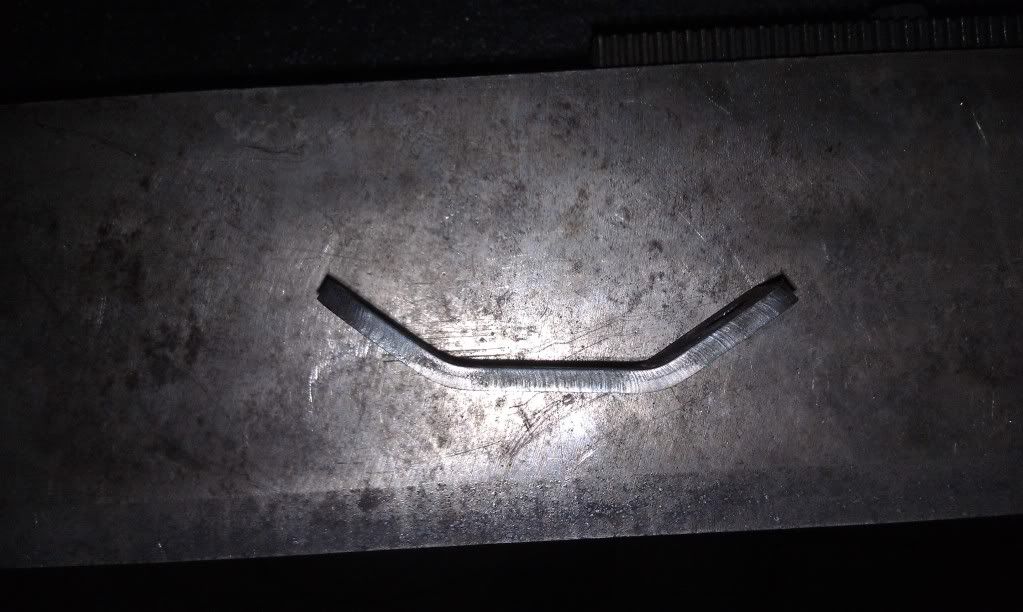

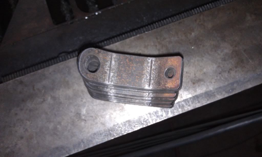

Okay.. I took that PDF and did a few sets really quick. I did make a couple small tweaks (to help in ease of production).
Instead of doing a 30deg and 35deg angle, I just bent both ends at about 32-33 deg. The difference is so small that I think it will still work. That allowed me to just set the stroke control on my brake to do both ends the same.
I also just bent both ends at 1.25" from the end... and I rounded the end off by the 5/8" hole.
Took 2 minutes of drawing.. 5 minutes on the plasma table.. and about 30 seconds to bend them (5 at a time).
If these work okay.. I'll cut/bend a few dozen and start including them with the caliper brackets on future orders.

I'm just glad some people will actually have parking brakes now. I'm tired of hearing the lies of line lock etc. The new brackets look great. I agree the slight production mods will work without issue. I have to admit it took me more than 2 minutes to do the pencil drawing but I wanted it to be complete.
