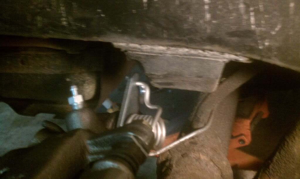

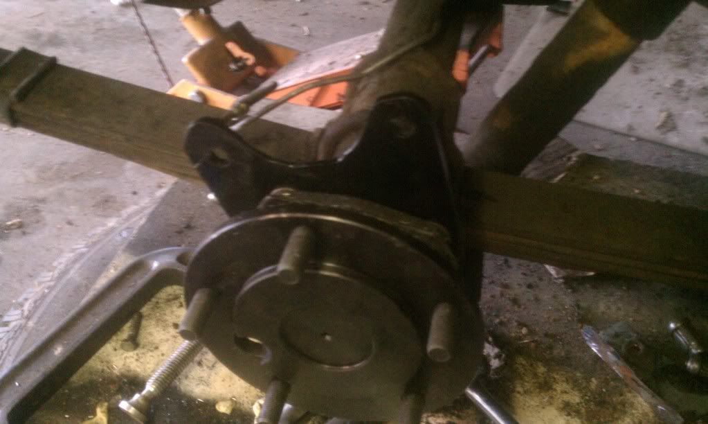

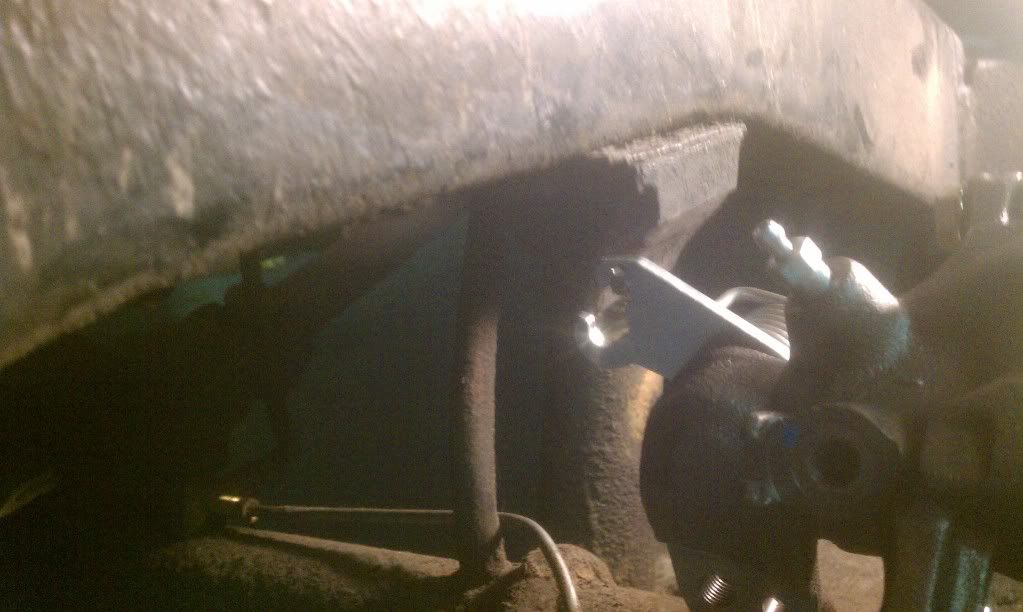

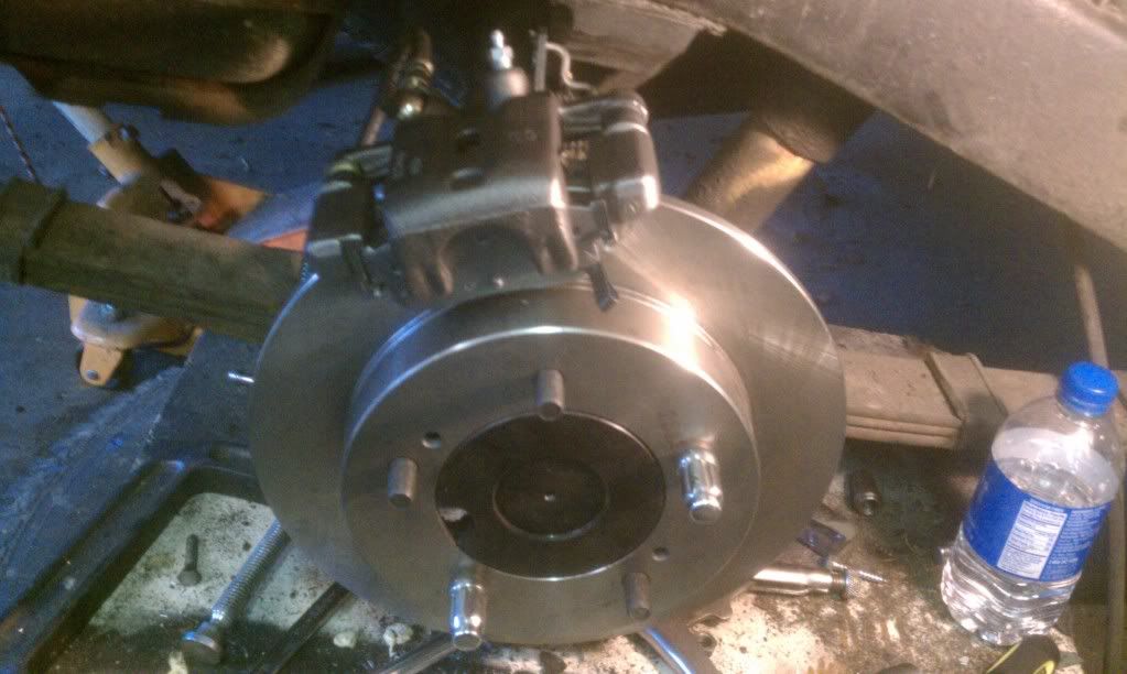

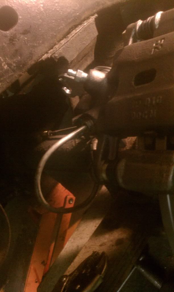

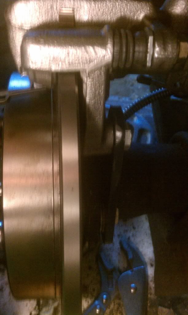

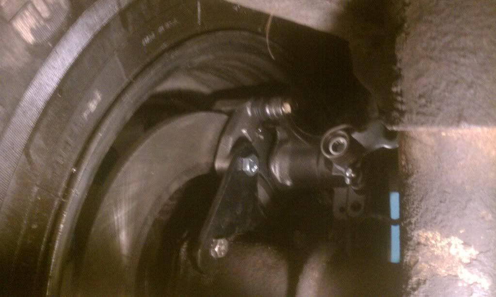

heres a few pics i only have the driver side done
i have a narrow track with no lift so it looks like i may run into some Clarence issues
also using the maxima caliber you can use a 3/8 hard line like the factory instead of the maxima soft line

Looks good. As for the clearance issue, can you rotate the bracket so the caliper is on the back of the rotor not the top?

yes but the holes wont line up, you will need to make the bracket that way or i can take the e brake off its not like it ever worked even after new lines

It looks like you DO have the caliper on the rear/back side. Where is your jack? (looks like its on the axle when you were looking at clearance) On the axle or leaf spring? Does it give you any more clearance from the FRAME when the wheel is on its not jacked up? I'm sure youve thought of that, but just in case.....I'm doing the same swap right now, haven't put the axle back under the jeep but I'm hoping I don't run in to clearance issues. Good luck.

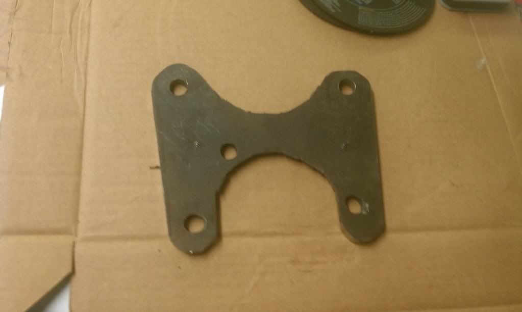

Hit me up via PM if interested.. still the same price.. $25 shipped. Think I've got about 5-6 sets on the shelf..
Edit: I cut these brackets regularly. I try to keep a half dozen sets or so laying around.
Also, if anyone is doing a one-off mix/match setup, feel free to hit me up for custom brackets. You'd need to supply the DXF File (if you have access to CAD).. or send me an accurate template from stiff cardboard/MDF/1/4" plywood..etc. Just make sure it's accurate. What you send me in cardboard, is what I send you back in 3/8" steel plate
I would imagine most flat caliper brackets can be done for about $20-$25 per set.. and ship via Flat Rate Box for $5-$10.. depending on size of brackets.

The plates that Eddie (BESRK) makes are sweet..Well worth the $25 for them. They line right up with the calipers..I may have it on backwards, not sure until I'm ready to put them on.
