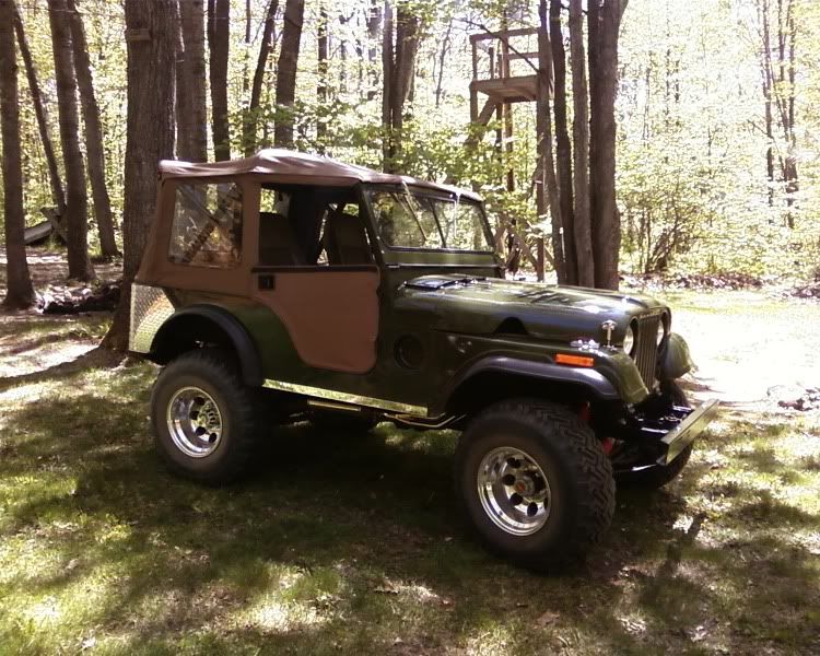

Looks like you have a lot of work ahead of you, nice progress so far though. I hope this can serve as some motivation to finish it..
My step dad's '53 M38A1:
'90 YJ with some stuff
I'm a pic whore, get over it.
