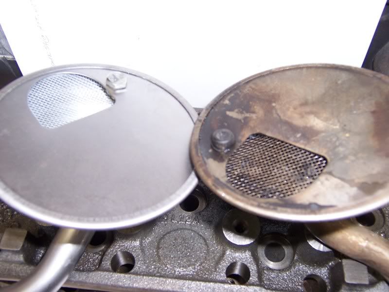

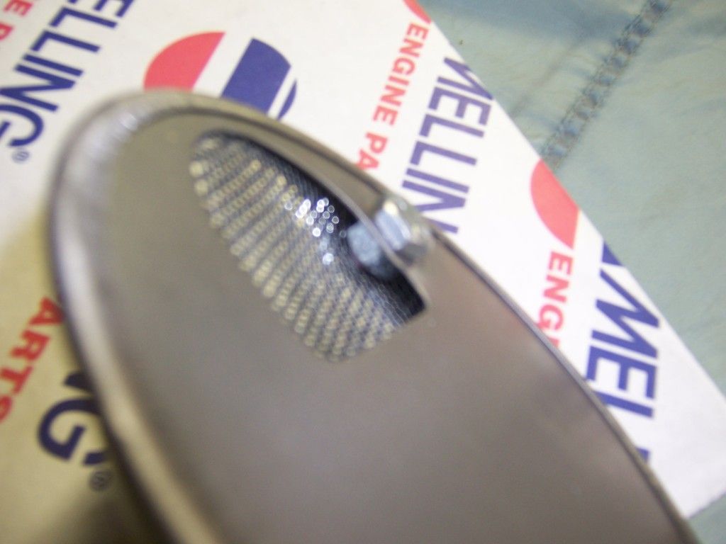

Get the little plastic nub that goes in the hole on the oil pick up screen. That prevents the pickup from sticking to the bottom of the pan.

It's easier to do something yourself than find one of them.
Just do something like this.
Beat it to fit, paint it to match!
Wheel, Wrench, Repeat.
