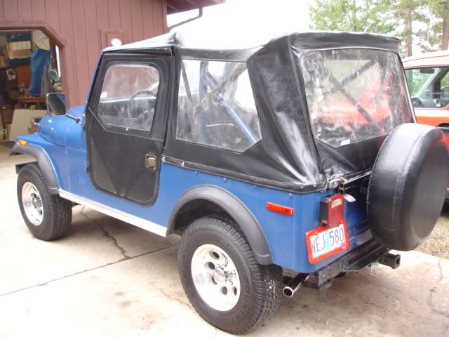

I thin the fender mounted ones also bolted to the side of the fender as well as the top of the fender well.
John is correct. I used to have a '79 CJ7 and the OEM roll bar was bolted to the top of the fender well and through the side of the tub utilizing bushings to space the gap to the side panel of the fender.
In the photo below notice the four fasteners just above the flair and below the top. These where part of the roll bar mounting.
