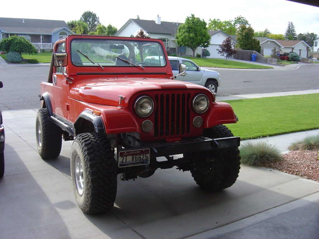

Here's two pics of my '84 CJ with a 4" lift and M.O.R.E. shackle reversals on 33" BFGs, no body lift. I hope this works, I'm a picture newbie here

Okay, sorry. I'm trying this picture thing again. I've had no problem with the shackle reversal. I think the biggest thing for nicer driving manners with a lift is making sure the caster is set correctly (I had the front axles shemmed), and the toe-in is correct. That along with a HD steering dampner. I also just rebuilt the steering gear and replaced the PS pump.
