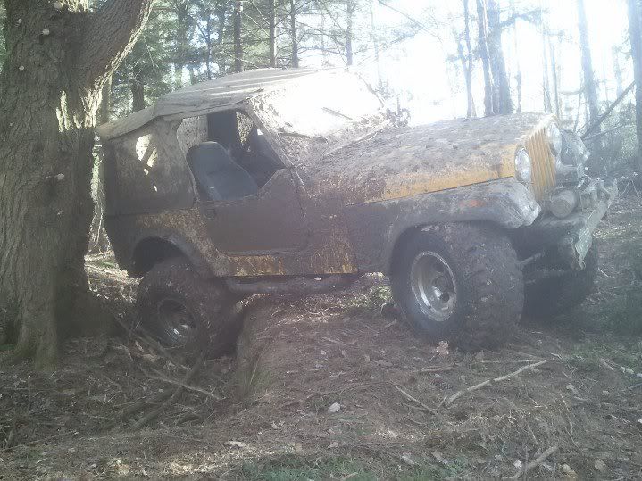

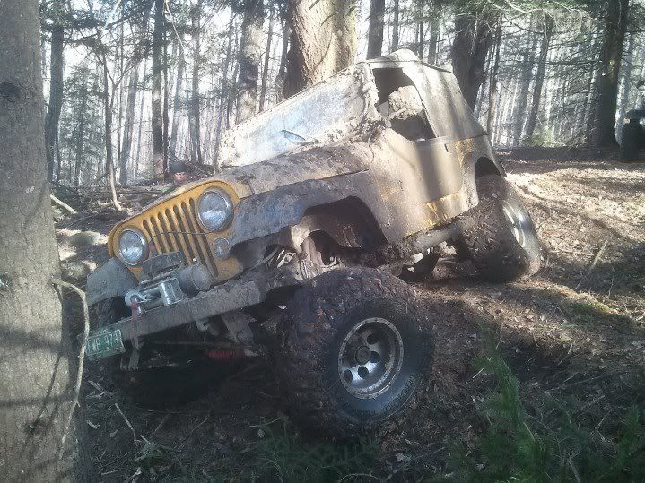

I'm running 4" superlift springs, 1.5-2" body and 1 1/8 drop shackles and I clear 36x14.50's just fine with a normal driveshaft. I had to have it lengthened and droped the transfer an inch.. Other then that no issues. Goes down the highway at 75 no problem..
