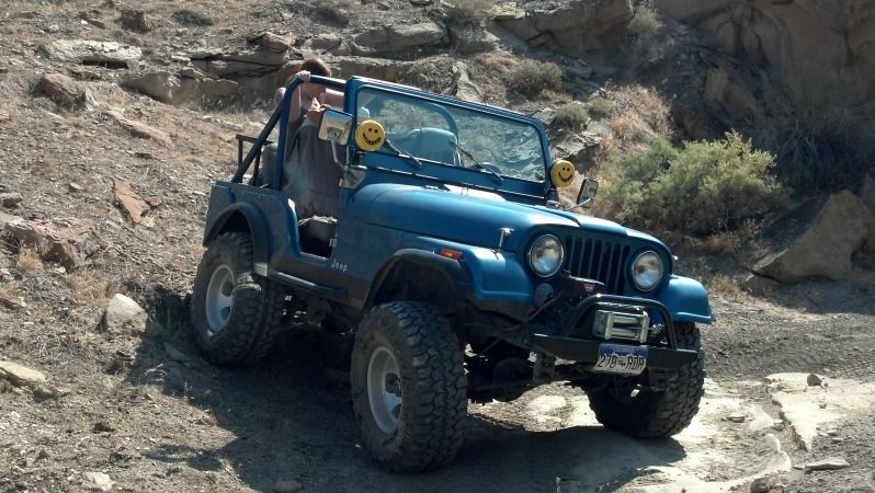

Read all 40+ pages of the OME 2.5" thread. Lots of good info in there. Many say it can't be done but I run 33x12.50-15 on my 2.5" lift with 1" over stock shackles.

I'm running narrow track axles with 1.25" spacers in front and 1" in the rear (due to the offset of my wheels). I rub, ever so slightly, in the rear. Not at all in the front. Extending my rear bump stops would cure it. I just haven't done it yet.

I have a glass body, YJ shackles (1/2" lift) and a 2.5" spring lift and have no issues running my 33x9.5 BFG at's off road.
