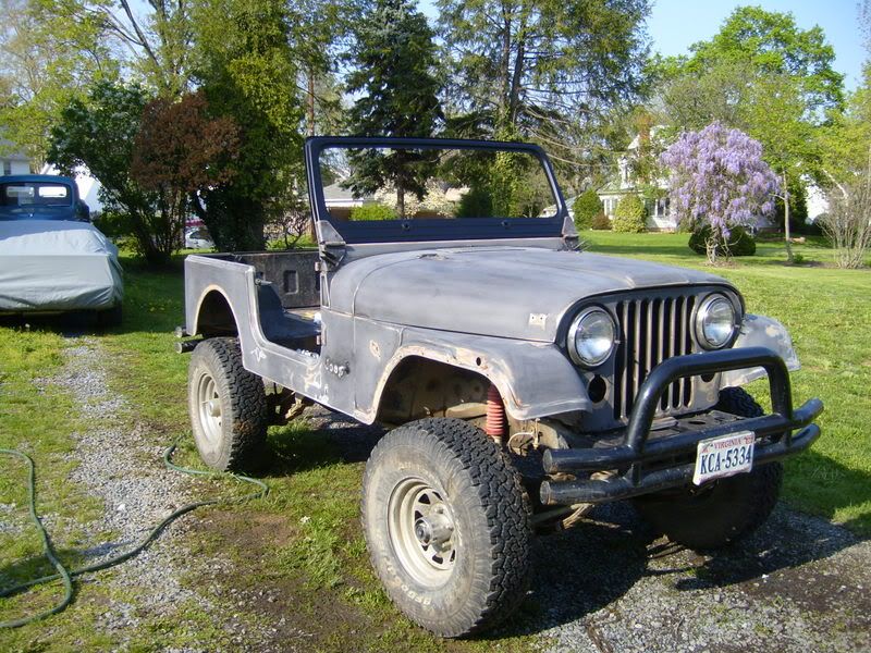

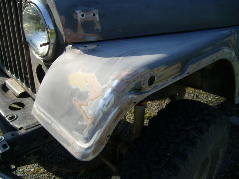

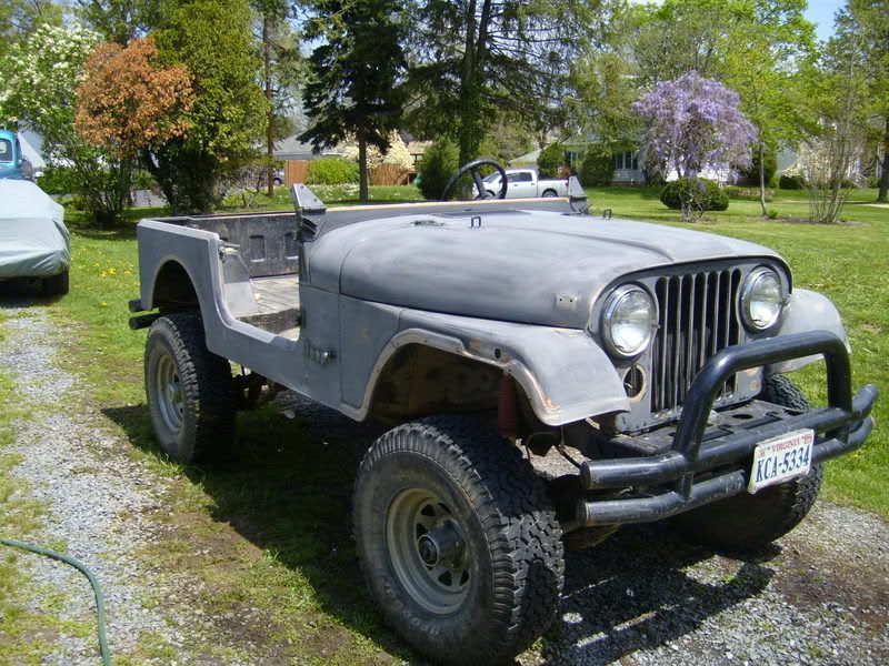

Yesterday I stripped everything off the jeep and today i got started on the prep work.
Joop
My new windshield frame was delivered mid day. old frame
tomorrow ill do all the body work and do the final touches on the sanding.

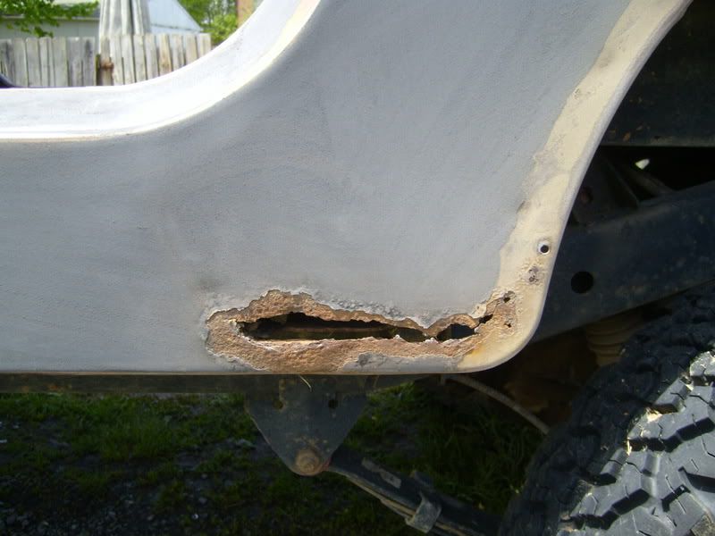

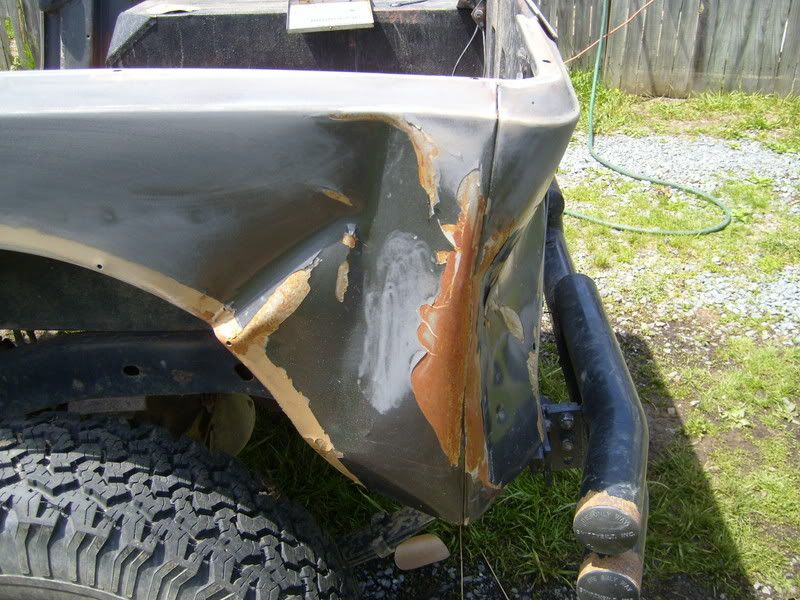

Im taking the easy way out on that corner. Cut it out and weld this up.
How are you gonna weld aluminum diamond plate to the steel tub?

I spent over a week on sanding alone. Patience! Rushed body work shows through even the most expensive paint.

very very true. thins coats, not thick as well. ive got like seven thin coats of paint on mine, before two coats of clear. the finish came out amazing! make sure to get ANY and ALL rust out of/off of the metal before your body filler or paint is applied. if not the paint will bubble, and hold in water.... causing more rust.. not good.

Yes, I had planned on finishing sanding in a day as well. Finally a week later I had it all sanded down to the bare metal to 320-grit, and she was smooth as quicksilver. I shot the primer, then ended up doing another weeks' worth of blocking because I wanted it to be absolutely straight. Every time I shot primer, I found more flaws, but finally I got to the point where I was happy and then it was off to the paint shop!

good call. i just assumed they were steel. The instructions even say CORNERS DIAMOND PLATE / STEEL as the title but then in the first sentence it says aluminum.

Just another comment on the corner issue you have going on there. Those arent even patch panels. If you do get those, they will hide whats back there but they are not a fix. This is what you need.
http://www.quadratec.com/products/22505_01_07.htm

I saw those corners and wanted to do that but i am no expert in body work. So i decided to jack the corner out get it back as best i can and put a diamond plate corner on it for now. My plan is after college in four or five years to replace my tub. by then it will be even more beaten up by my lack of experience on the trial.

If you can weld and you are just looking to cover and reinforce it for now- just have your local fab shop cut you some 10 guage to the height and length you need and bend and plug weld or rivet your own "crusher" corner. Just make sure to remove the rust and seal the damaged steel underneath to help retard the formation of rust at the damaged area.
