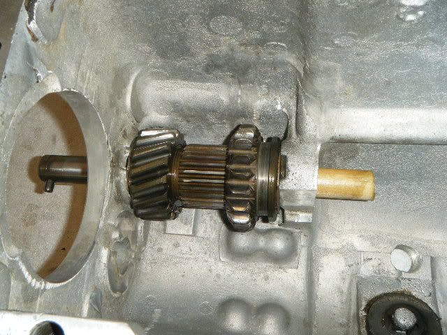

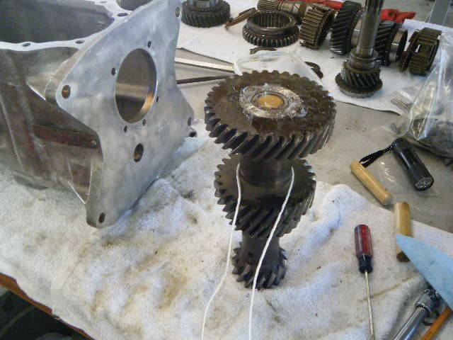

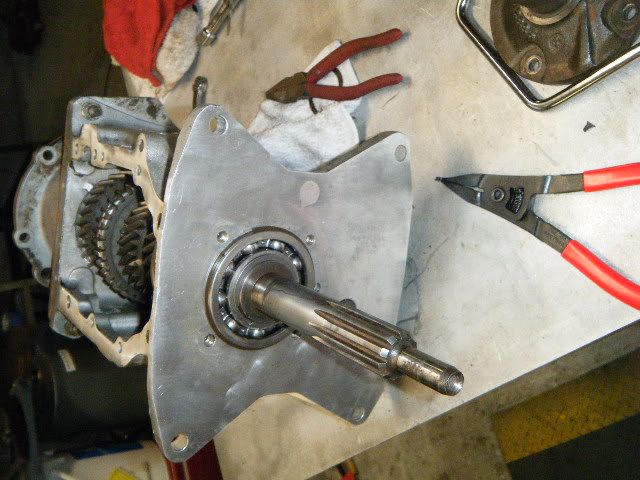

Productive day. Got the transmission 80% rebuilt. Still need to clean the tailhousing and replace the 2 oil seals, but the heat index got up to 105, so I called it quits a little early.
Special thanks to Yellow85CJ who PM'd me tips. Really made the difference in this thing going together without too much trouble.

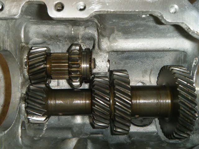

The Crown kit I ordered had plastic thrust washers. Now I'm not a engineer, but it goes against my grain to use plastic. My original washers showed little wear and measured the exact thickness as the plastic ones.
I bought some 5/8 and 3/4 wooden dowels to use as the arbor tool. Cut to fit in the reverse and counter shafts, soaked in oil and chamferred the edges. Worked like a charm holding the needle bearings in place.
Reverse and counter shaft installed to verify end play. Both were dead on and the dowel was punched back through to let the counter shaft sit at the bottom of the case to allow for main shaft installation. The string was used to help lift the counter shaft back up once the main shaft was in place.

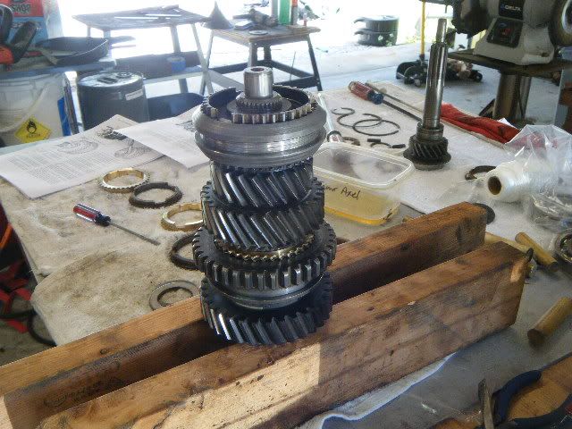

Main shaft almost ready to go back in. Took some time to get it in, but after some cussing, it dropped right in.
Bearings pressed on smooth with no popping or creaking. Snap rings were a huge PIA. Shaft springs I was able to get without snap ring pliers, but the bearing snap rings, no way. Stopped by sears and picked up these pliers and installed the rings in 10 sec. Ran through the gears and everything worked like it should. Tomorrow, install the oil seals, clean the tail housing and go through the and clean/inspect the shifter.

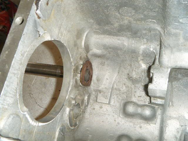

Well, ran into a roadblock on the shifter. Once I cleaned all the gunk off, found a crack at the shifter fulcrum. Thought about going with JB weld, but with the soft aluminum and the location, doubt it would hold very long. Besides the crack, the shift rail seats had a good wear grove starting. At least the shifter cover is easy to find on line.
The PO must have been speed shifting! At least it isn't your adaptor plate. We have that problem... it's been brazed. Hopefully it will hold. I have no doubt that you won't have any problem fixing it.

When I bought my jeep the shifter was cracked like that. The PO tried to weld it but it didn't work.
I found the shifter cover at Collins bros for like $200 but then found a whole t176 on ebay for $175 shipped. Collins bros was out of stock anyway.
The other day the tailshaft broke on the trans and I had a backup.

Tried EBay, but nothing worthwhile. Ordered shifter housing plus some additional small parts from Rompalicious.com. I've used thier site a few times before and it's becomming my first place to look for parts. Cheaper on most parts plus free shipping and no taxes.

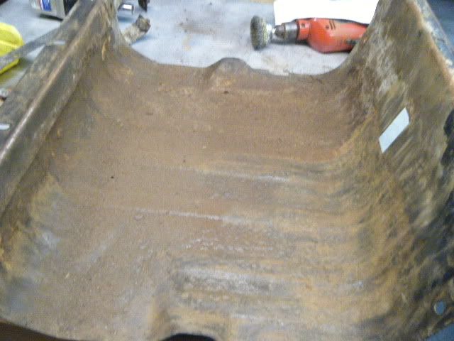

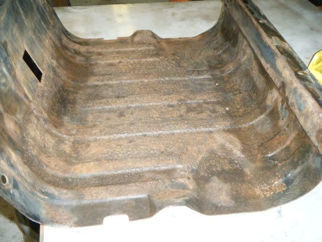

Shifter and parts came in Tuesday. Pretty quick considering I placed the order on Sunday Evening. Fit perfect and installed without any major issues. The rebuild made a huge difference as the shifts are smooth and the shifter is nice and tight.
Began piece milling the parts for a power steering upgrade. Found the pump, steering box and mounts on e-bay and picked them up for a fraction of new parts. Still need to order a double pulley and a few other parts.

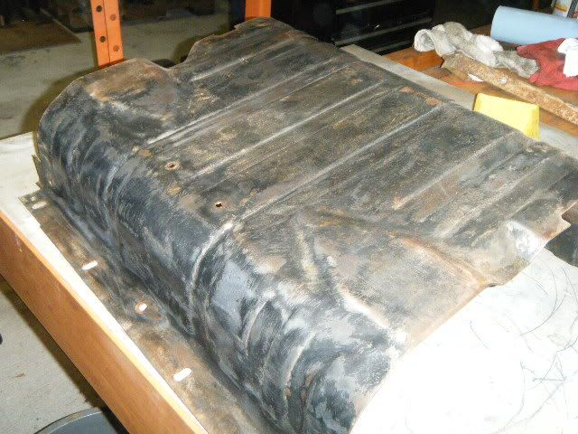

Spent most of this afternoon and evening wire wheeling the gas tank plate. What a PIA. Finally got most of the rust and rubber coating off and still need to remove the paint, hit is with Ospro and it'll be ready for paint and prime.
Wire wheeled half way through. Even though the rust pits are big, the metal is still strong.
One side wheeled and a little wet from washing all the gunk off.
Outside of the plate. No pitting and mostly cleaned up.
