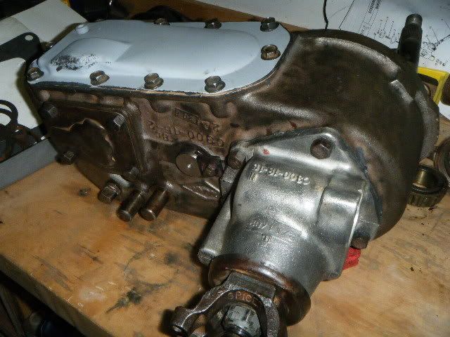

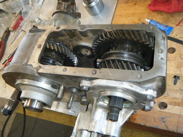

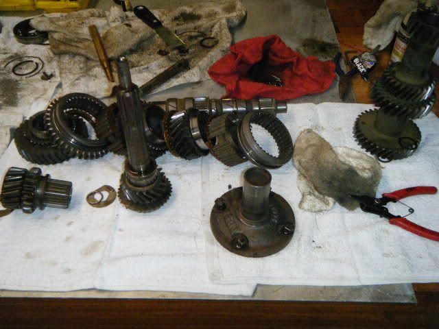

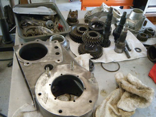

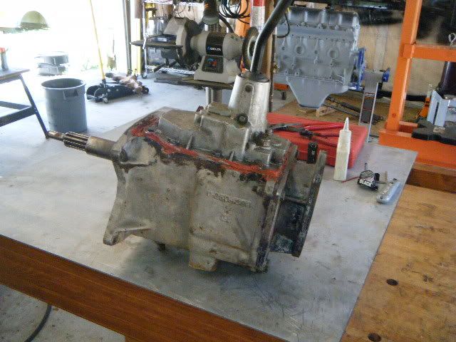

My transfer case is finished, except for paint and got started on the transmission rebuild.
I was a little apprehensive about rebuilding the transfer case, but it really wasn't too bad. The only lesson learned i can provide others is to not rely on only the FSM. It's good as a general guide, but weak on specific how to's. Any time I got stuck, this and other sites proved invaluable. The Terra Low instructions on JBConversions really came in handy dealing with the shift rails. Installing them in the support first and then installing the support and feeding the rails into the forks was so much easier than the way the FSM directed.
Original condition.
Cleaned up and ready to rebuild.
Almost done. Next is the intermediate gears. Thought the needle bearings would give me a lot of problems trying to keep them together, but turned out to be no issue.
Finished product. Needs a good cleaning and sealant trim and it'll be ready to paint.

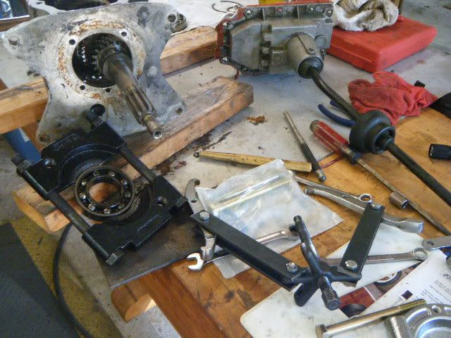

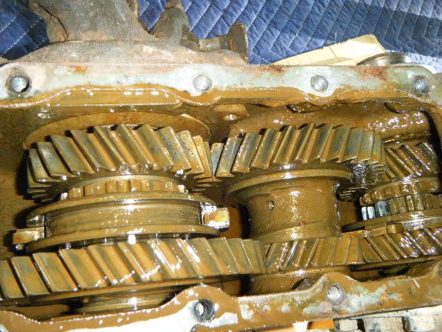

Got started on the transmission. It was in much better shape than the transfer case and probably has been rebuilt once or twice before. Decided to rebuild it just in case. That way, if something screws up with it, there will be no one to blame but me.
Original condition.
Front and rear main bearings came out without too much of a fight. Only problem I had was my puller was too short for the front bearing. You can see the mod I did to my puller. Worked like a champ.
Gears all cleaned up. Case is soaking. Last person who rebuilt this tranny worked under the adage of the more sealant, the less it'll leak...Overnight in the parts washer will make it easy to scrap off.
