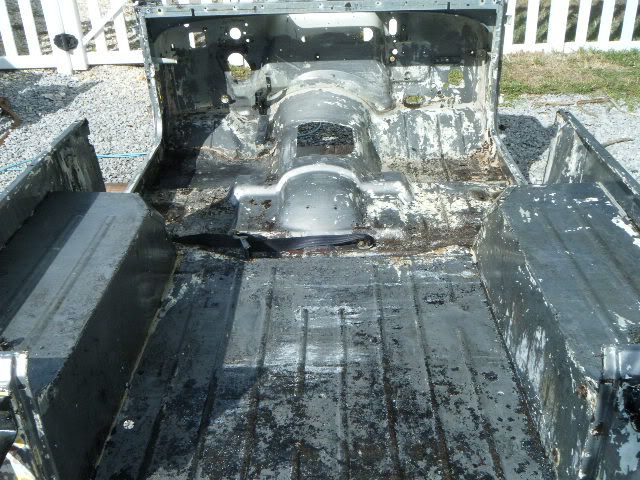

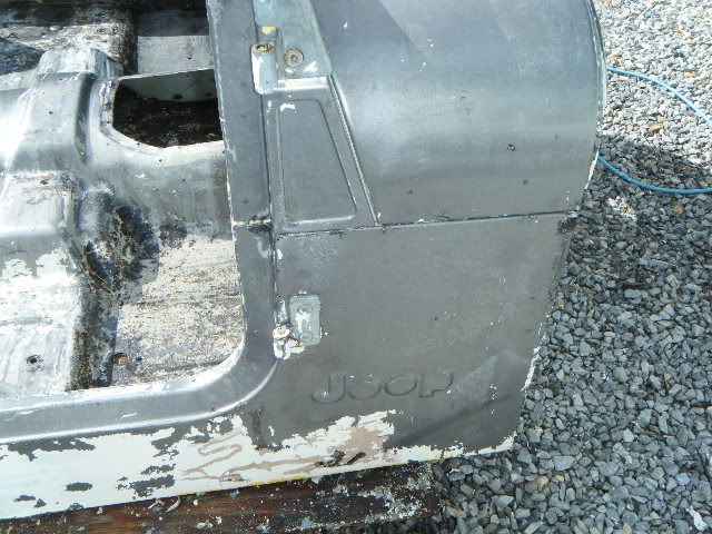

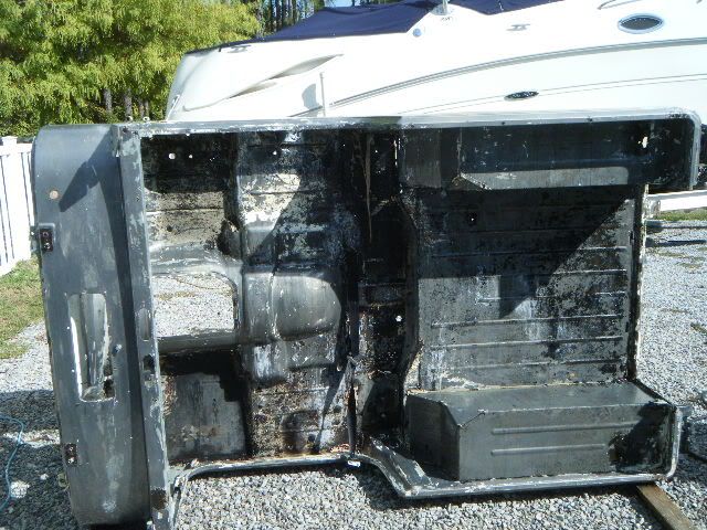

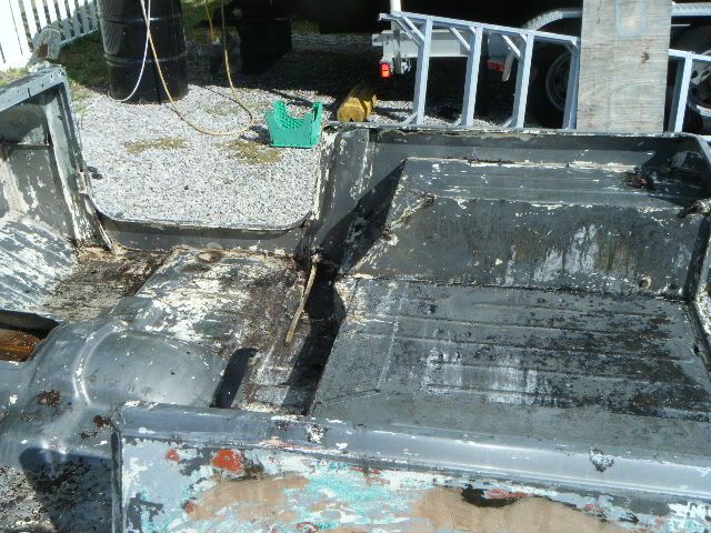

Spent the day stripping paint. Got just about all the tub coating and paint off. I can better see some of the problem areas. Once I got it stripped, I hit the entire tub with Osphro to stop any rust and protect it from building new rust. When it dried, I moved it into my garage. If it starts to flash rust, I have some rattle can primer I can shoot on it until I work that area.
The left rear fender has some serious bondo. I think with a little patience and persuasion, most of the fender can be worked out with just a little metal replacement.
Drivers floor pan is the worse area. The passenger and rear pans will need some metal. The bed, other than one section of the on top of the left wheel well where the corner panel well is in good shape.
Both Passenger and driver side have some rot below the door step.
Firewall is in really good shape.
Drying off and ready to move inside. Now the real work begins.
Need to do a little research on all the work by other members on the best way to start repairs. Plenty of great pics and posts to help me out.

post #157 of 730 Old 10-31-2010, 05:33 PM
SonicR1
Location: CenCal
Posts: 1,513
The pics make it look like a lot of surface rust, but nothing too major????

post #158 of 730 Old 10-31-2010, 06:43 PM Thread Starter
Eaglekeeper
1986 CJ7
Location: Panama City
Posts: 828
The lighting is a little deceptive. I think what appears as surface rust is the dried Osphro before I washed it off. The rusted areas are the dark black that the Osphro converted. Everything else is clean metal, which surprised me. I expected a lot more problems.

post #159 of 730 Old 10-31-2010, 07:06 PM
CjAl
1980 CJ7
Location: Texas
Posts: 658
that tub is in fine shape. All these CJ7's rust in the kick panel where the C channel support is flat against the sheet metal.

post #162 of 730 Old 11-01-2010, 12:00 PM
CjAl
1980 CJ7
Location: Texas
Posts: 658
the two piece design is CJ& factory original. I don't know why, some say it's to reinforce the fender. There was aftermarkets for awhile years ago that didn't have it but the ones I see now have gone back to it. It's a serious rust trap in every CJ. I tok mine off yesterday and one blow with the end of the ratchet put the handle all the way through both panels. And the rest of my jeep has VERY little rust.
YJ fender are longr then CJ7, TJ are different all together
CjAl is offline
