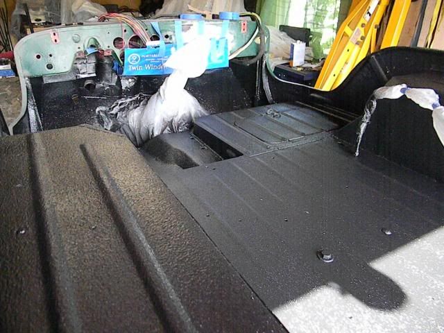

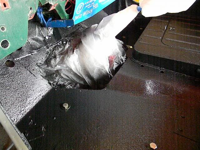

Got the bedliner sprayed today. Sanded everything down with 80 grit, then washed it with soap and water. Looks alot better I think.
Before:
After:
Next is to paint the cage ad put that back in! then on to wiring.

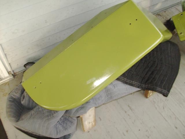

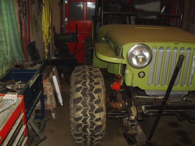

Finally stopped working long enough to take a couple pics of the color. For whatever reason it is very hard to photograph and have it look like it does in real life. It tends to be yellower than it does in person. Finished up one rocker guard as well
Anywho, heres the pics.

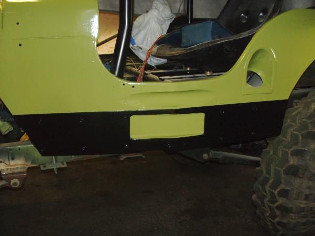

Drivers side rocker guard. Its sandwiched between the frame tie in plates for the a pillar
Passenger side rocker guard

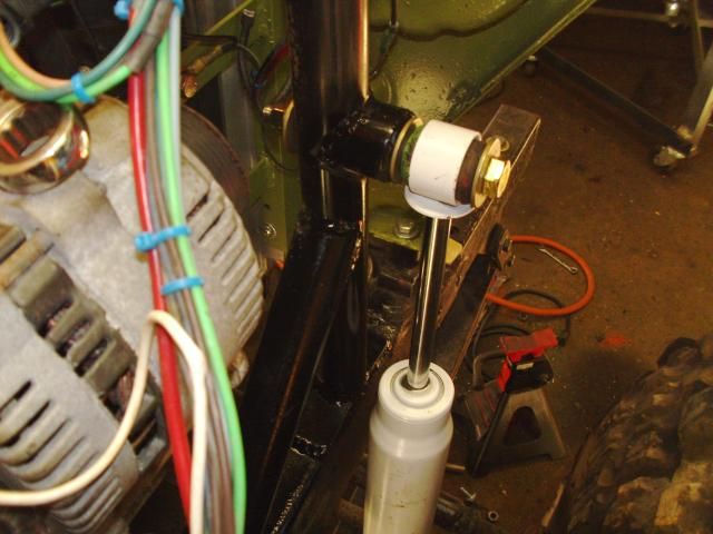

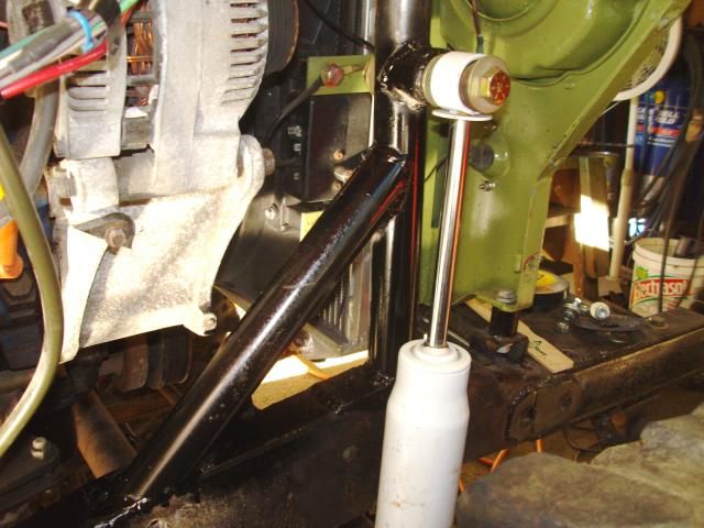

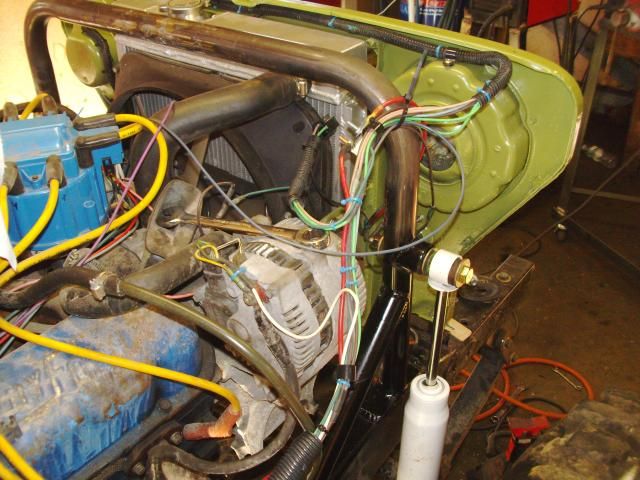

Built a hoop to help protect the radiator, but also needed something to hold the upper shock mount. Everything is .120 wall. Plated the frame under the main hoop as well.
Built a "stub" off the main hoop, welded a 1/8 inch thick grade 8 washer to the front of it and drilled all the way through the main hoop for the shock mounts. Pics to better explain.
Ended up using some 14 inch travel rancho's. I know 14 inches of travel is overkill, but I got them for free from a friend of mine, and they were brand new in the box. They just needed bushings as he lost the ones that came with them.
As always open to comments!

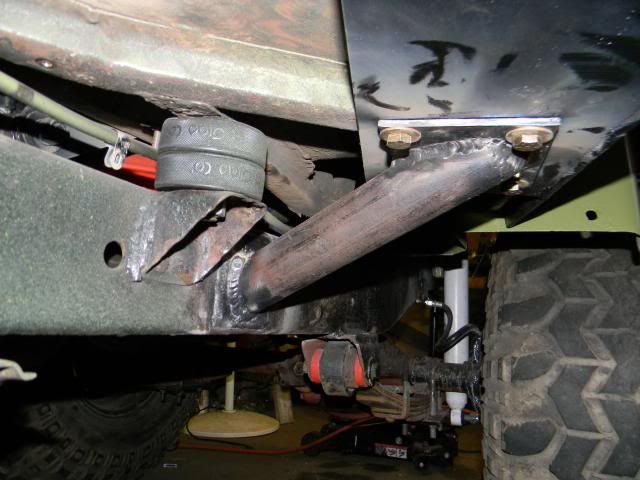

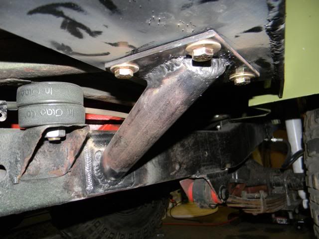

Finished up the passenger side a pillar frame tie in. It sandwiched the rocker guards and the floor between the foot plates.
The frame has a plate welded on for support. its 1/4 inch, and both plug welded (5 1/2 holes) and welded around the perimeter.
Yes, those are hockey pucks. They are cheap, and plentiful.

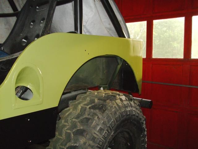

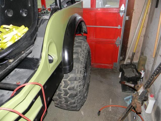

OK, so I am also having a hard time deciding whether or not to run the rear flares. I am planning on adding 1.5 inch wheel spacers in the rear.
With:
Without:
Opinions on the flare situation? My state is not real bad about tires sticking out, but it does come up from time to time

The flare looks great - I'd go with them.

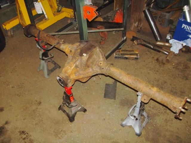

more progress, swapped in a scout D44 front, rear to follow
You can kinda see the track width difference between the front and rear in one of the pics. About 7-8 inches or so.
Heres the start of the ourboard brackets. I still need to box/gusset them, but ran out of ambition (it was about 10 degrees outside, so it was about 50 or so in the garage)
Heres the "new" scout D44 rear
And the shackle angle I was talking about in the other thread (opinions?) It seems to work great for mostly down travel which is what I need

Got the rear scout D44 all swapped in. I decided to bite the bullet and swap in the link set-up from the other axle.
Also decided that scout backing plates and drums are way to damn expensive, so discs here we come.

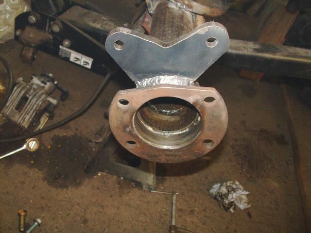

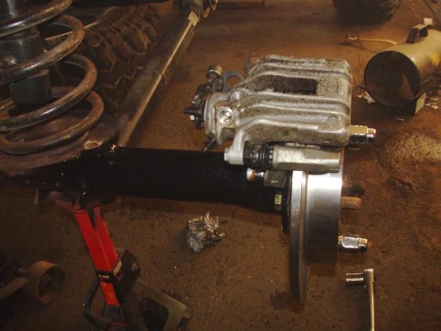

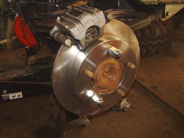

Got one side of the rear disc swap done!
I cut out the brackets, then bolted them up to the caliper. I used a c-clamp to engage the e-brake to center the caliper on the rotor and placed heavy tacks on the bracket. Then removed everything including the axle and burned it in.
The bracket didn't come out as symmetrical as I would have liked, but the holes are evenly spaced and the caliper sits level on the rotor, so I guess thats what matters
The bracket is 3/8 thick. Should I add a gusset or two?
The Volkswagen calipers seem to fit perfectly on the tracker front rotors.

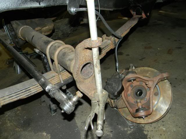

post #104 of 111 Old 03-05-2014, 06:21 PM Thread Starter
98blacksahara
1951 CJ3A
Location: Littleton NH
Posts: 663

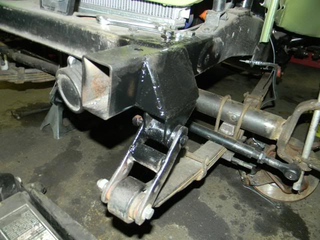

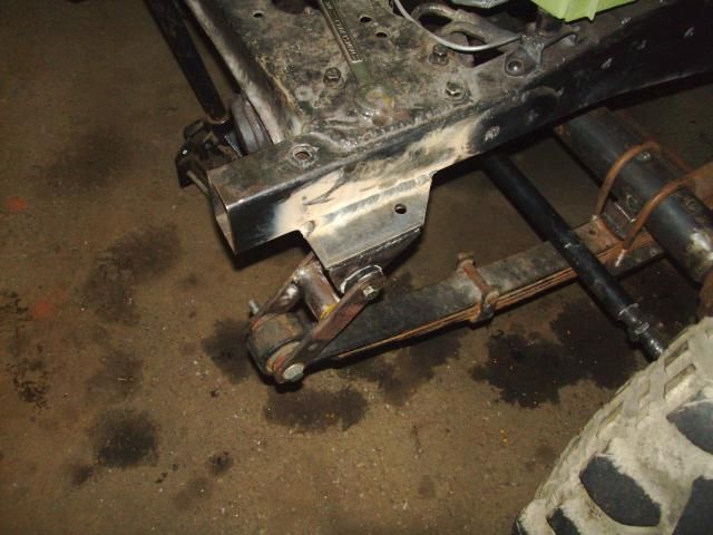

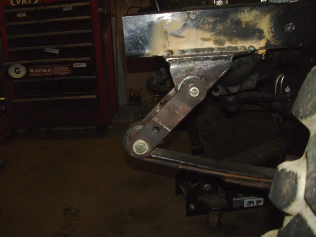

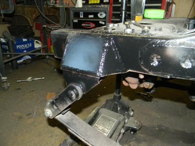

Finally got over the flu enough to get something done. Managed to finish up the front spring outboard brackets, get the new extended brake lines installed, and started to set the caster on side.
Not sure why it looks like I painted it blue.... its really black
setting caster.
Any opinions on what to set the caster to? I have read between 6 and 8 degree's, but have also read, the larger the tires, the less caster you want.

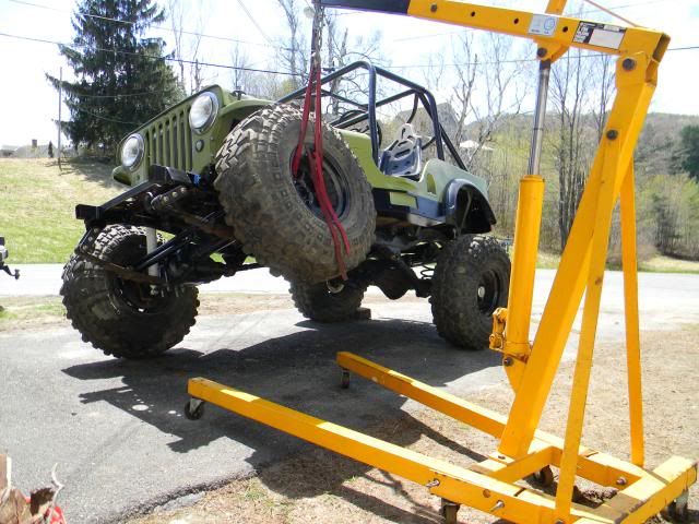

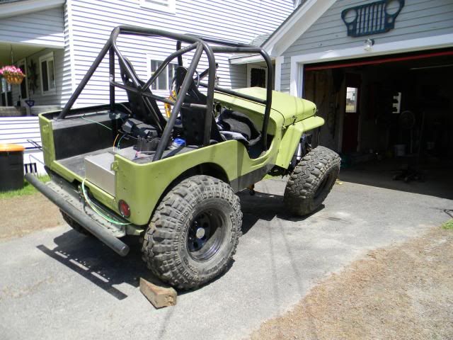

Dragged it outside for some poser shots. It has more flex in it, but after breaking two straps and maxing out the engine crane, I called it close enough.
Also shown is the new steering, 1 1/2 DOM with Chevy "1 ton" tie rod ends. Flipped the tie rod to the top, otherwise the pass side wouldn't clear both rod ends.
