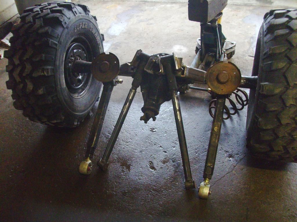

Finally got to the shop to work on the rear axle truss and its almost finished. Its tied into the diff cover via a removable plate. Should be rugged enough for the tire size I am planning.
Pics:
[IMG]http://sphotos-a.xx.fbcdn.net/hphotos-ash3/528213_537762472913386_564538714_n.jpg
[/IMG]
[IMG]http://sphotos-b.xx.fbcdn.net/hphotos-prn1/533183_537762746246692_1666712017_n.jpg
[/IMG]
As always, comments welcome!

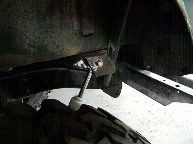

Got one rear shock mounted, here is the upper mount, built off cage tie in
Shot from the back.
I am able to use all of a 12.5 inch travel shock. I could go more, but the spring unseats, so its kinda useless.

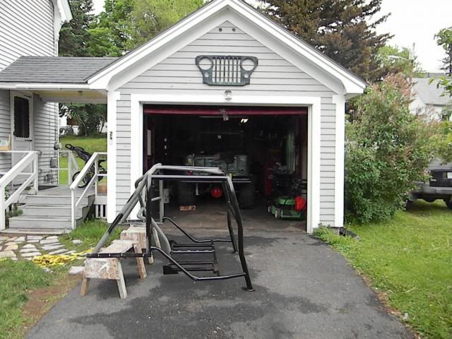

Pulled the cage and finish welded it. Started priming and painting it as well
and finally, one shot of the new shop/garage. Its a mess as I am still organizing (between working on/painting the "new" house)

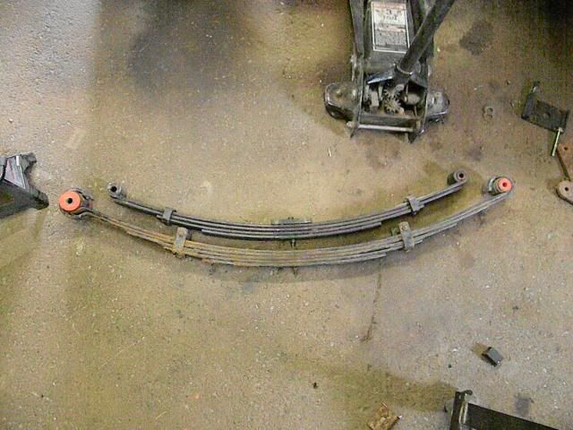

Finally had some time to get into the garage and get something done.

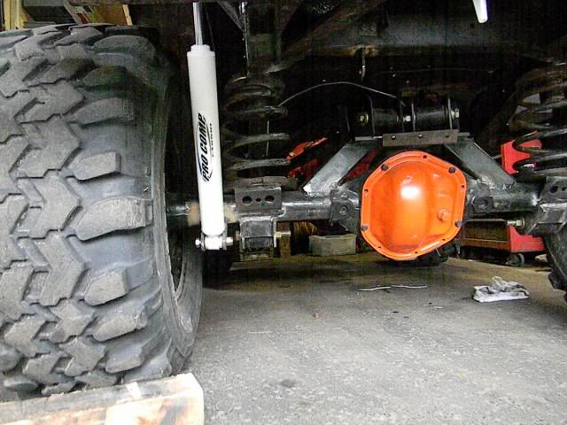

While back I picked up a set of 2 1/2 lift springs for a late cj7. Got em slung under the rig yesterday. Seems to be softer already.
Pic comparing the 2

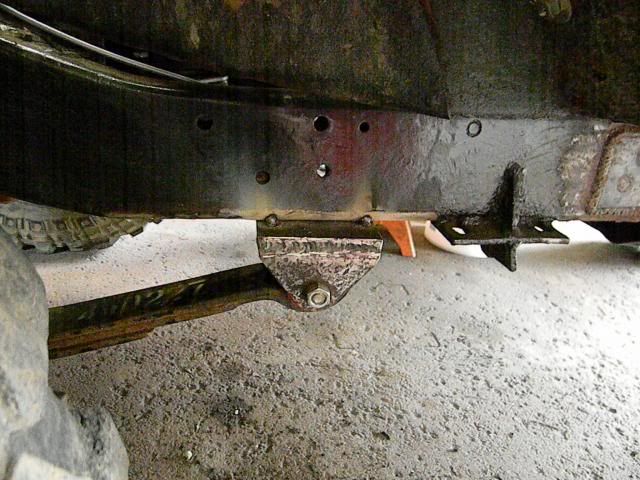

New main hanger tacked in place (not sure why it looks textured in the photo)

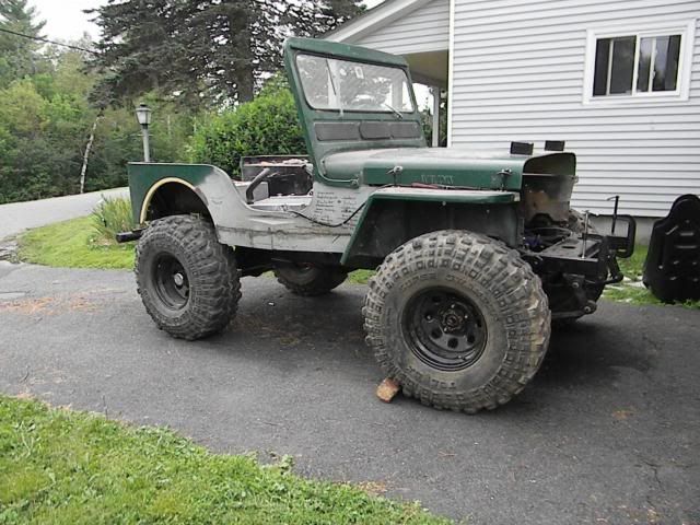

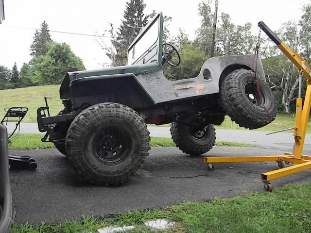

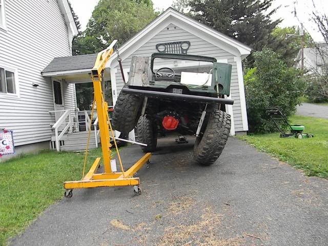

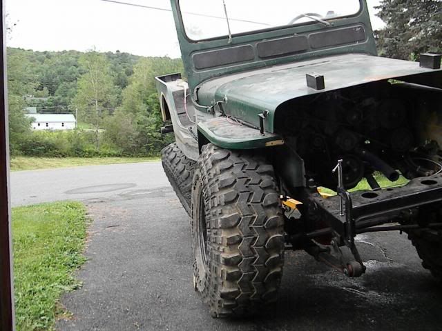

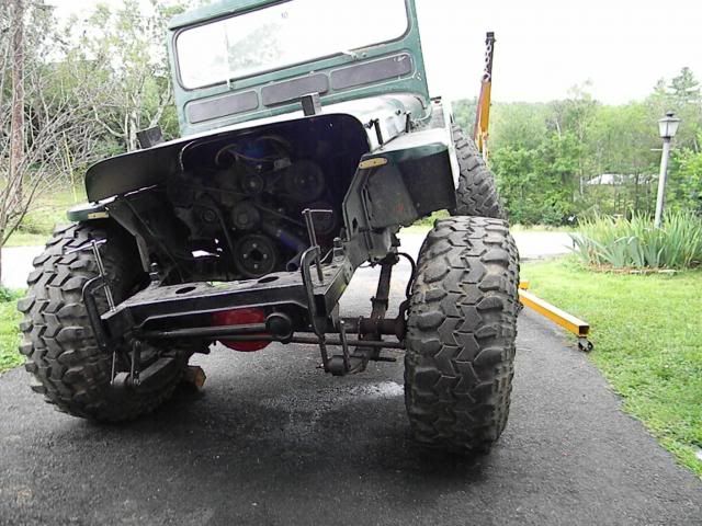

Pushed it out of the garage today for some engine crane poser shots to see how everything works with the new springs.
Couple shots at ride height on 36's

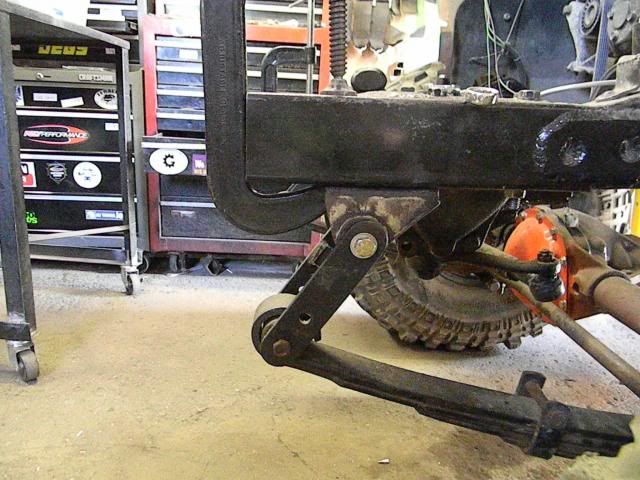

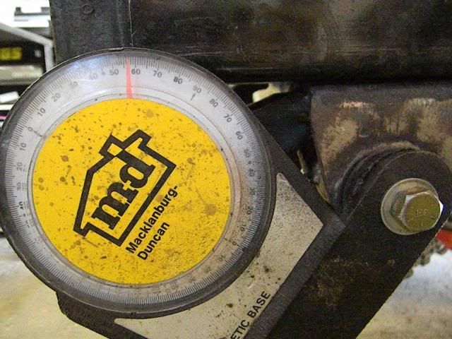

Posts: 663
I think I got a pretty decent shackle angle. Open to opinions though.
I will not be using the shackles shown. I am only using them for mock up until I can get to the steelyard to get some 3/8 flat stock

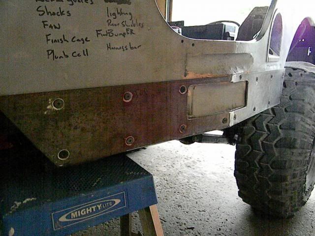

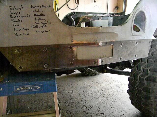

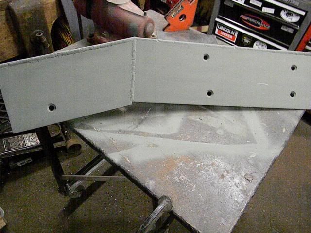

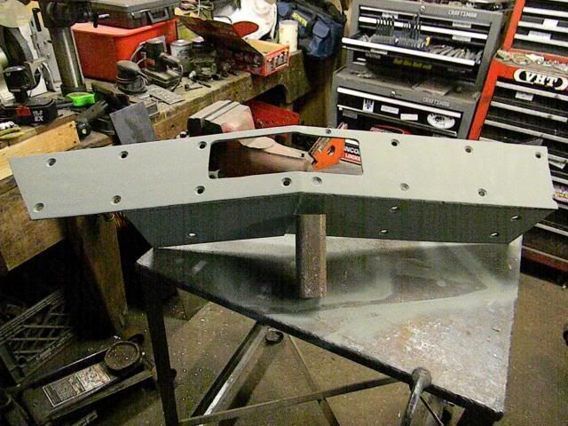

Got one rocker guard almost completed today. Its made out of 3/16 x 6 inch plate. Countersunk the bolt holes. Will be tied into the cage frame tie ins for support.
Pics of it on the heep:
Two halves tacked together:
Finished welding and primed with self etching primer:
I still need to make sandwich plates for the inside of the tub. I will probably use 3/16 or 1/4 by 2 to make those.
