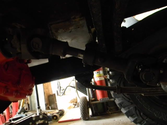

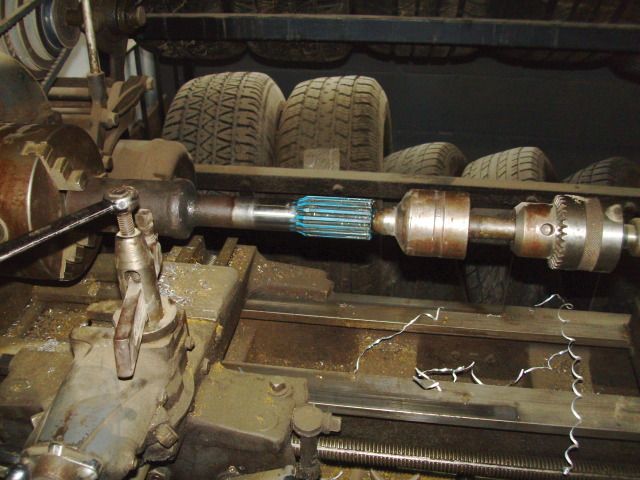

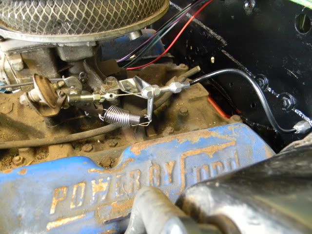

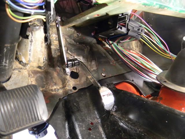

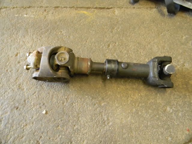

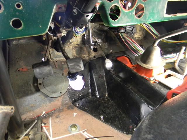

Had a couple hours to putter on the old girl yesterday morning. Got the throttle hooked up, and the rear driveshaft we made installed.
Throttle brackets and cable:
Comments welcomed on the cable itself. I may change it to a longer "loop" before it enters the bracket.
Here is the installed pedal. In a nice comfortable spot, and I can rest my foot on the center hump on bumpy trails.

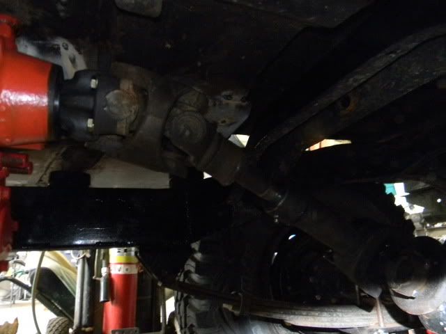

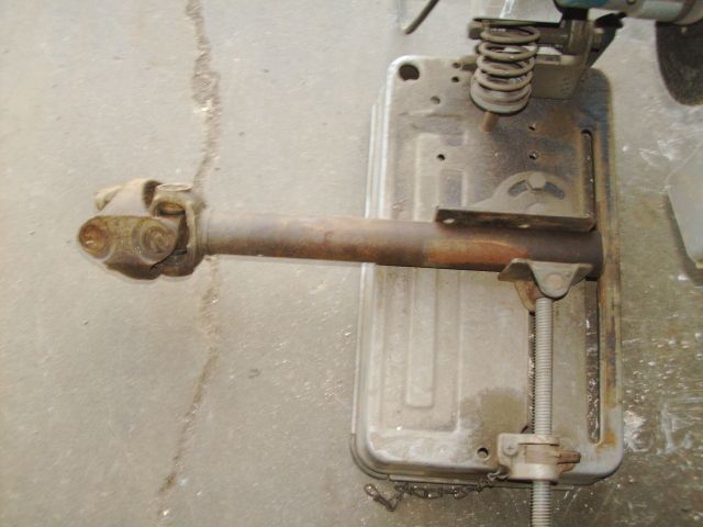

Here is the driveshaft. It started life as a front from a cherokee. Had to change the output yoke for the dual cardan style
Installed pics, I may shim the t-case down a bit to lessen the angle a tad. Comments welcome

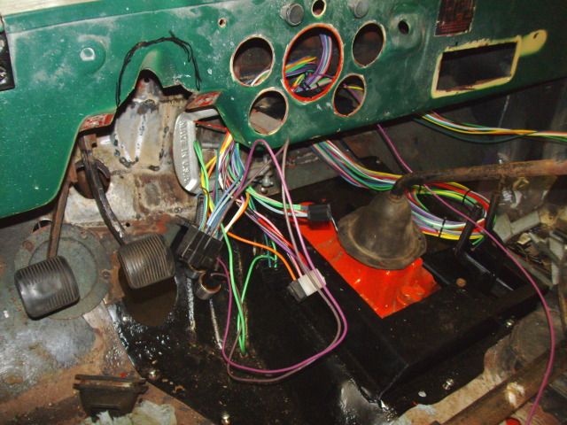

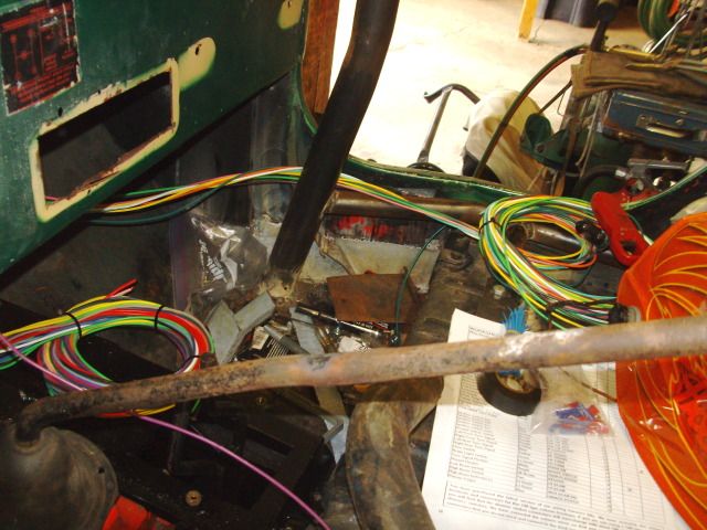

Anywho, started in on the wiring. Summit brand "painless" harness. Awesome product!
We also made a rear driveshaft out of an XJ front.
Finished product:

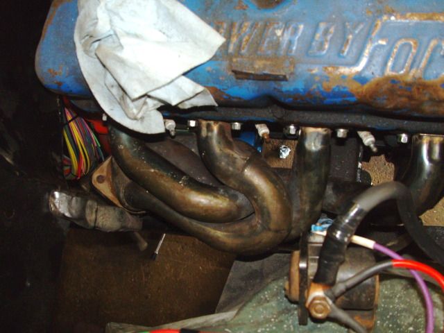

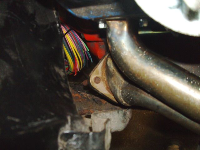

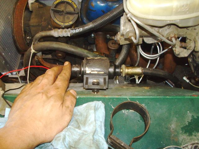

Had to buy two sets of headers to get one that fit each side. Pass side is a Foxbody mustang equal length shorty, Driver is a blockhugger center dump
Pics:
Fuel pump on the fender:
Unfortunately, it already took a dump.
