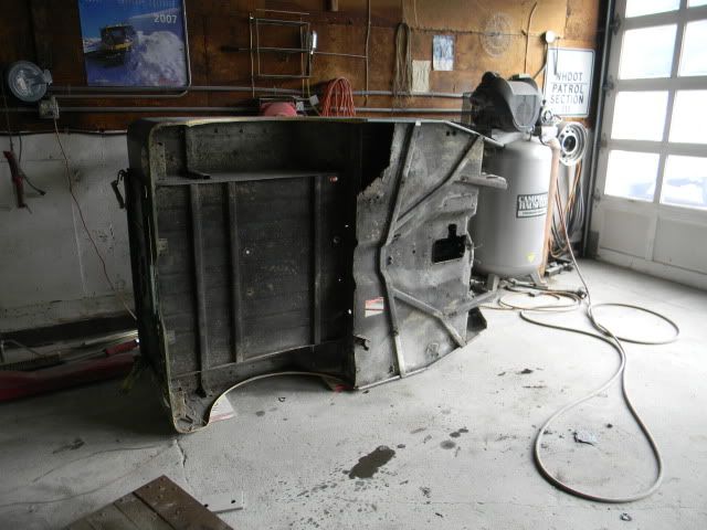

Made a mess err..... some progress today. Got the tub pulled and got most of the floors fixed.
Here is the tub coming off
Tipped 'er up and fixed the floors under the tool box. I cut out the really rusty stuff and put new thicker sheetmetal over existing good metal. Did a bit of spot welding it together, then stitched most of the edges. I know its not exactly the most perfect way to fix it, But it will work. (besides, I did it the right way on my other one...)
No pics of the patches yet (I forgot)
Here is how I left it till next week.

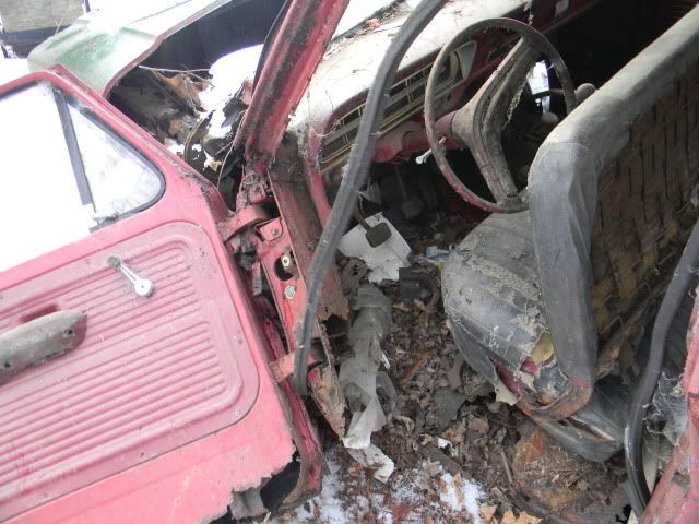

So it turns out the free t18 is actually an NP435. No it worked out a little better (lower first gear). here is a couple pics of getting the tranny.
The truck has been sitting since the early 80's
The floorpans were rusted so we just pulled on them and tore em out
Here it is upside down and cleaned up and primed
