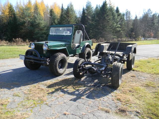

I recently bought another flatty. A 47 cj2a. Its still sporting the original L-head (which will be staying) a t90 and a d18, for axles its got a 19 spline tapered 2 piece D44 rear and a D27 front from an early 5. It on some 33's which will also be staying.

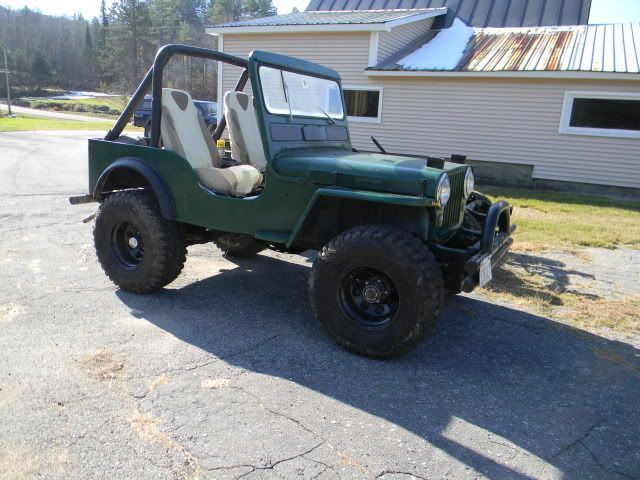

Here's some pics (also shown is my 51 cj3a resto project)
I am planning on swapping the t90a for the slightly better (lower) geared first of a t90c, which I already have the parts for. For a transfer case I will be using a hybrid d18/d20 set-up for twin sticks that will allow independant use of either axle.
I will be swapping to a later flanged D44 from a cj5 and a disc braked D30 also from a cj5. Both with 5.38 gears and lockers.

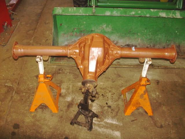

Started working on the centered, flanged Dana 44 rear today. Plan is all new bearings, races and seals. And a 5.38 ring and pinion set.
Of all the places that I have found Mouse nests on/in a jeep, I have never seen one in a brake drum. Pics of the nest after I cleaned it out
Axles all taken out, Nice and beefy for a light little Jeep.

Got a little more work done i=on the D44 rear today. Ring and pinion installed. Got a good gear pattern. Got the housing primed and cleaned up and primed the brake backing plates. Here's the proof.
