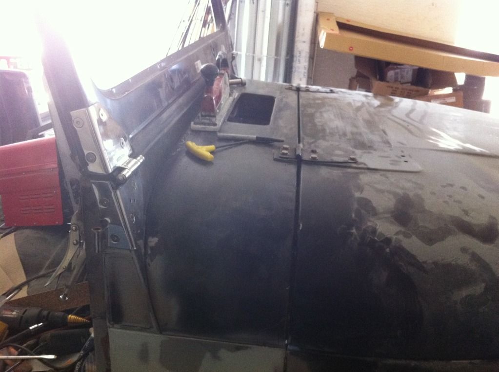

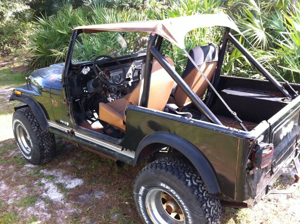

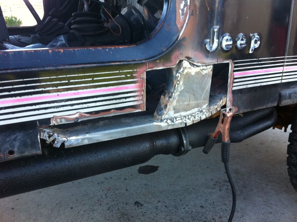

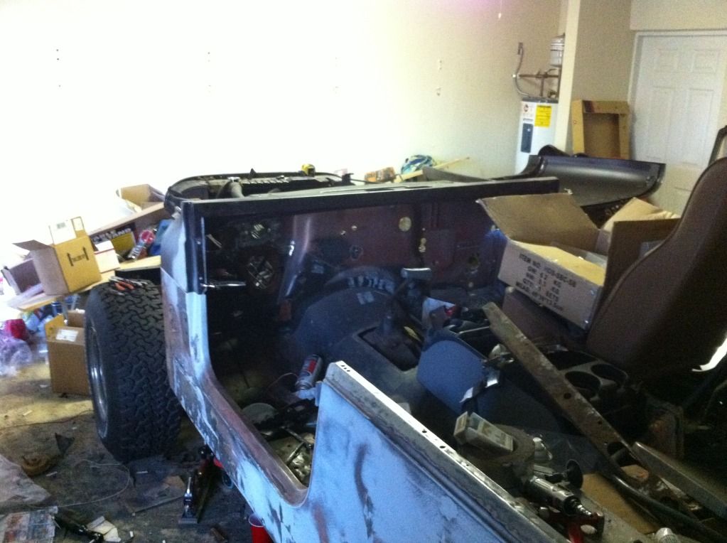

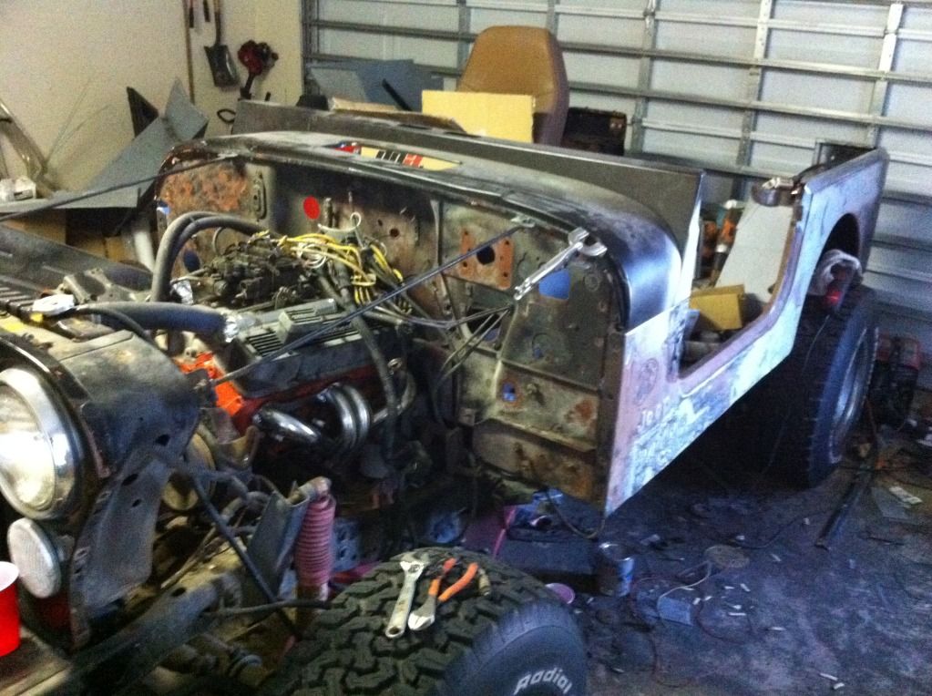

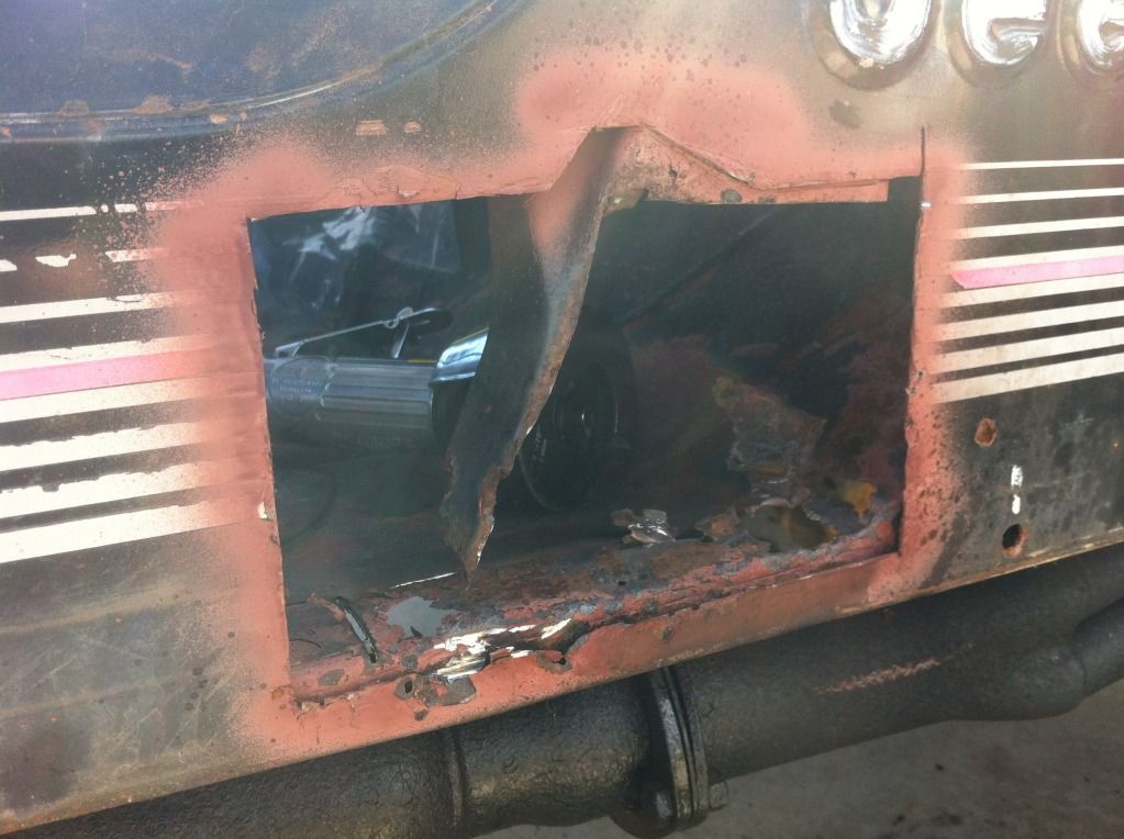

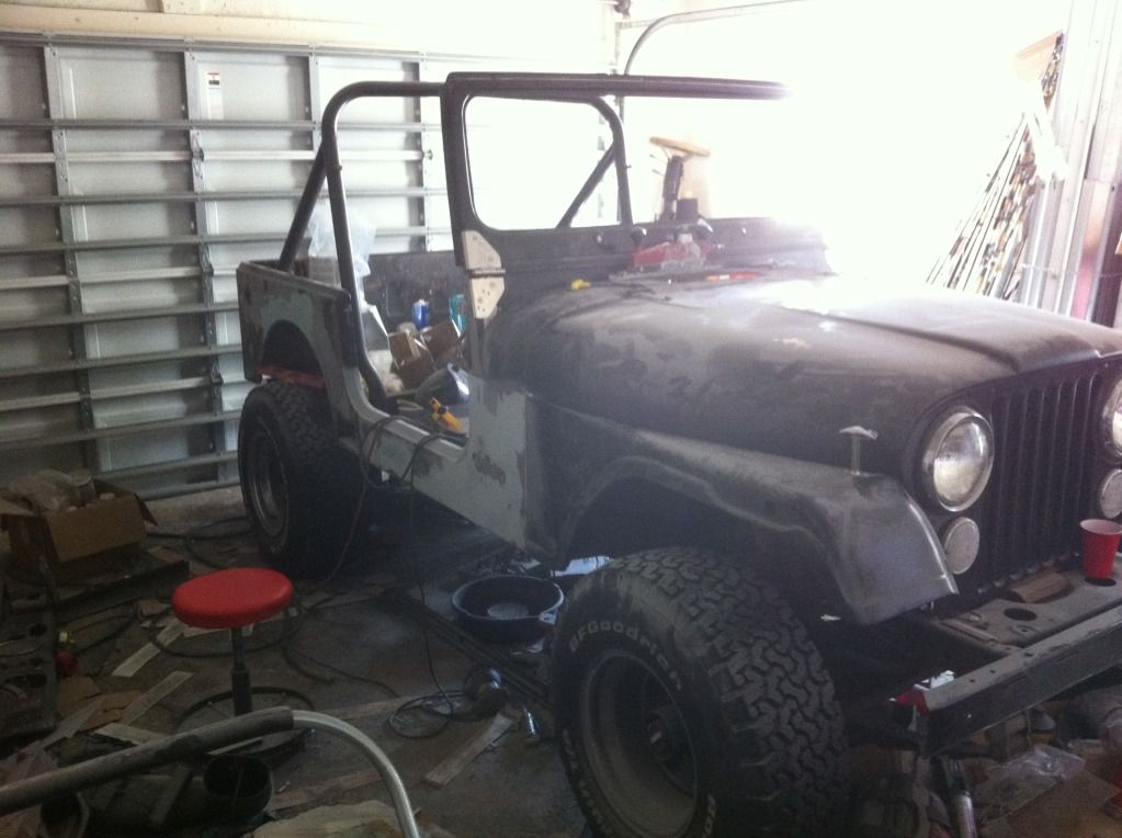

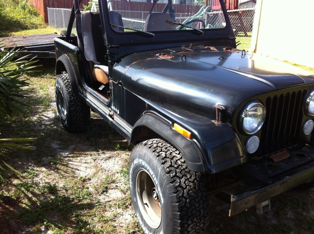

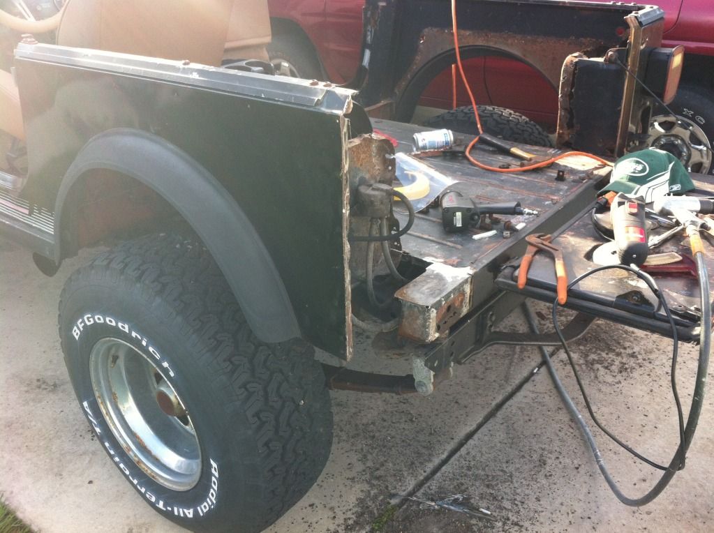

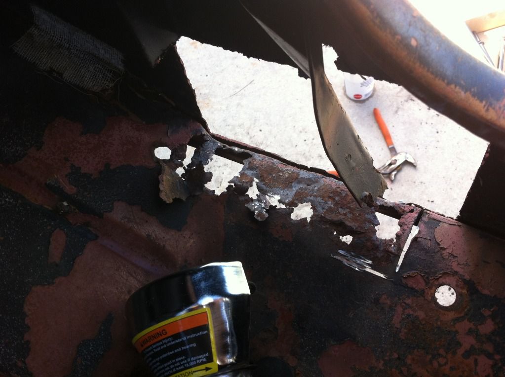

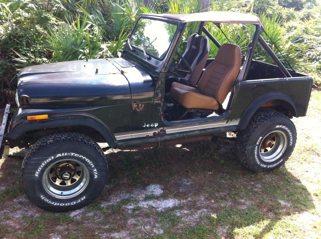

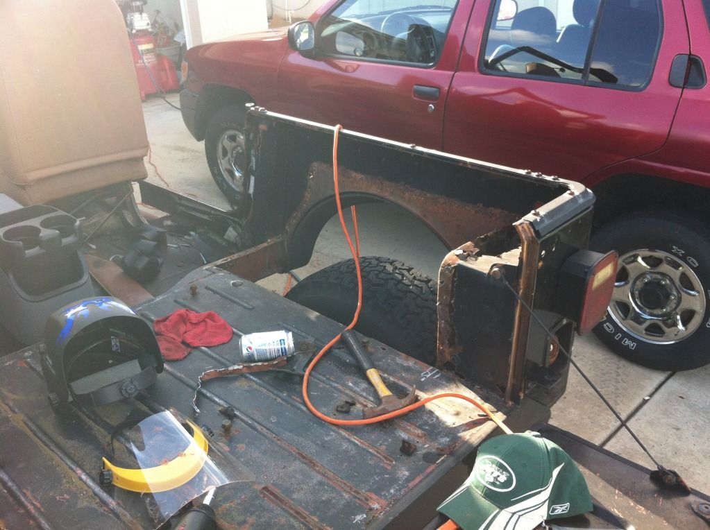

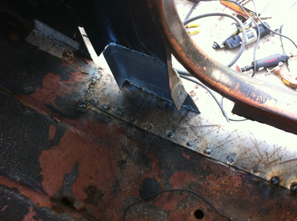

Hi All, I am relatively new to the forum although I have contributed to a few post in recent months. I must say, this is an incredible forum and I am proud to be a part of it. I am the proud new owner of an 83 CJ7. I stumbled across it on Florida Craigslist a couple of months ago and I had to have it. I paid $2500 for it and to me, it was worth every penny. It needs EVERYTHING, BUT, the frame is 100% straight and rust free, it already has a Chevy 350 conversion and SM465, it has 4 brand new BFG 32x11.50x15 all terrains and it runs and drives awesome. Safety is another issue altogether. The roll bar was ready to fly off because the rear wheel tubs were so badly rotted and it was a crap shoot whether you were going to get a face full of rotted windshield or knocked unconscious by the roll bar. Needless to say, I only drove it for a week before it came apart. It needed a complete cowl, Hood, Fenders, Both wheel tubs and supports, rear seat floor pans, bottoms of the A and B pillars to be rebuilt and a whole lot of 16 gauge sheet metal patches Here are some pics of the work in progress so far. Sorry I'm not very good at working and taking photos so the documentation is not as thorough as I would have liked. This is the first time I am trying to post pics so I hope this works.
This is the day I bought her.

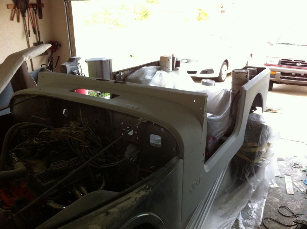

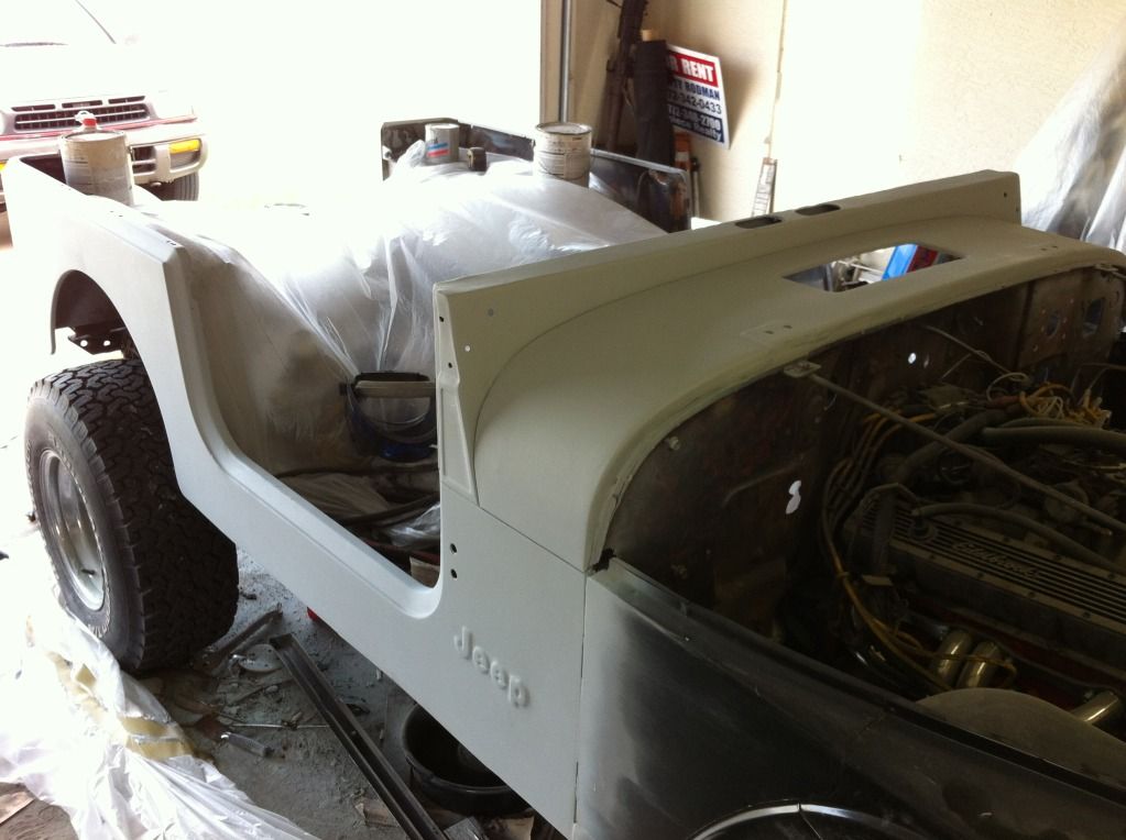

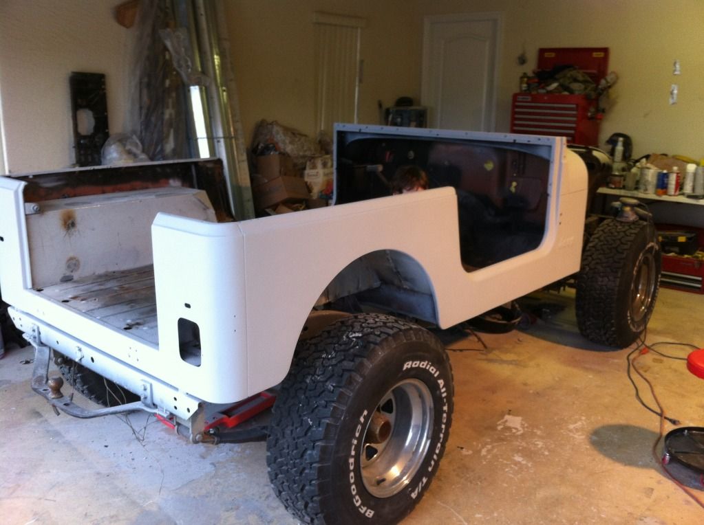

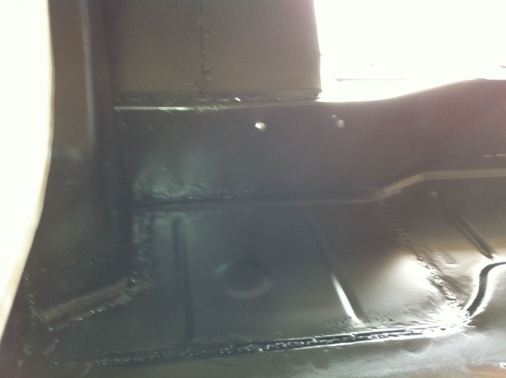

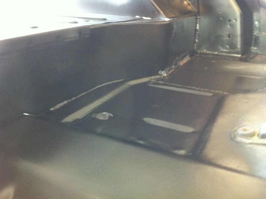

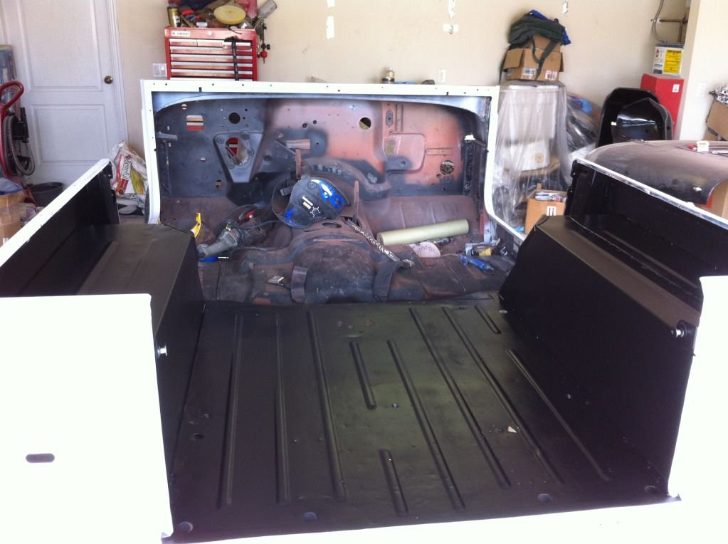

Some progress photos.
rear floor sections repaired and primed with chassis saver
New wheel tubs installed and primed with chassis saver

That tub was looking rough in the first few photos but you have it looking pretty good now. Keep it up.

Wow! I thought this might be another dreamer thread, but you are rockin this! Looks like some expert work there. Great job!

wow you do some great sheet metal work

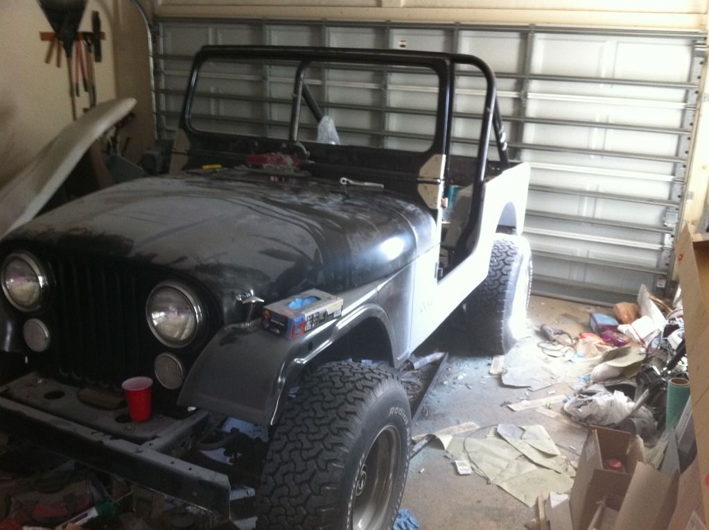

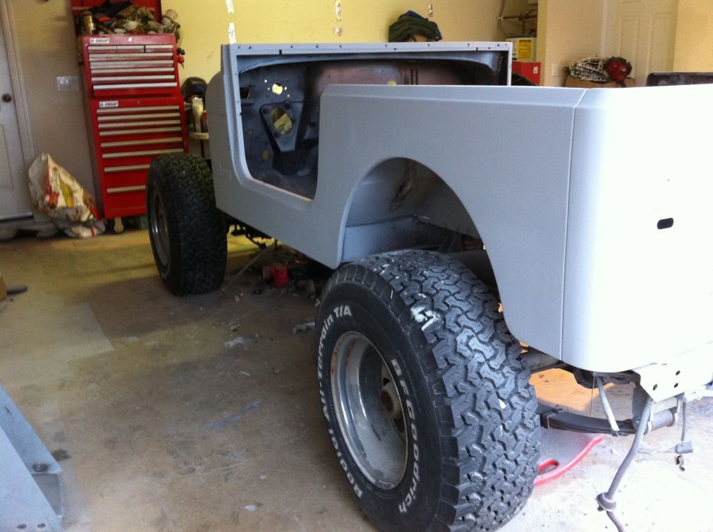

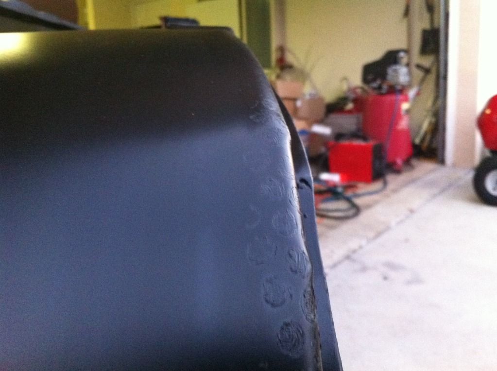

Thanks guys. I've been at it every weekend and some weekdays after work for about two months now. The wife is truly an angel about me spending every weekend with my mistress. lol Its progressing nicely. The tub is straight as an arrow now. Hours and hours of block sanding in preparation for Black paint. Black shows EVERYTHING so it has to be perfect. Next is the removal of the tub in about two weeks to start on the frame. I kept the body on the frame during the metal work to help hold its dimensions and not twist when I removed the bulk of the sheet metal. It worked, the whole body squares up nicely. I will continue to post progress photos as long as I remember to take them. Although this isn't my first jeep, it is my first jeep restoration. I'm no pro by any means, it's just a hobby. I'm having a lot of fun with it. Someone once told me "it's just metal, you can always weld it back". Translation, don't be afraid of it, just go for it and it will all come together. I tell my wife it's "Therapy". lol

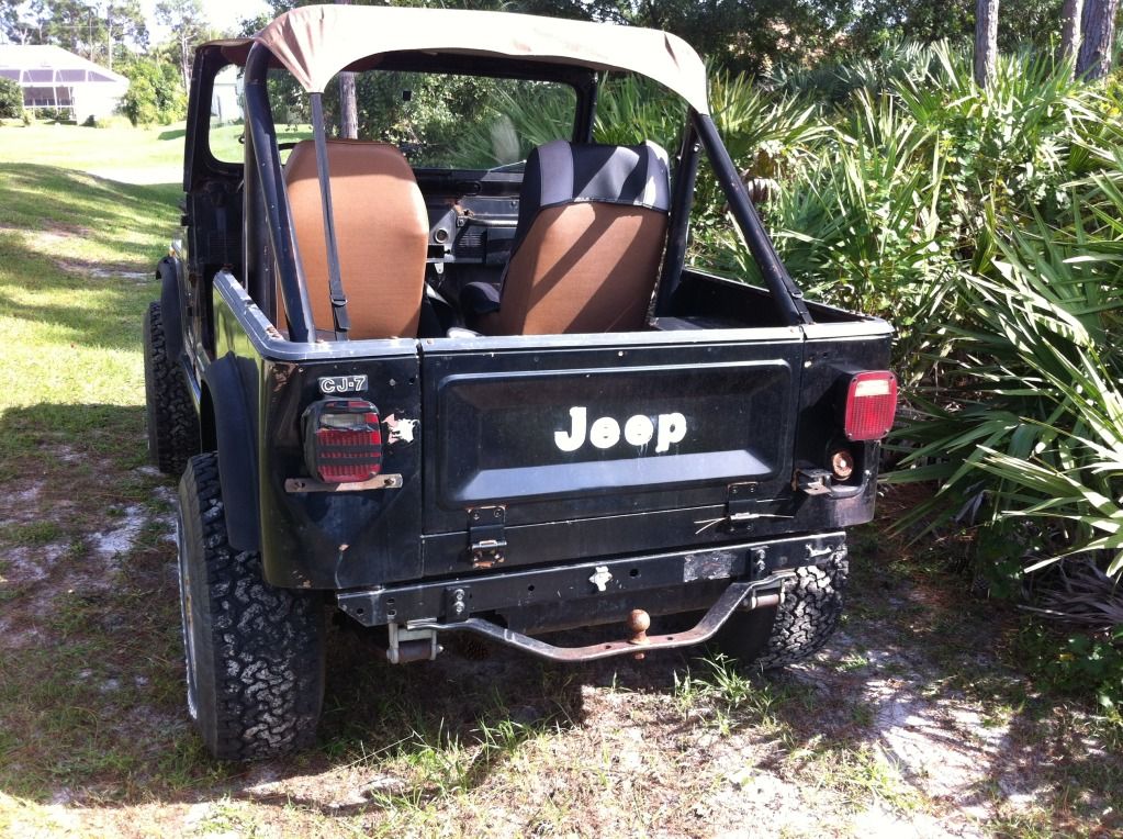

Can anyone tell from my pics how much lift I have? The shackles are Con-Ferr engineering and the tire size is 32x11.50x15. best I can measure, I have about 4 1/2 inches from the mounting pad on the spring to the spring eyes if I drew a line across from one spring eye to the other and measure down.
inovermyhead2 is offline
post #14 of 90 Old 02-08-2012, 07:20 PM
johnsom5
Location: Spring Lake
Posts: 384
Others may be better capable of telling you, but mine is a Skyjacker 4" lift, and yours is about the same height as mine by the looks of it.
johnsom5 is offline
post #15 of 90 Old 02-08-2012, 09:41 PM Thread Starter
inovermyhead2
1986 CJ7
Location: Holbrook
Posts: 523
I was thinking maybe 4" but I didn't know if maybe there was actually a way to measure. Thanks for the reply johnsom5
