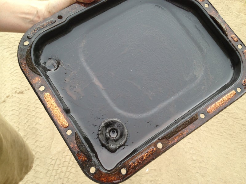

Jr working on his TF-999.
Ewe, look
<----Click
<---- Click

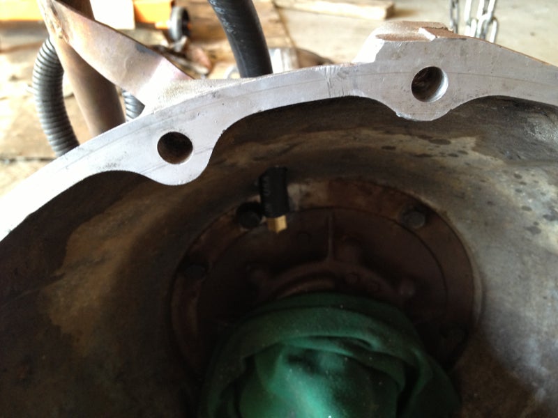

Installed a breather for the TF-999. Also put RTV on the threads etc.
Installed a 3/8"x fitting.
The fitting is a 1/8" x 3/8"

Doesn't work-T-Converter hits the 90 and it will not let it seat all the way. You can bolt it up but the T-converter won't spin.
I read a few write ups on this but .... Just wanted to let some of you know.
Jim
<----Click
<---- Click
Rollbar is offline

I'm confused. What is the purpose of drilling a hole in the front pump?
OrangeCJ-5 is offline
post #43 of 143 Old 08-27-2013, 11:27 PM Thread Starter
Rollbar
1984 CJ8
Join Date: Aug 2005
Location: Florida
Posts: 2,529
The hole is already there-breather. When and if you get that far under H20, then H20 will enter.
I just threaded/tapped the hole and it went well until the T-converter hit it. It shouldn't have but did.
So we removed it.
<----Click
<---- Click
Rollbar is offline
