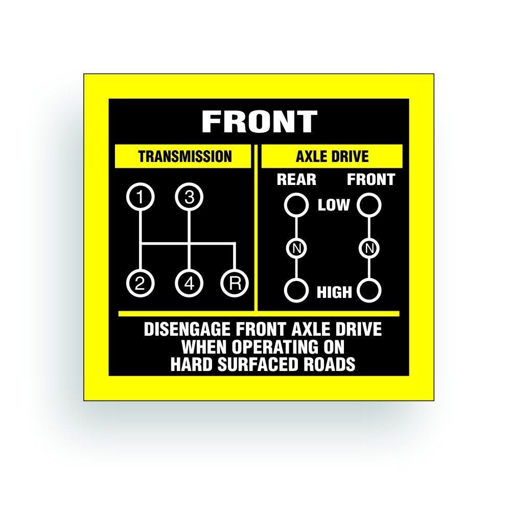

I used a JB Fab twin kit on my D20.. My shift pattern is back for high forward for low. Both sticks. Nuetral is in the middle. The throw is much shorter and more positive than the jamm-omatic stock set up..

Here's the pattern I have..
Pull my finger

Nope both sticks forward gives you 4wd low. Basically all a twin stick does is it allows you to control front and rear indidually. With 2shifters you can use 2wd low. If you break rear drive shaft you can use rear neutral and front wheel high to get you home. A Dana 300 has poppet balls and springs on the shift rails and in order to use the front only you have to modify the shift rails. Some off roaders use it for front digs. CAUTION: do not intermix selections ie front low rear high rear low front high or you'll crater your transfer case. If you don't modify your shift rail the poppets prevent this.

No, that's no what was said at all. As mentioned, both sticks forward = 4low, no mods required.
