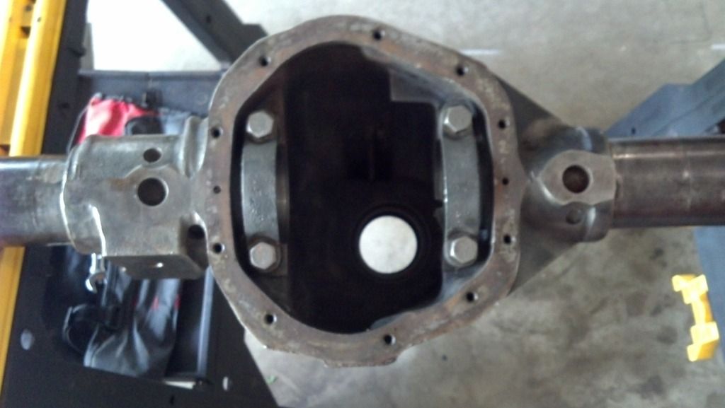

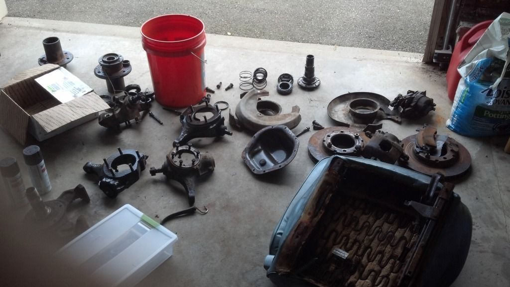

Picked up a new piece to the puzzle that is my CJ. I found a 1978 Wagoneer D44 front that has been narrowed to fit a CJ for $250 on Craigslist. The housing looks new, the PO did a great job cleaning it up. The axle came disassembled but with all its components (including new spring plates, u-bolts, and bearings). I already have a HP44 from a 1979 Bronco that was intended for the YJ that I am going to steal the outers from to use on the CJ. The Ford components seem much beefier and then I can run a 5x5.5 bolt pattern instead of the 6 (not to mention I have a tub full of brand new brakes, lock outs, etc). I also assembled the Aussie locker I had for the YJ...
The new D44...
The pile of parts it came with...

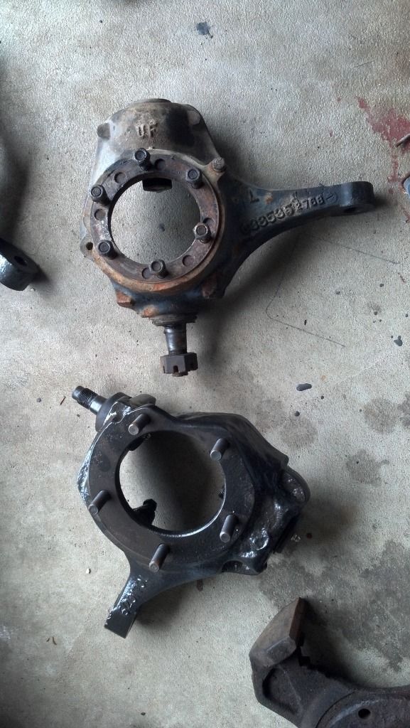

The Wagoneer knuckle vs. the Ford knuckle...
These will hopefully give me a little more stopping power than the 9" drums...
Box of D44 parts...

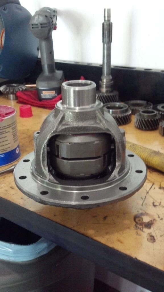

Assembled Aussie locker in new 4.10 & up carrier...

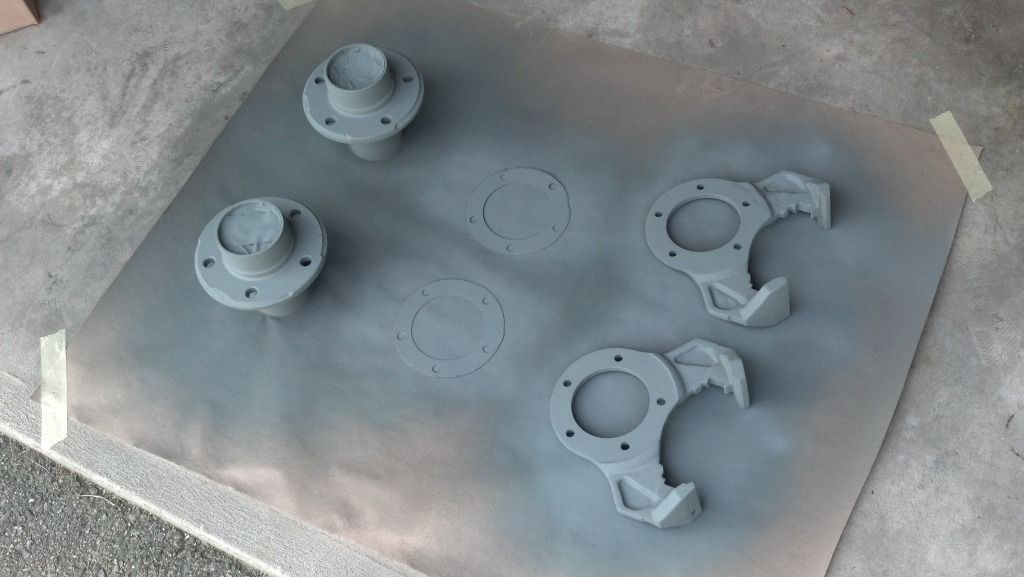

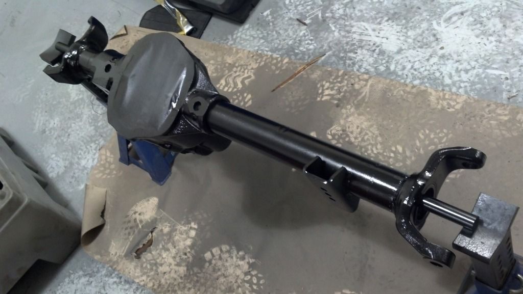

Painted the Dana 44 housing using Rustoleum Engine Enamel. Primed, based and cleared this paint lays down REALLY well...

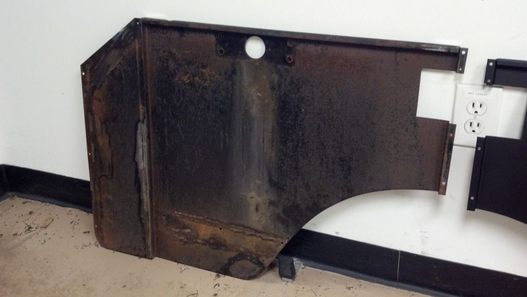

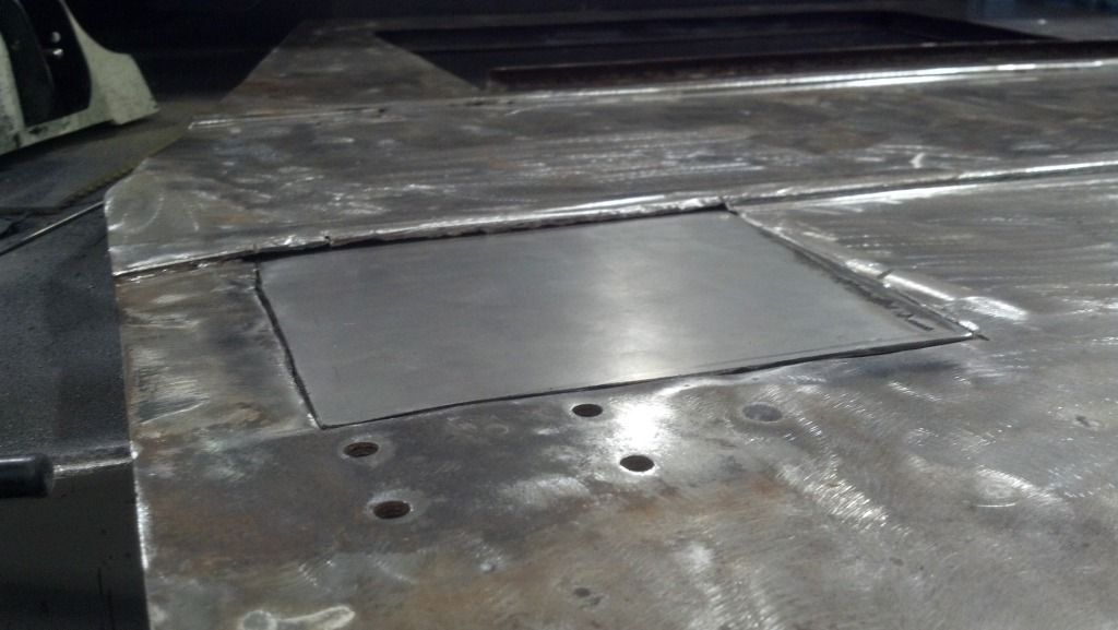

Cleaned, repaired and painted the door panels. It is amazing what a difference an angle grinder and some rattle cans make to a 50+ year old piece of sheet metal...
One of my co-workers helping me cut out some rot on the driver door...

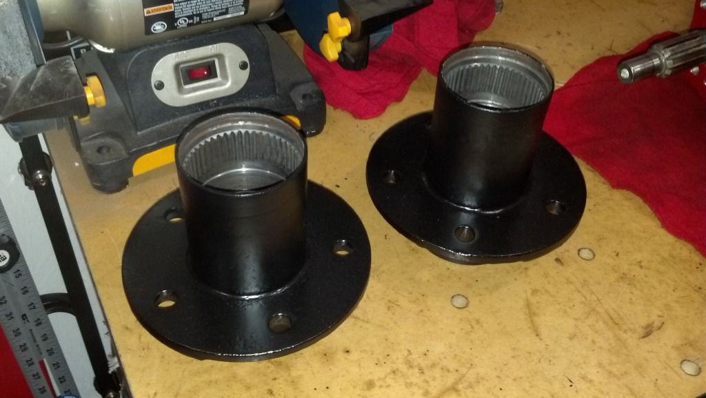

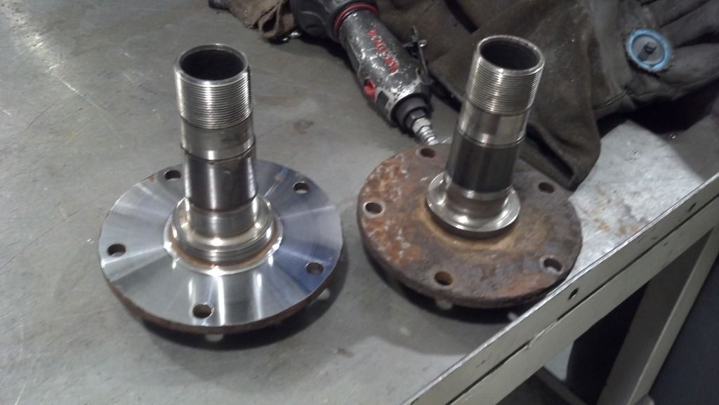

Cleaned up the Ford spindles, it is nice having a lathe around...

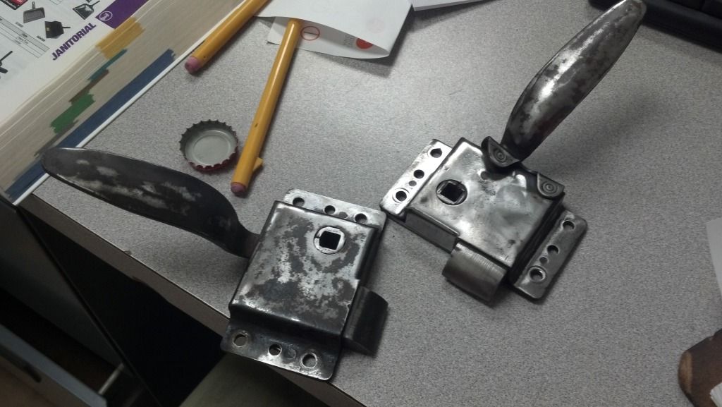

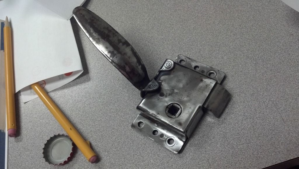

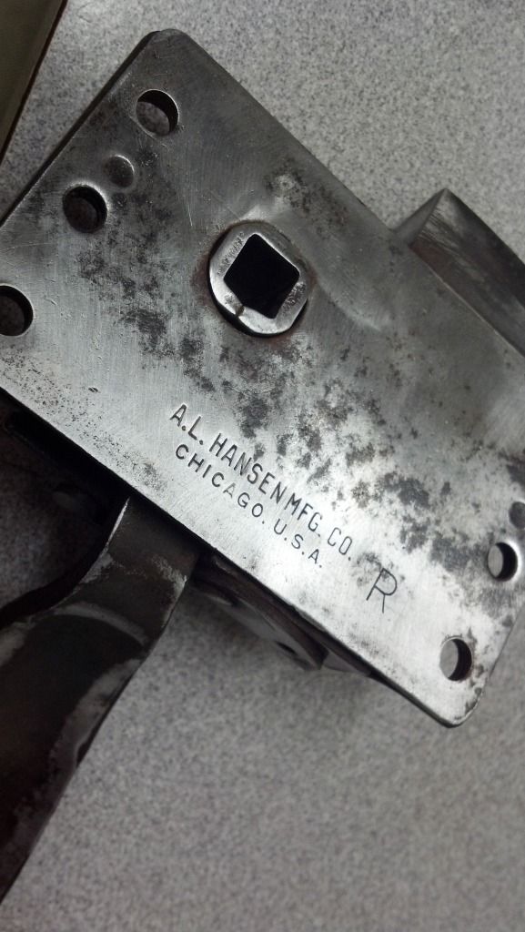

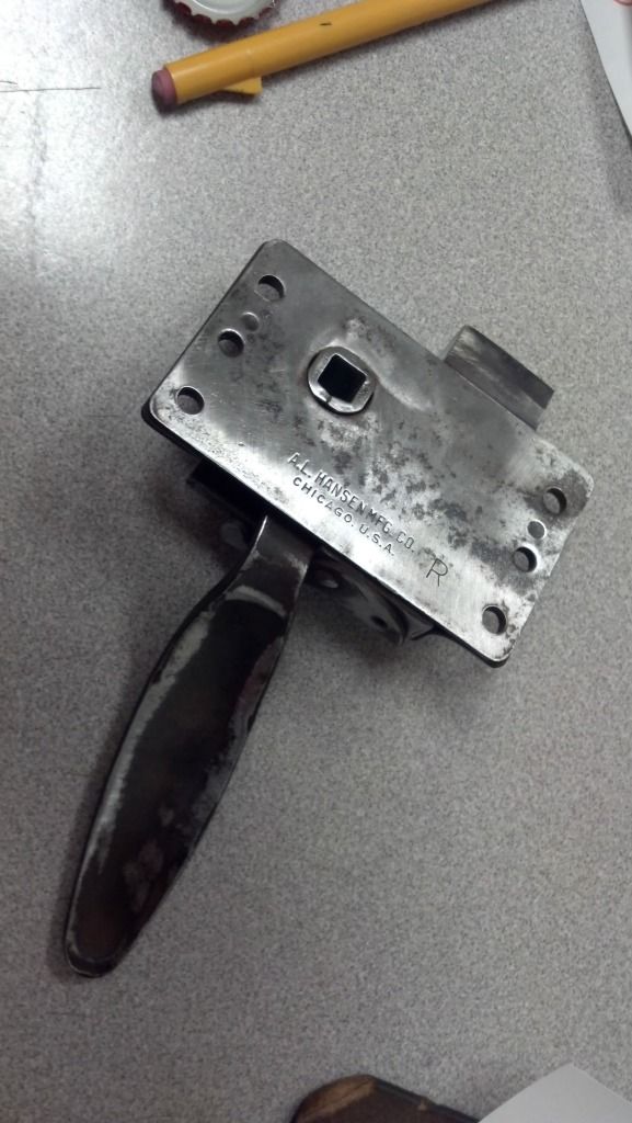

I find everything about this truck cool haha here are some pictures of the door latches...

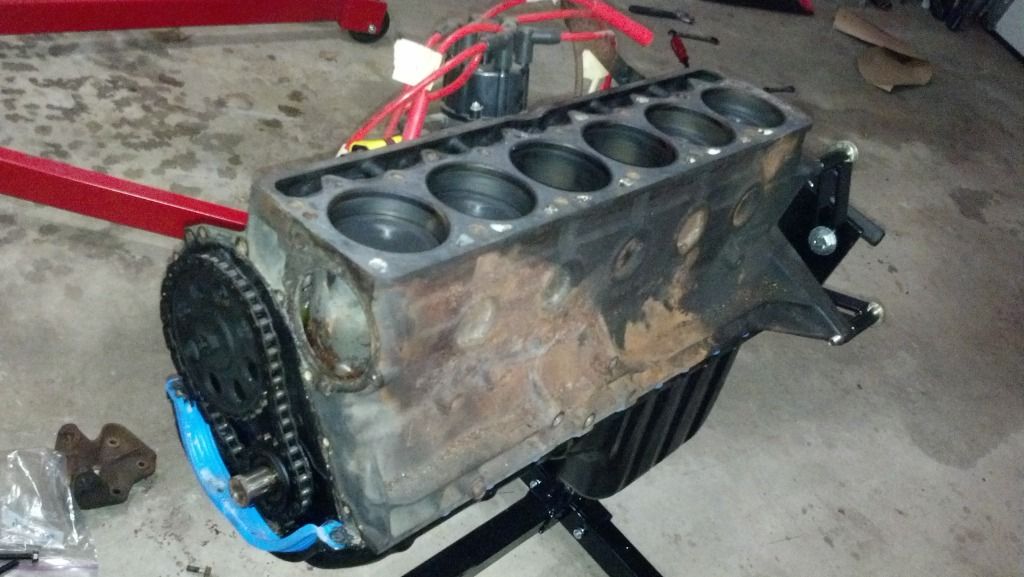

Chipped away at the drivetrain a little more this weekend.

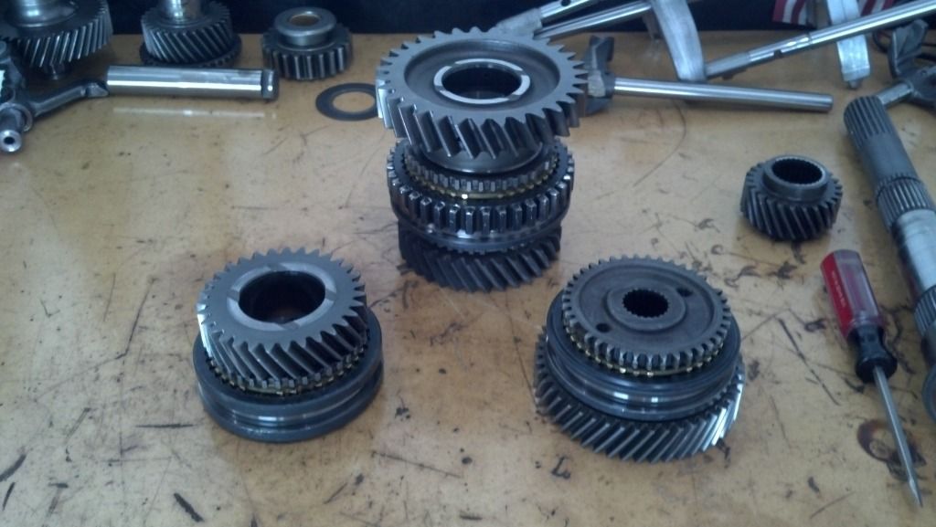

Finished up the AX15. I am use to dealing with automatics, this thing was a piece of cake...

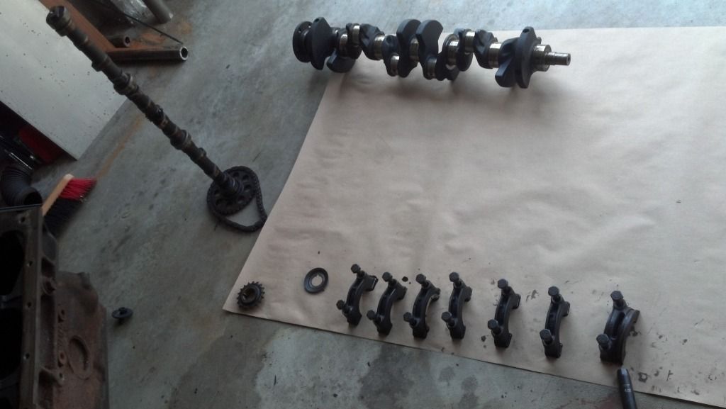

Got the 4.0L mostly torn down, everything looks good so far...

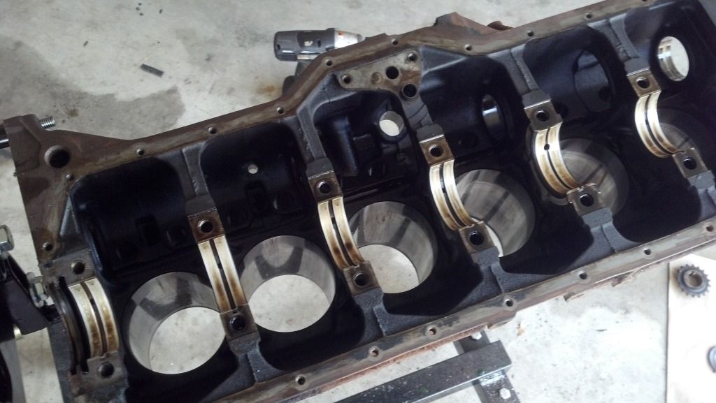

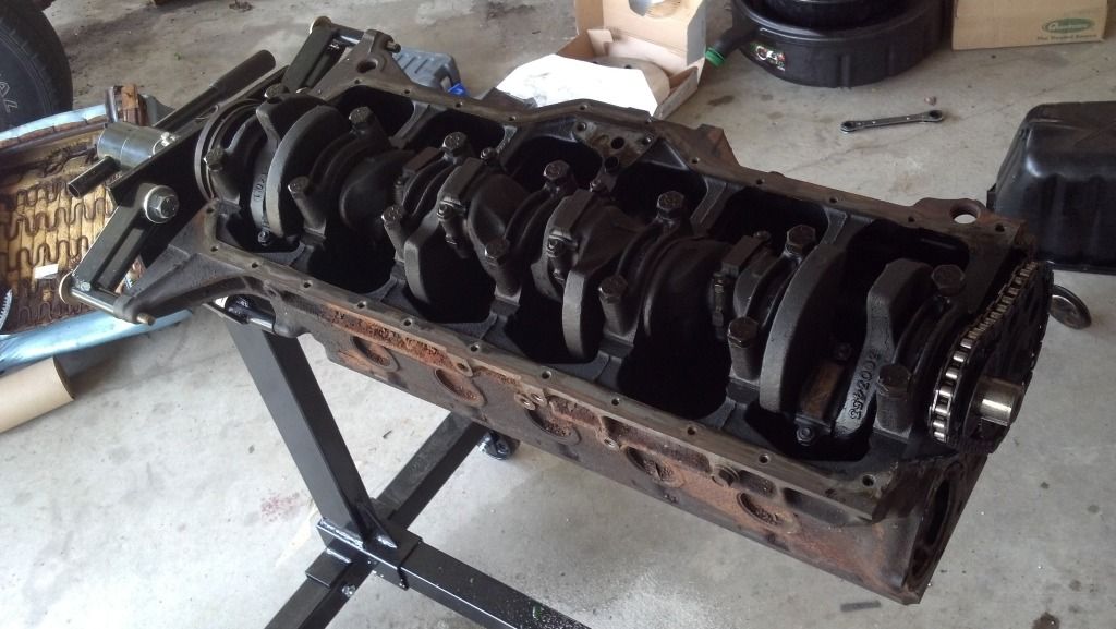

First off I finished dismantling the 4.0L. The block and internals are in good shape so I am ordering new bearings and rings to bolt it back together

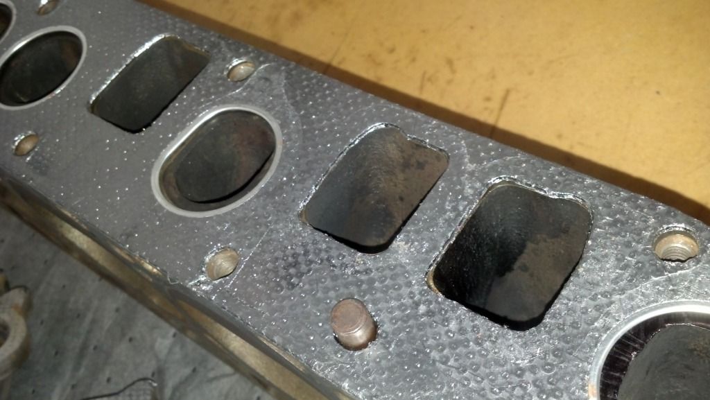

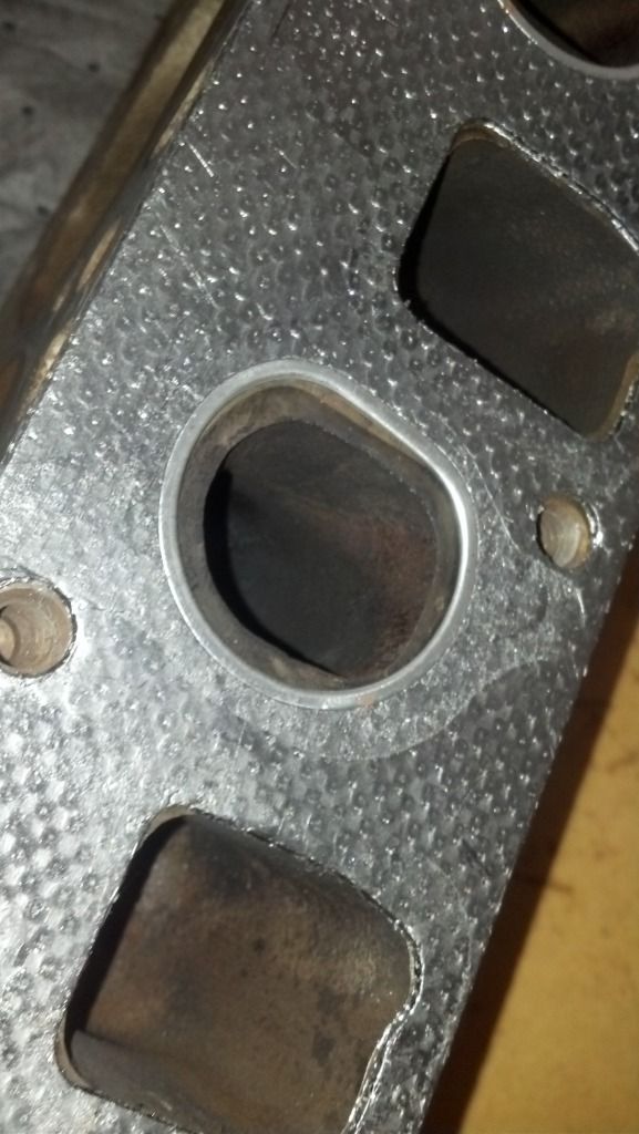

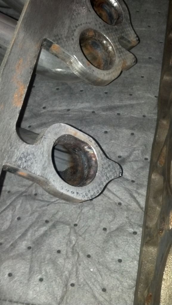

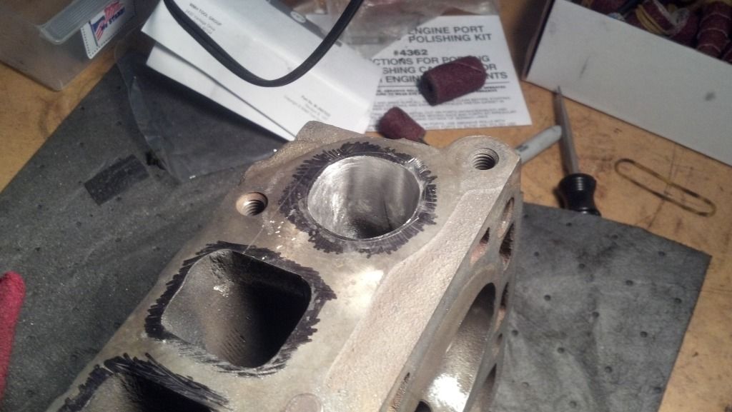

I disassembled the head and cleaned it out. I am running an aftermarket header so I decided to gasket match and polish the exhaust ports (the intake ports are nearly matched from the factory).

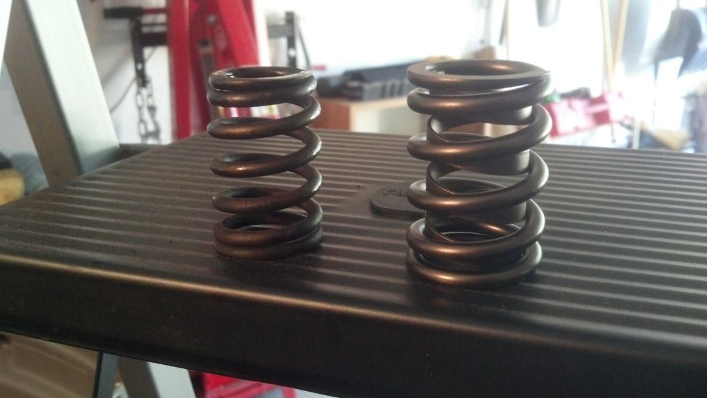

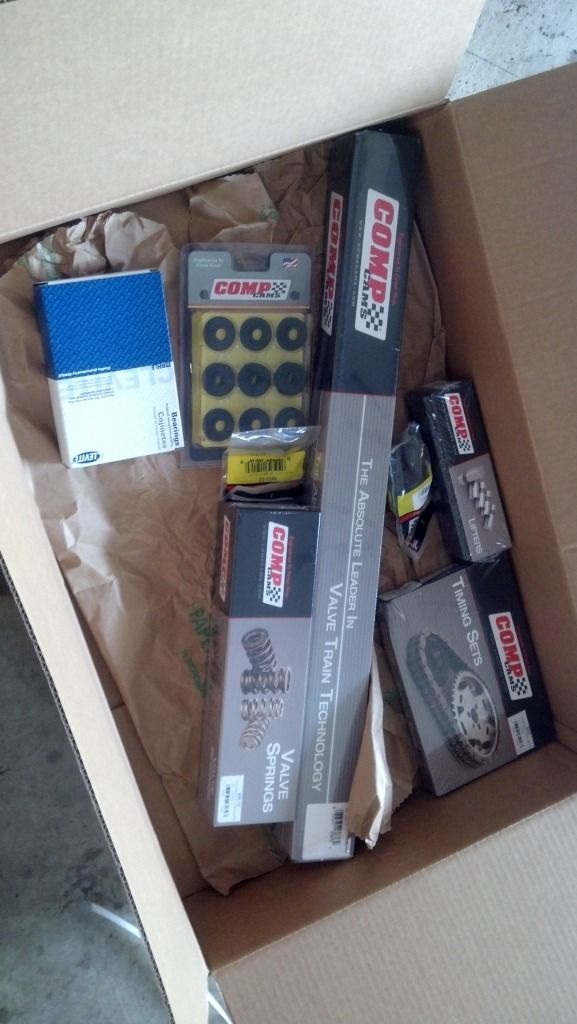

I order a special treat for the ol' 242... Comp Cam kit to give the motor a more potent low end...

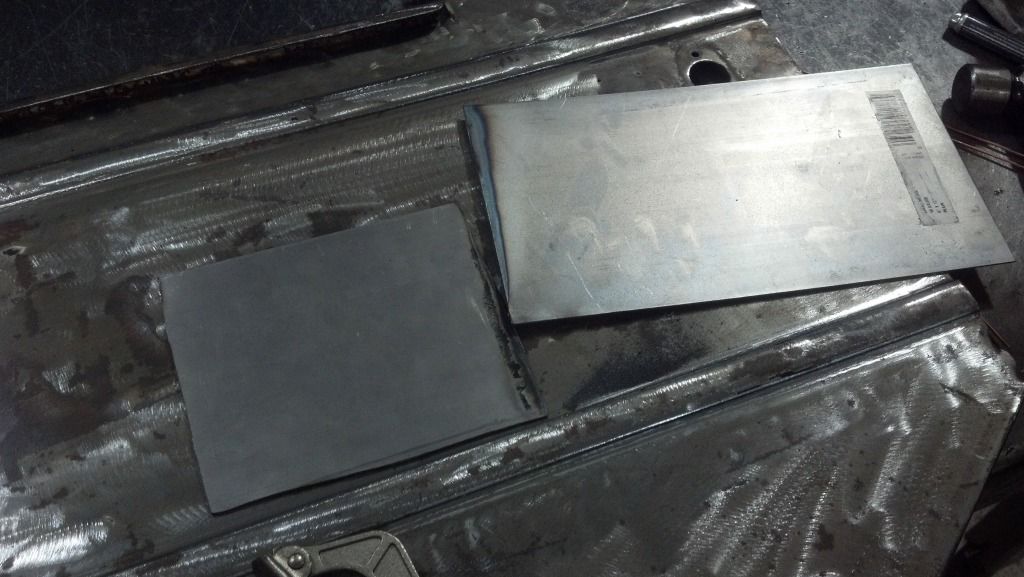

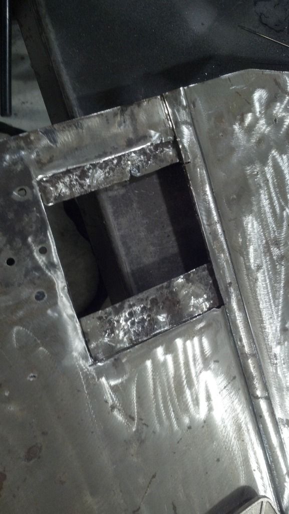

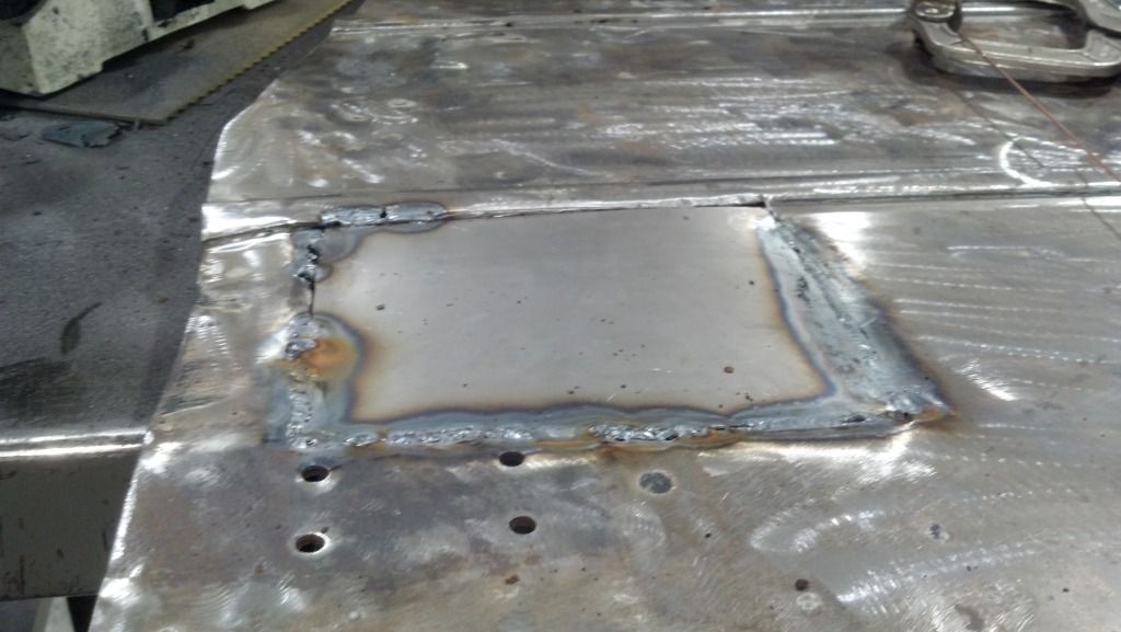

I am in the process of patching up a rust hole in the driver door... It needs some more work haha...

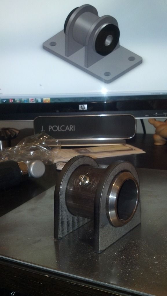

I am also working on building new poly trans and motor mounts...

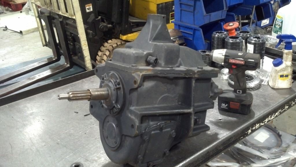

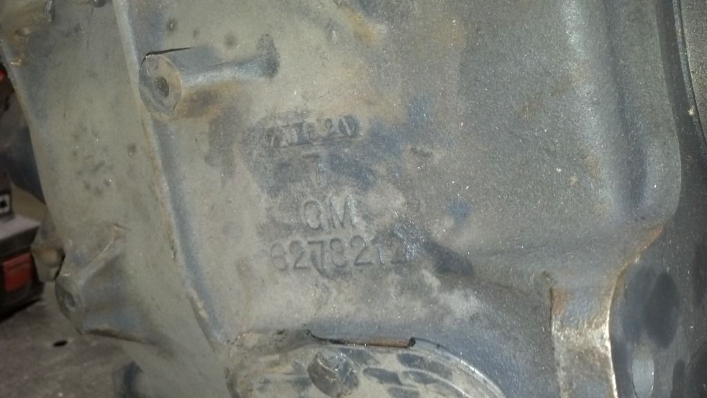

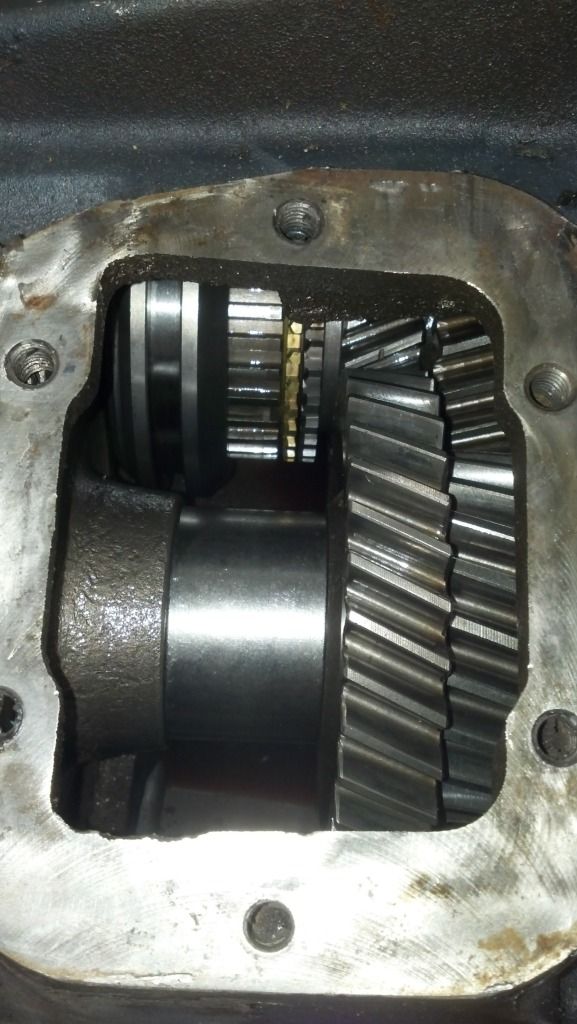

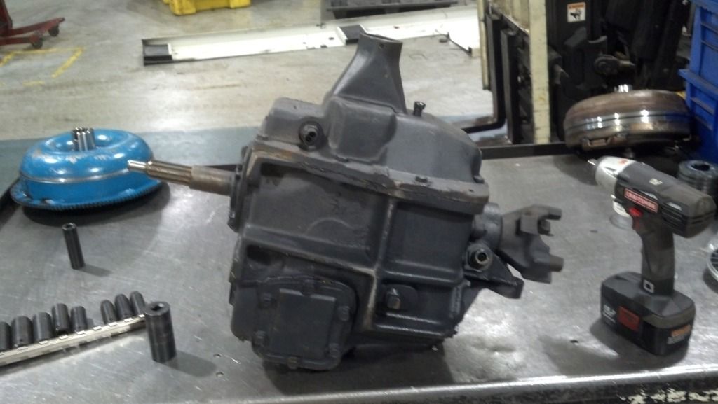

Finally, I made a good find at work today (I work for a transmission re-manufacturer). We received a manual transmission core last week that the company was originally going to scrap (we only deal with automatics). The PTO covers and massive yoke caught my attention so I decided to go ahead and ID it. It turns out what I came across is a late model SM465. The boss said I could keep it so I threw it in the Ram and headed home. So far I have only popped off the PTO covers but the trans is dry and the only visible synchro appears to be brand new. I am thinking this unit has been rebuilt but never run (the paint on the yoke is still fresh). I am going to open it up tomorrow to inspect it further...
